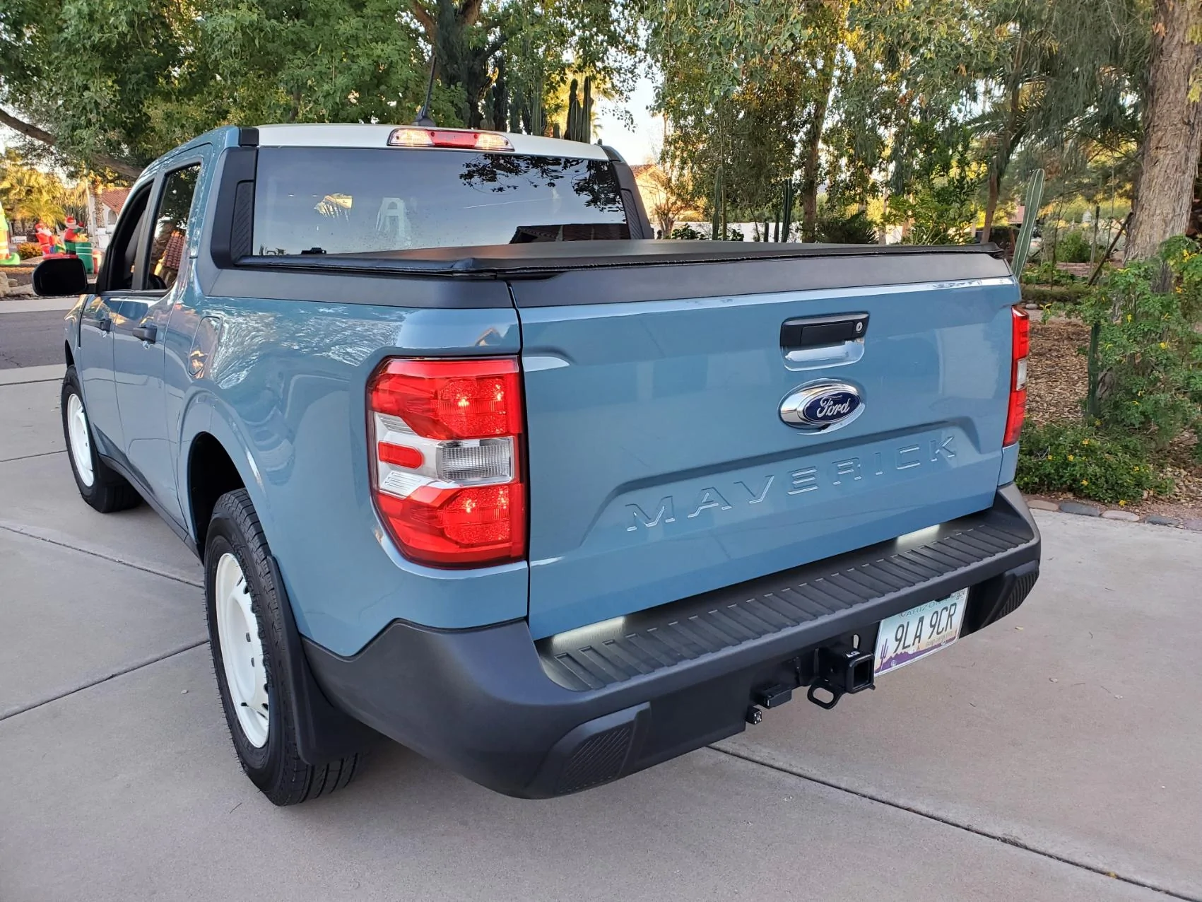

Let's play "spot the camera" in this shot:
Ford Maverick Headliner, antenna, dome light removal 01 Truck

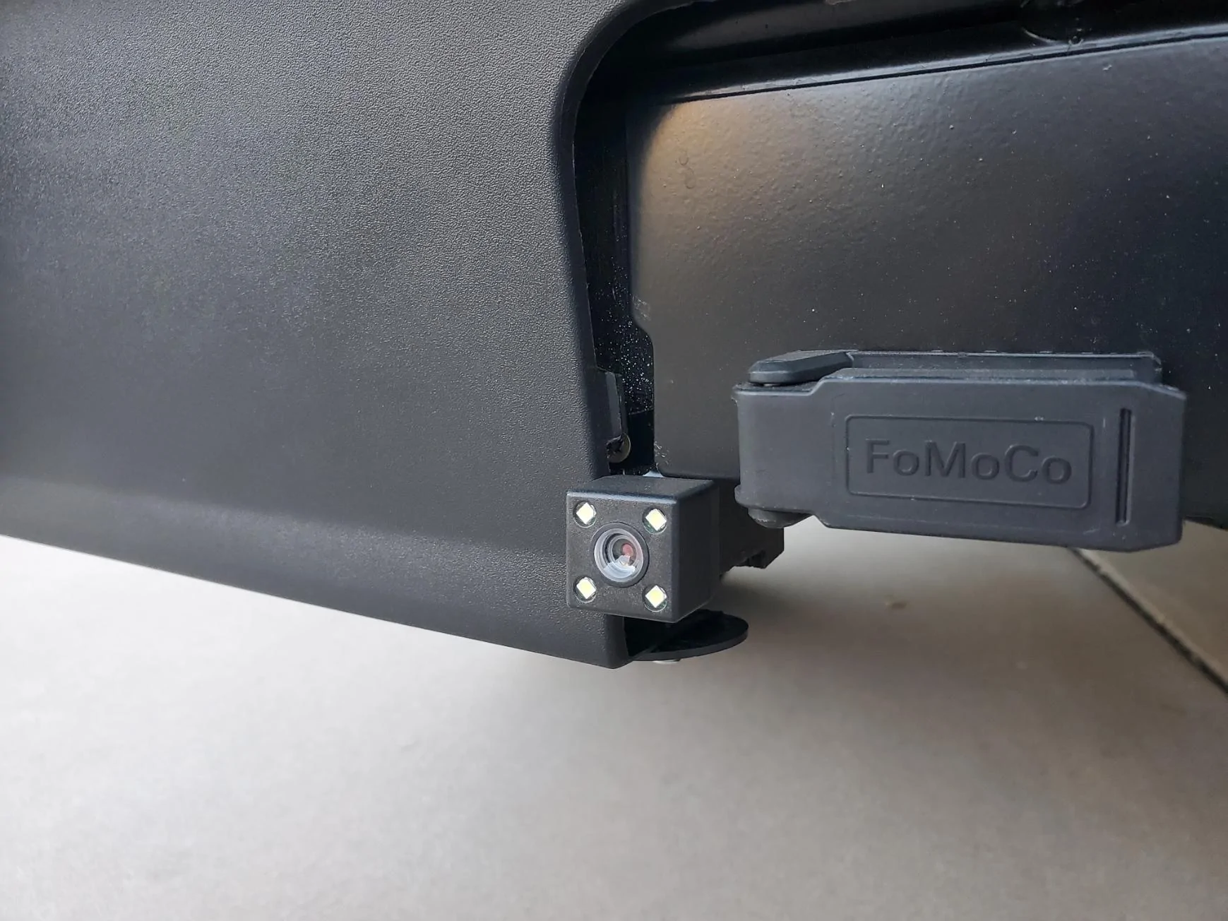

And a bit closer:
Ford Maverick Headliner, antenna, dome light removal 02 Truck

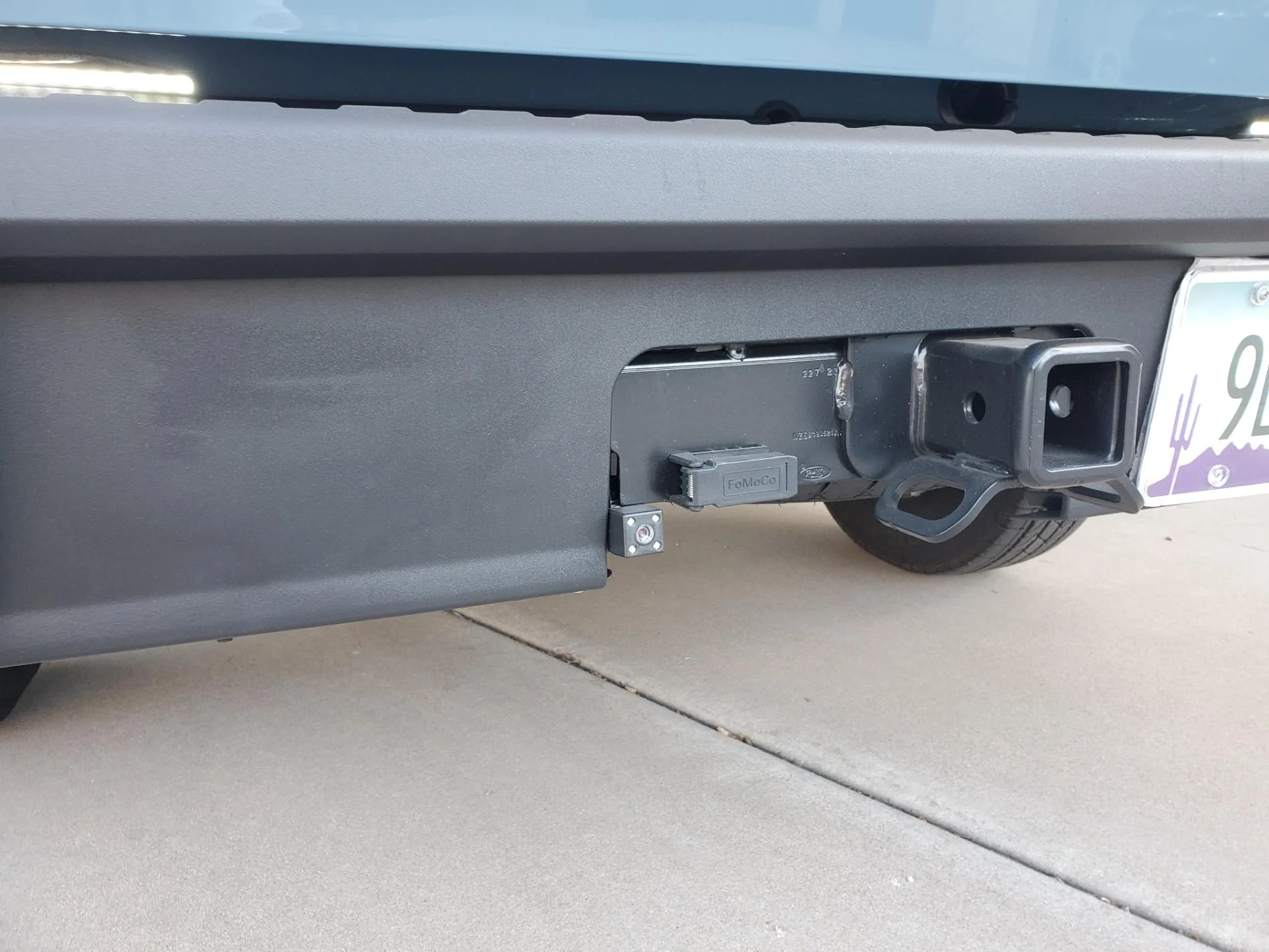

There is a small bracket under that lip, and I screwed a 3"-long piece of wood to it. The wood is spray-painted black, and the bracket for the camera is screwed into the wood.
Not sophisticated in terms of a mount, but my wife has been driving it daily for three weeks, and no complaints or problems so far.
