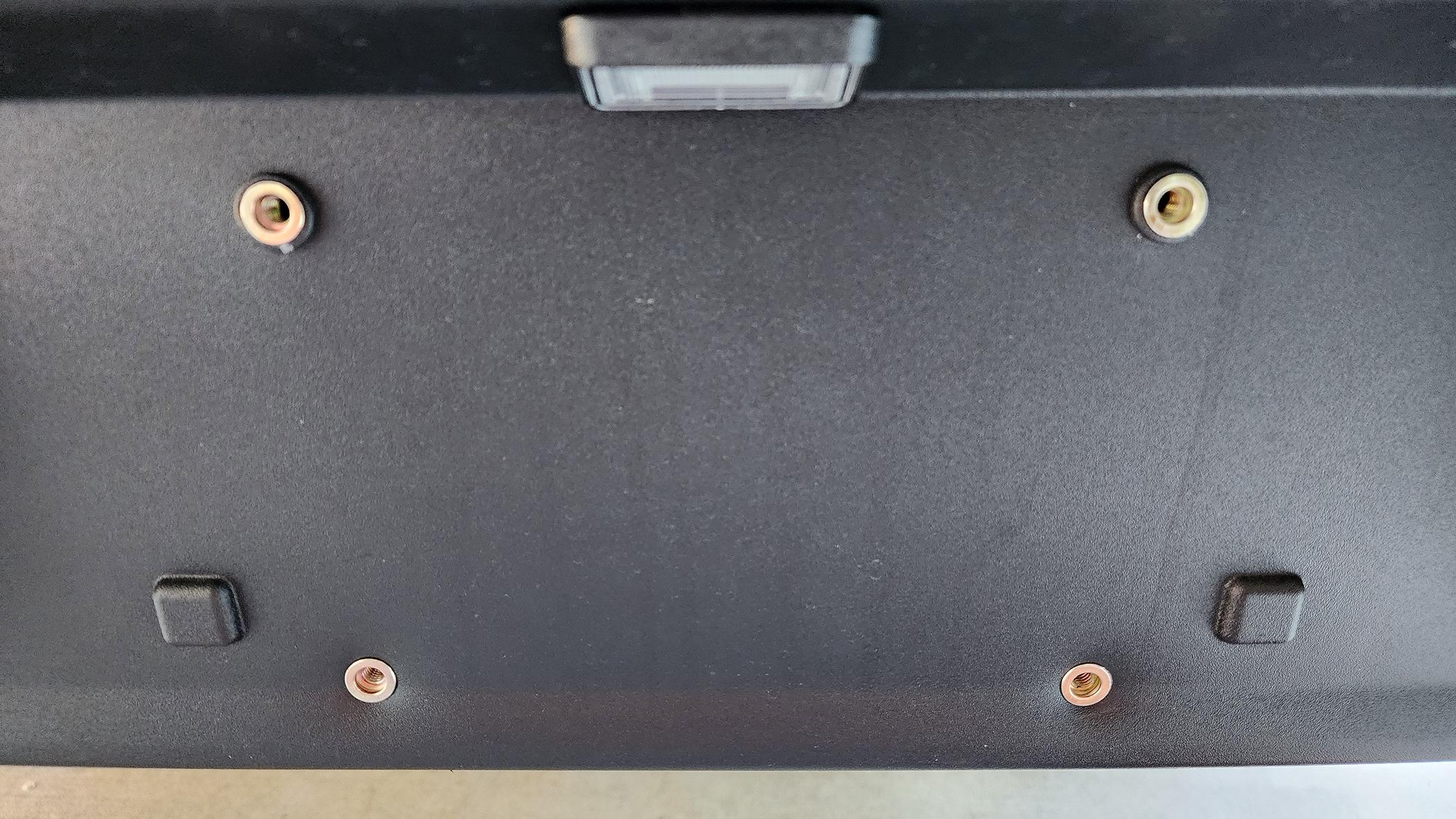

Just installed plates on my 24 Tremor today using rivnuts. Did not care for screws directly in plastic so mounted rear plate with 4 rivnuts (rather than just 2 screws) and it worked perfectly. This was my first time working with rivnuts but was pretty easy to pick up.

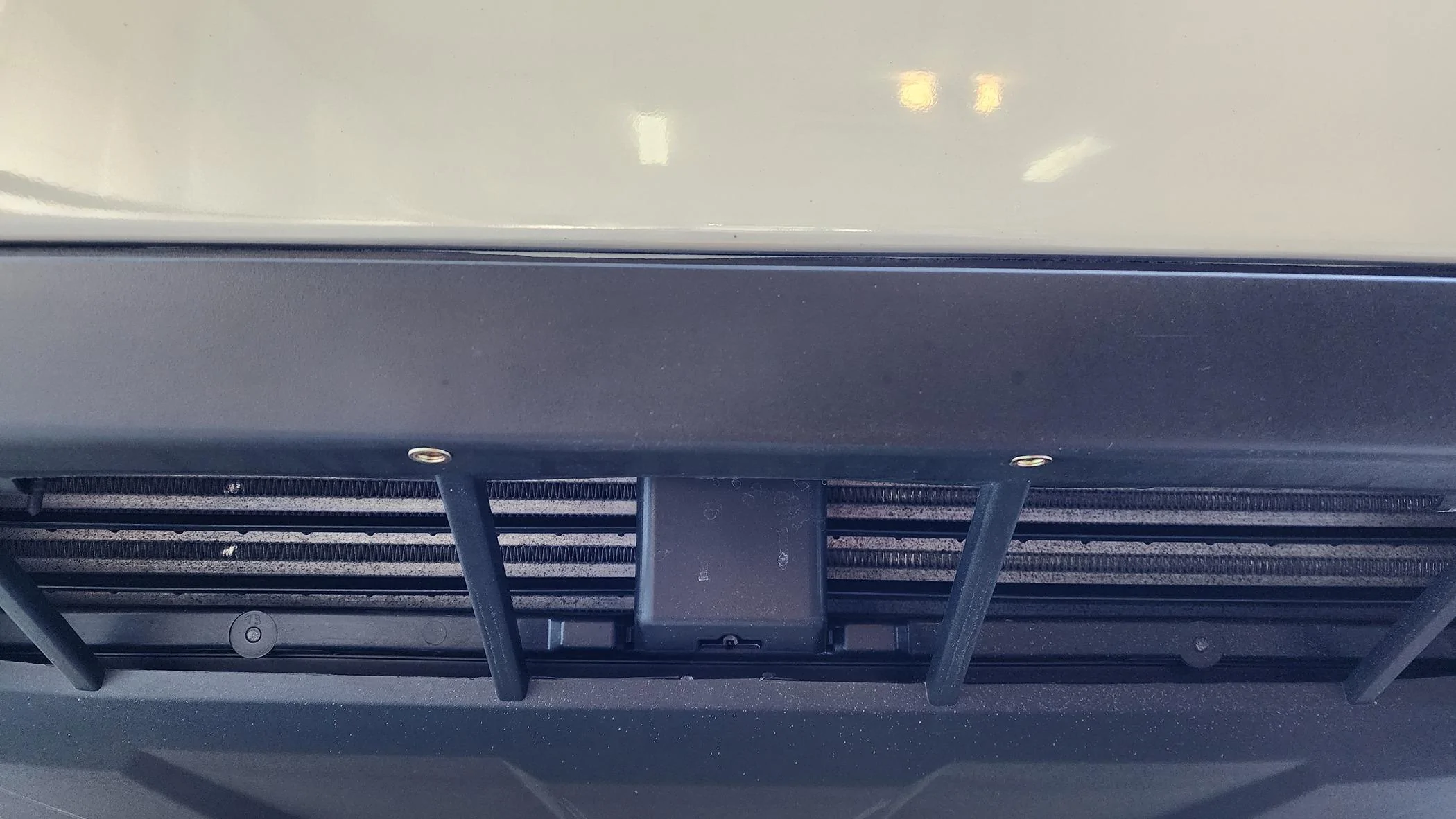

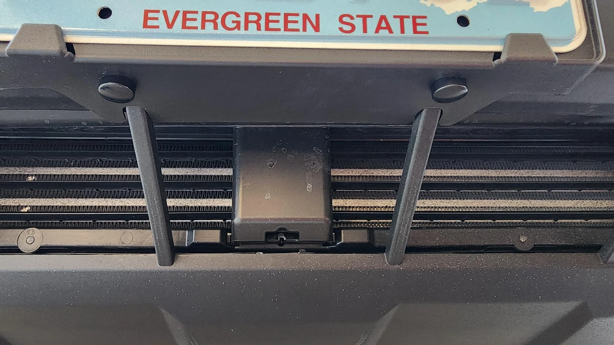

For the front bracket I did a "no drill" install by adding 2 rivnuts below the bumper (which angles back on the Tremor). All that you see when the bracket is off is a couple of inconspicuous nuts under the bumper - no drilling of the visible surface at all.

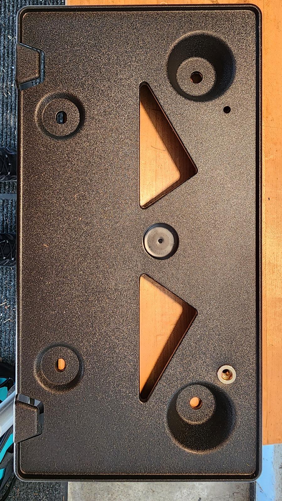

For good measure I also mounted the plate to the bracket with rivnuts (first of 2 shown below for "before and after"):

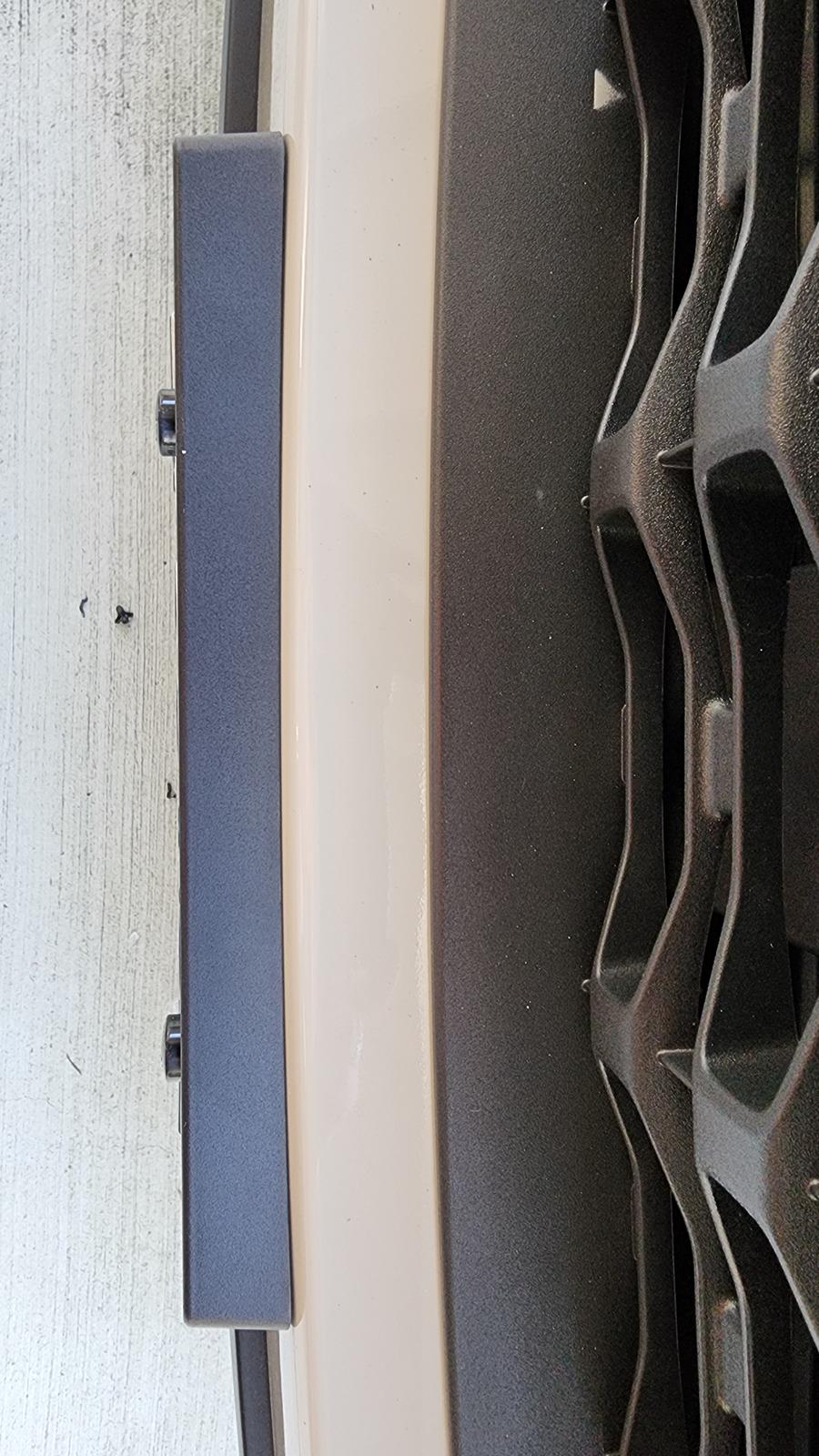

I should have taken a picture of mine after I put it in, but I didn't have a rivet puller so I just used a set of three Phillips head bolts that I had lying around from some furniture assembly or something. they caught just fine on the plastic going into some slightly smaller pilot holes, so I don't think it's going to need anything on the back.
