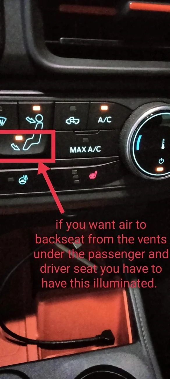

2022 1st edition Lariat and I too have venting under each front seat but when I activate my AC nothing comes out. Mobile Ford tech coming out this morning for 2nd recall so I will be asking about this..
Do you have the FOOT vent activated as shown in my picture??

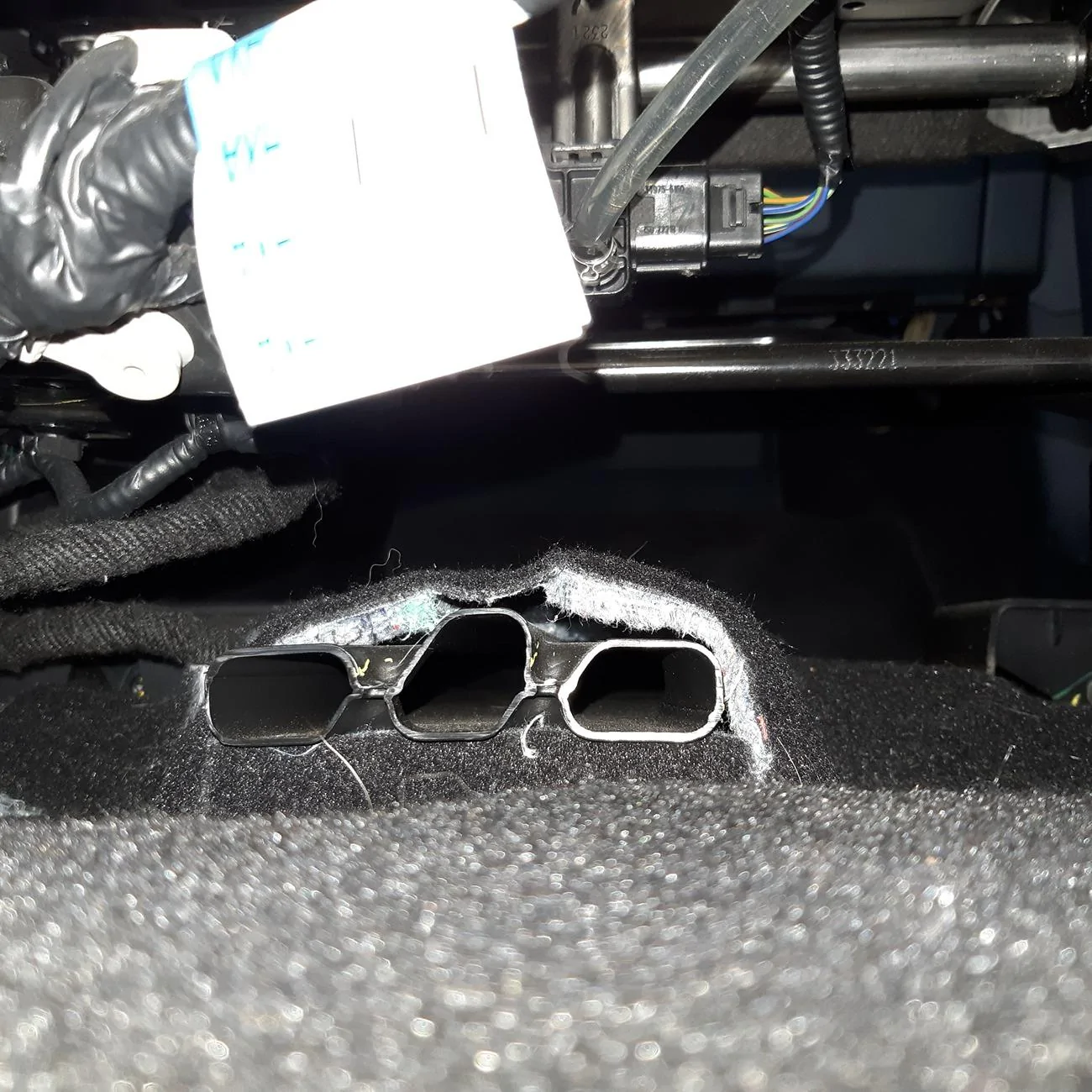

I'm just curious if anyone has extended the venting system to the back of the cab or to under the front seats for seat coolers.
Why? There's already vents under the front seats.

I think a lot of folks are confused, that even though they have AC on, if they want air through to the back seat. They have to absolutely positively have the FOOT VENT ALSO ON and illuminated. As in my picture below.
Hey Glenn. Good call Thanks. So this is what I found. If I activate Max Air, that turns off the light on the foot. Then I activate the foot and the blower stays blowing hard but Max Air indicator light goes off. Also when both head and foot are activated there is very little air coming out of the under seat vents but when I deactivate the head or top vents then there is air coming thru the under seat vents so it seems this would be better for heating. But there is more than enough air circulating throughout the cab so I'm good

Oh I agree. The pictures and the video were just to prove positive, that there are vents already in place in the Maverick. In the right configuration they will provide some cool air underneath the driver and passenger seats to the rear seats.

Apparently you really feel it working back there if you press the foot icon on the climate controls.
Unfortunately, I have been deprived of ever getting a chance to sit back there while AC/Heat is running.
I do, however, have experience of using the "foot icon" to give my feet a warm-up or cool down as needed. Works well.
