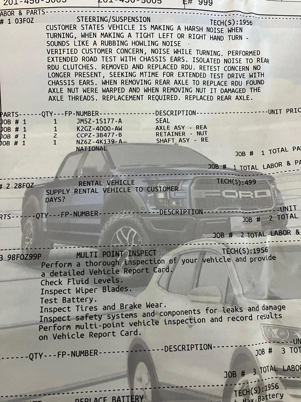

Thanks for sharing. Just based on the notes, looks like you have a great service department!
They are very detailed orientated ,and have master tech,s . Bozard Ford Saint Augustine Florida. Two issues with them ,they are very busy and not cheap.But sales is great and service is fantastic,sometimes I have to wait for an appt a few weeks ,but they always give me a loaner ...this RDU replacement took 6 days ,2 days to get the part ,then when they did axle threads where screwed up soo a new axle had to be ordered
