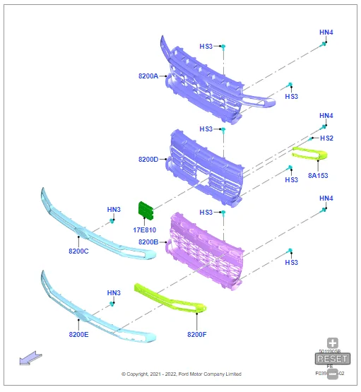

Looks great! Now that you have experience with this project, do you think you could have removed the center piece by popping the clips only without unbolting the shroud?
No, the bar has 7-9 screws holding it in place across the back interior of the shroud, you have to pull that off and pull those screws before you can unclip the bar. On XLT at least

From Top to Bottom:
XL
Lariat
XLT
I stand (sit?) corrected. Crazy that Ford would spend the $$ to tool three different versions. Thought they were pinching every penny!

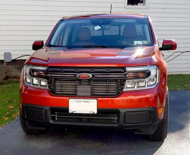

I'm thinking of removing my Lariat grille bar and plasti-dipping it black. I don't want to spend the bucks for a body color paint job, but I think I'd prefer black to silver.
I did that on mine recently. Wasn't too terrible masking it on the truck by popping the grille forwards off of the headlight clips. DYC Piano Black Hyperdip for the grille, Vvivid Hex Light Smoke on the turn signals, and Rustoleum trans tint spray to stealth the grille lights.

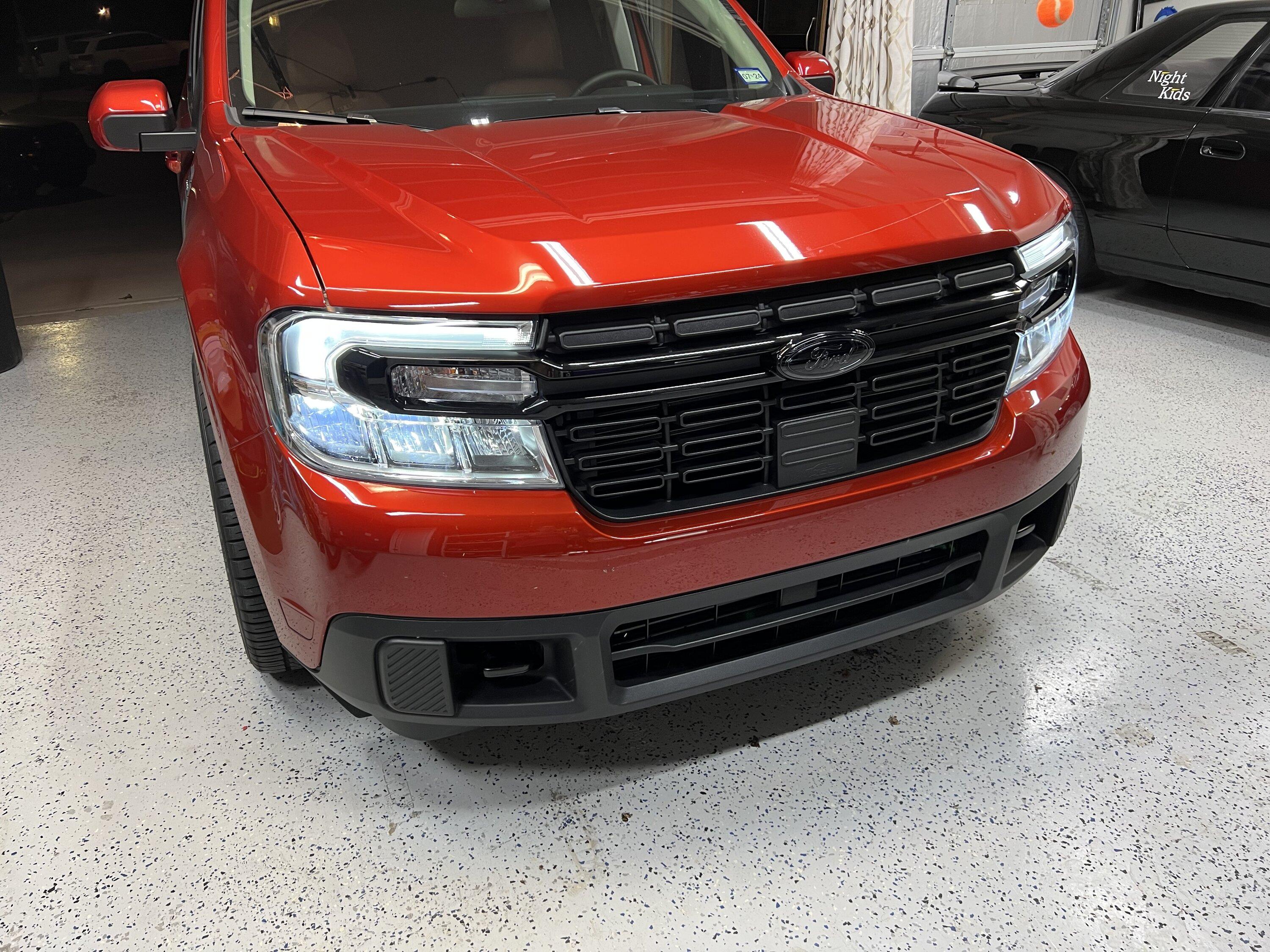

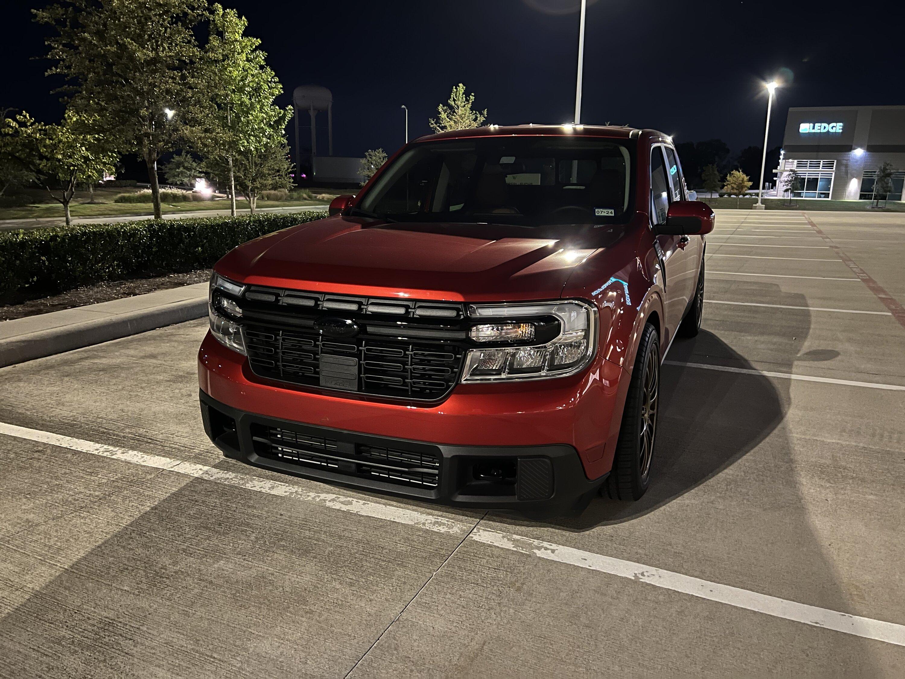

I personally like the look without the grill bar. :)
Been driving mine without it on for the last 1k miles, actually prefer the look, if unfinished, but had meant to body match it lmao
