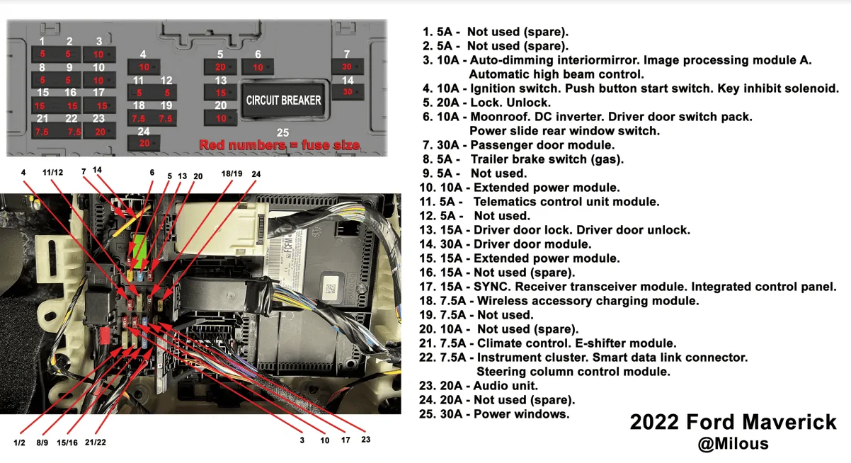

Upposedly removing fuse #11 from the panel will cut power to the telemetry control module and nothing else. I've not done it my self but it seems like an easy thing to test. If it doesn't work you just put the fuse back in.
Here is a diagram layout I found done by a member here.
Ford Maverick Gotta ask Question to dump ford Pass fuse panel layout
