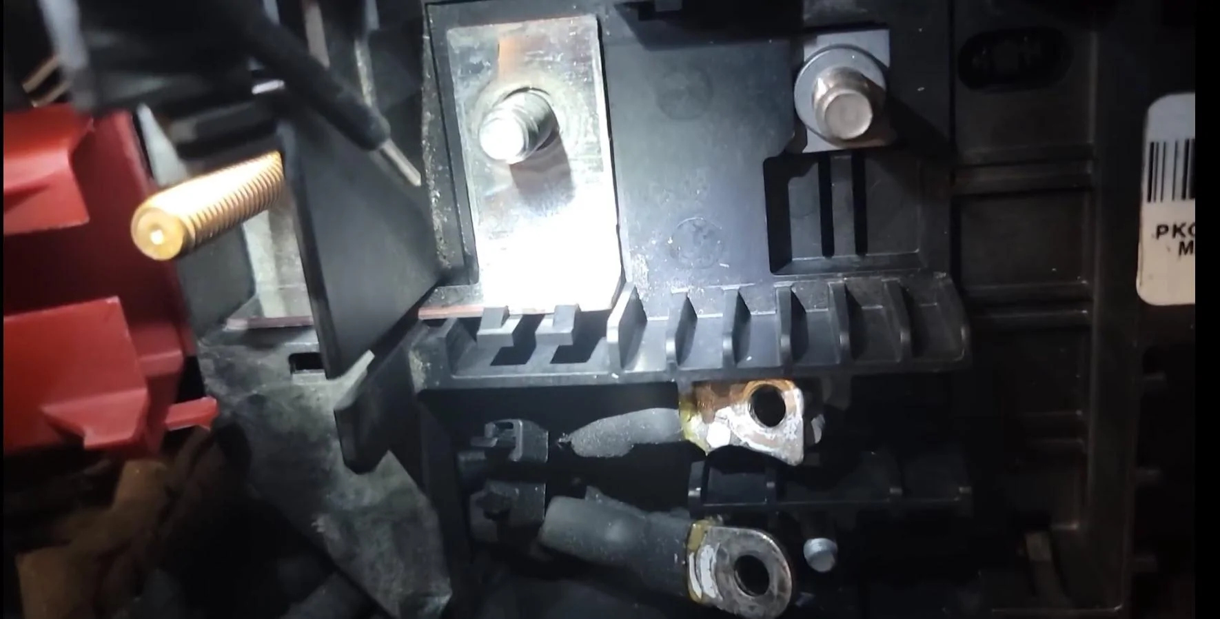

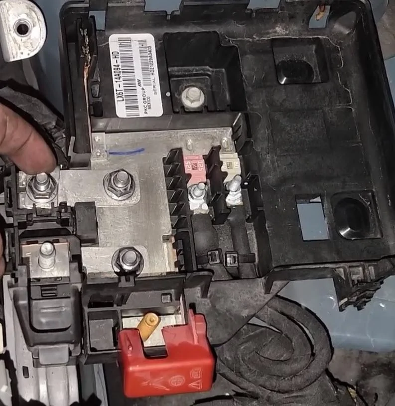

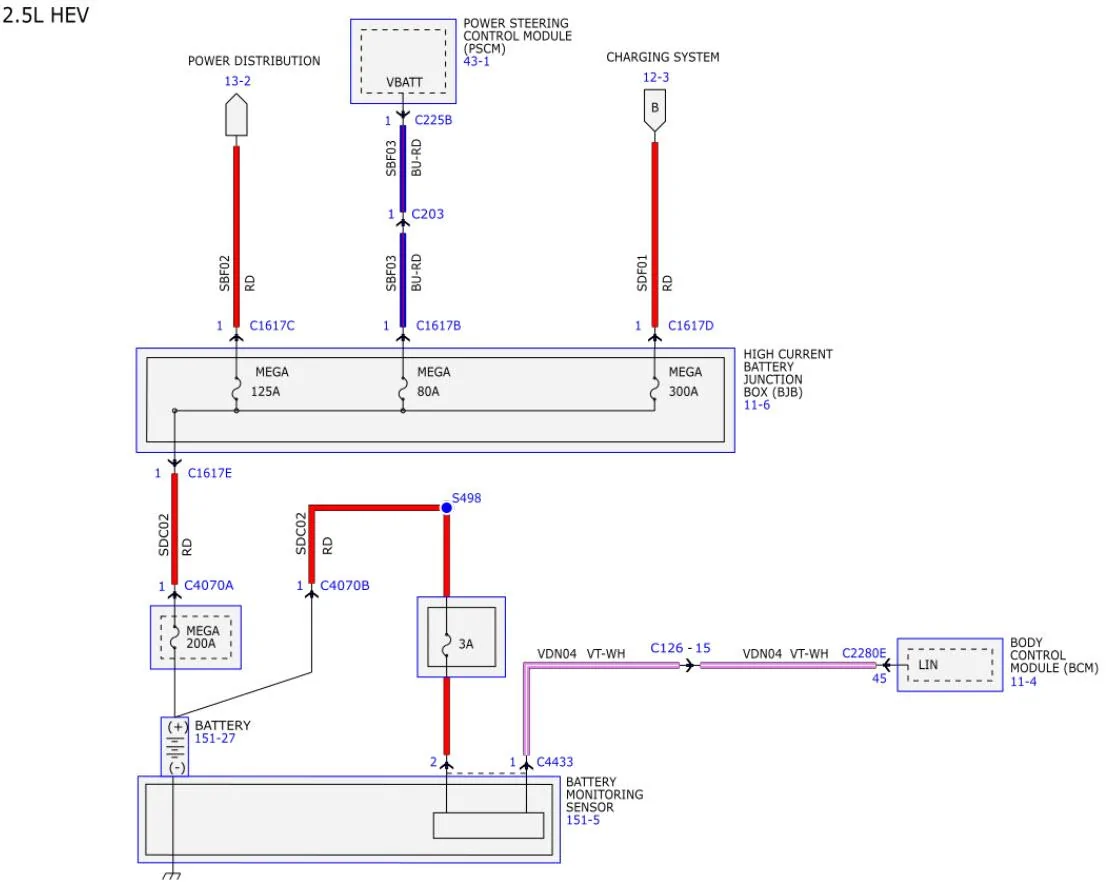

I use the jump post when I charge the battery.
It looks to be a piece of busbar that bolts into the High Current Battery Junction Box.
Ford Maverick Got a message today: Remote features disabled to preserve battery High Current BJB-1 - FordBossM
Ford Maverick Got a message today: Remote features disabled to preserve battery High Current BJB-4 - FordBossM
Ford Maverick Got a message today: Remote features disabled to preserve battery 2.5L HEV Charging System
