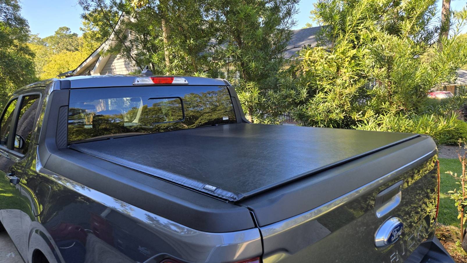

Ordered on Sunday, installed Wednesday. It was on sale for $50 off (no additional discount available). I really wanted a hard rollup, but that's not in my price range now. I was pleasantly surprised with how well it fit. Nice and flat, and low profile as well. Good product, delivered quickly.
Edit: Took me about 45 minutes to install. A ratchet was the only tool required.
Installation looks immaculate! Thanks for sharing these pics! Enjoy your new Gator SRX!

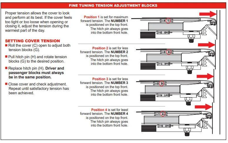

that looks great! I have the same one however I didn't install it and it is no where near as taught as yours, it sags between the supports. Looks like I need to go back and see if I can adjust it!
You may just need to adjust the tension. This might be helpful.

Thanks for all the quick replies fellas. Turns out, the header piece at the cab side was installed wrong, just had to flip it over so that it could fold under as intended. I set the tensioners on position 4 but I think I'll move them to 3 or 2 some time this week.
