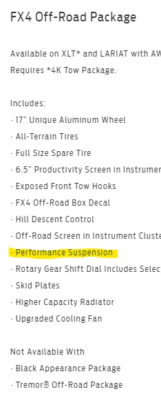

Just curious, the other fx4 features listed are obvious

Exactly the same, no difference

Shocks may be different. The other fx4 upgrades are more desirable

Thanks for the replys. I read that on fords website so was curious if it was beefier.

Pretty sure the shocks/springs are the same on AWD vs FX4, just the different drive modes and additional goodies like skid plate, etc...

Ford Maverick Fx4 "performance suspension" vs xlt awd suspension? Screenshot 2023-10-21 165633

Rear (AWD)
Independent multi-link trailing arm suspension with twin-tube
hydraulic gas-pressurized dampers, coil springs, stabilizer bar,
steel sub-frame and cast knuckle.
Rear (AWD/FX4)
Independent multi-link trailing arm suspension with mono-tube
hydraulic gas-pressurized dampers with hydraulic rebound stop,
coil springs, stabilizer bar, steel sub-frame and cast knuckle.
FX4 gets mono-tube shocks vs twin-tube shocks on the standard AWD.
