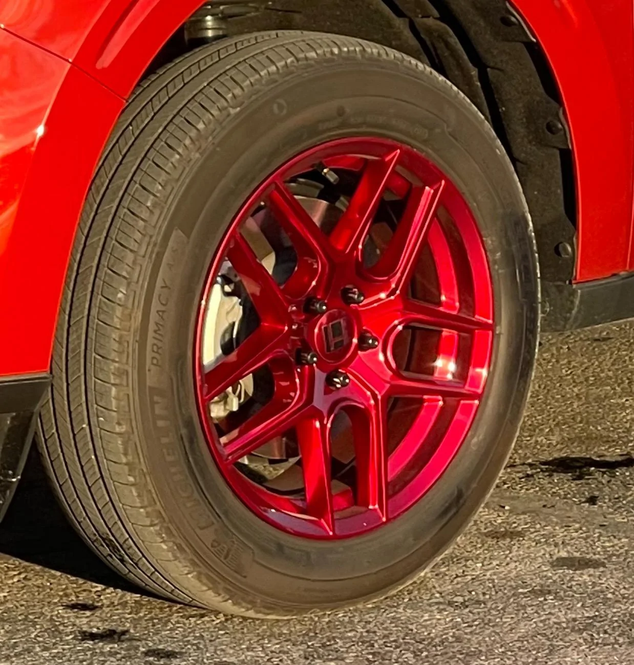

None
I like my 18x8 TR79 Tourens much more…and only $200 each
