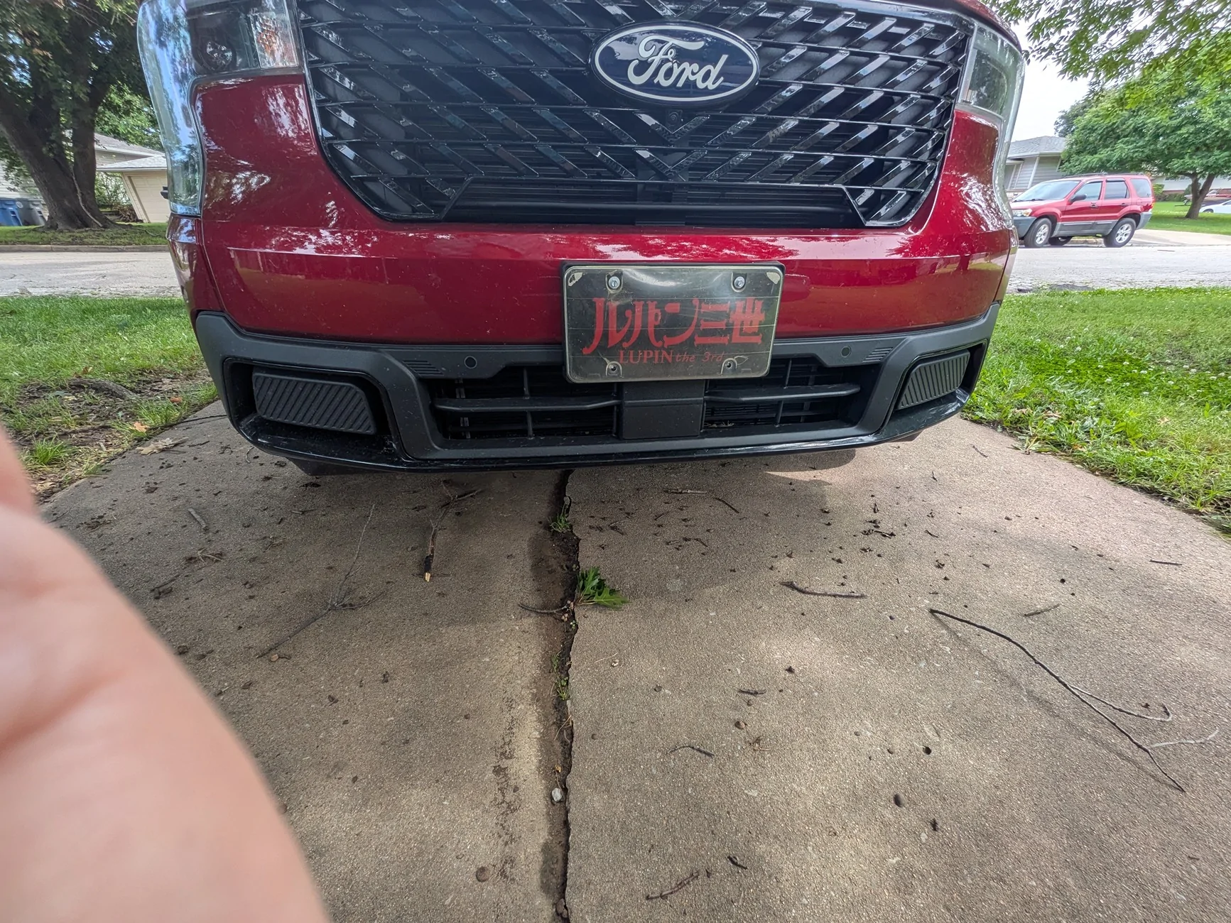

Oklahoma and Arkansas are a one license plate States. But I've always had a personalized license plate. When I bought my 2026 Maverick I asked them for the front license plate Mount. The dealer had to order it. The salesman later told me it cost $50. There are three indentations on the front bumper and you are given three plastic rivets. I had to go buy a rivet tool cuz I couldn't find mine. So you take a small drill bit drill out the three dimples put in the plastic rivets and that's how my front license plate was mounted.
