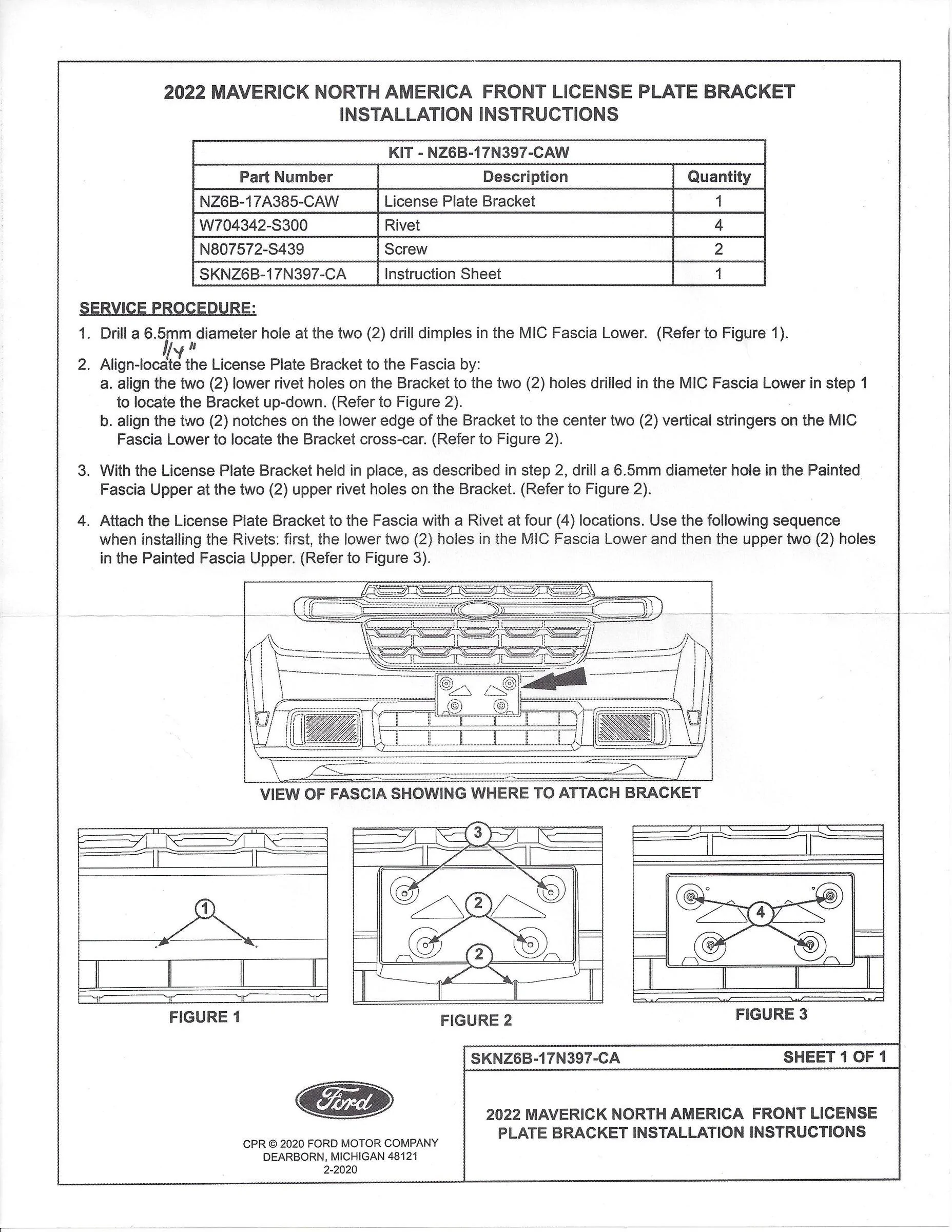

I installed the front license bracket supplied from Ford myself by drilling only the two bottom holes in the black top portion on the lower grill area and am using small velcro squares to hold the top portion of the bracket.
EDIT: I have attached a copy of the installation instructions.
In the procedure I did step #1 then put the small velcro squares on the back of the bracket over the top two mounting holes then did step #2. I did not do step #3 and in step #4 only did the rivets on the lower two mounting holes.
If Texas ever gets rid of the stupid front license plate law I will remove the bracket and plug the two holes in the black top portion on the lower grill area with a like colored black plug that should blend with the black grill and not really be seen.
I did the same thing but I used double sided foam tape instead of velcro
