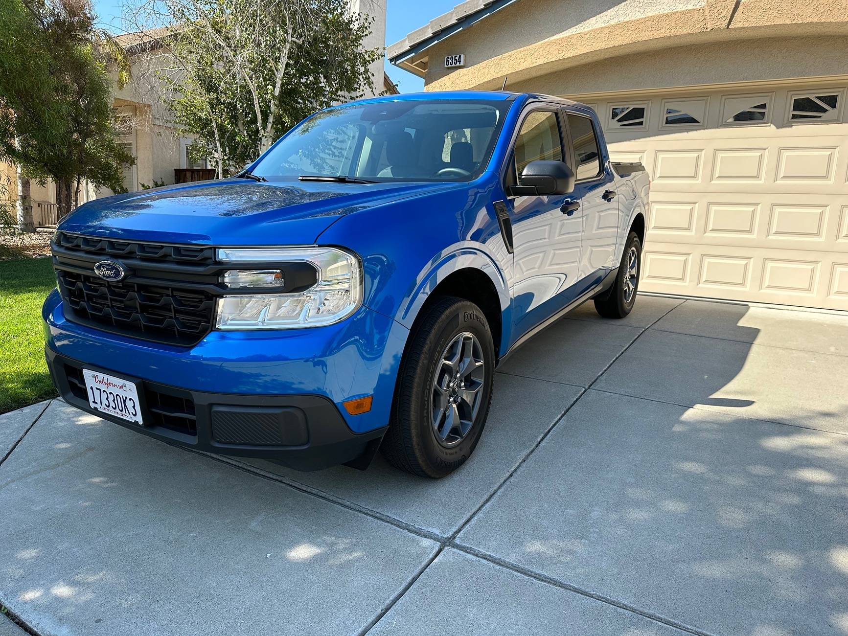

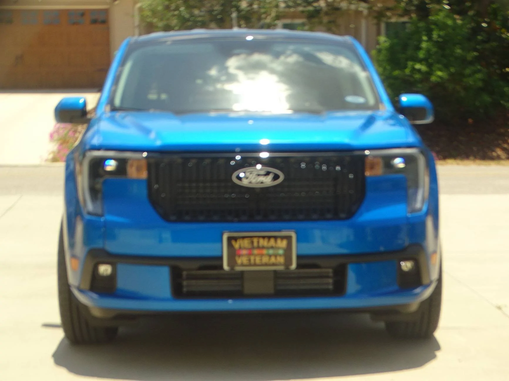

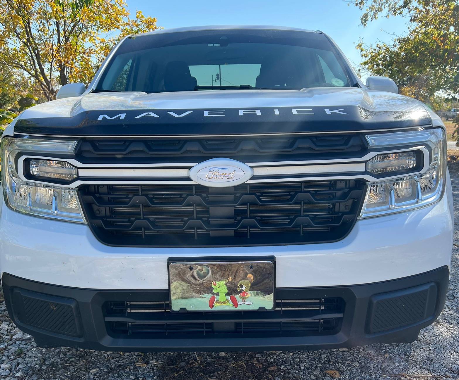

This is where I mounted my front plate bracket. Held on with a heavy duty zip tie. I no longer own this truck, but I mounted it the same way on my 2023. Zero issues even on the hottest California days.

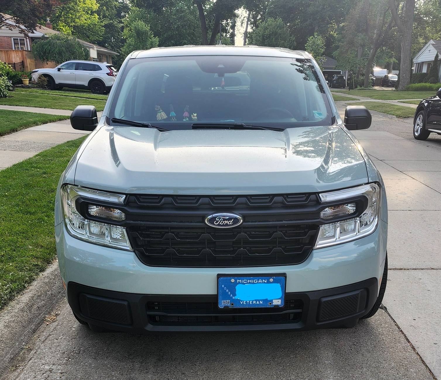

Here it is, mounted to the right. I love it.

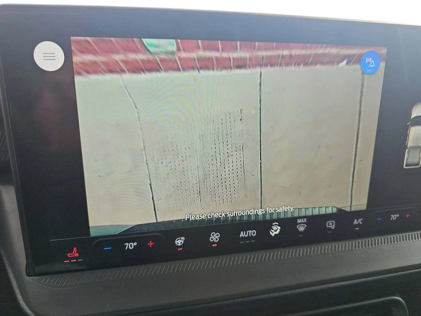

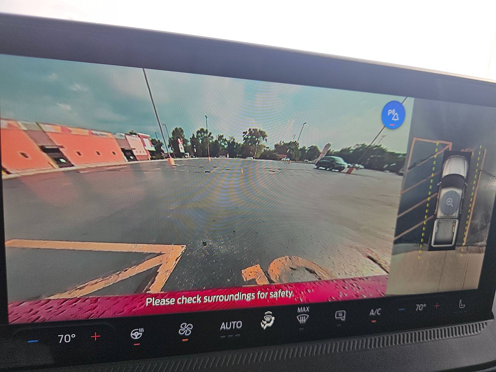

I don't know where the front camera is mounted but here is a picture of my front view camera on the truck I really like it! Plus my camera has got multiple views

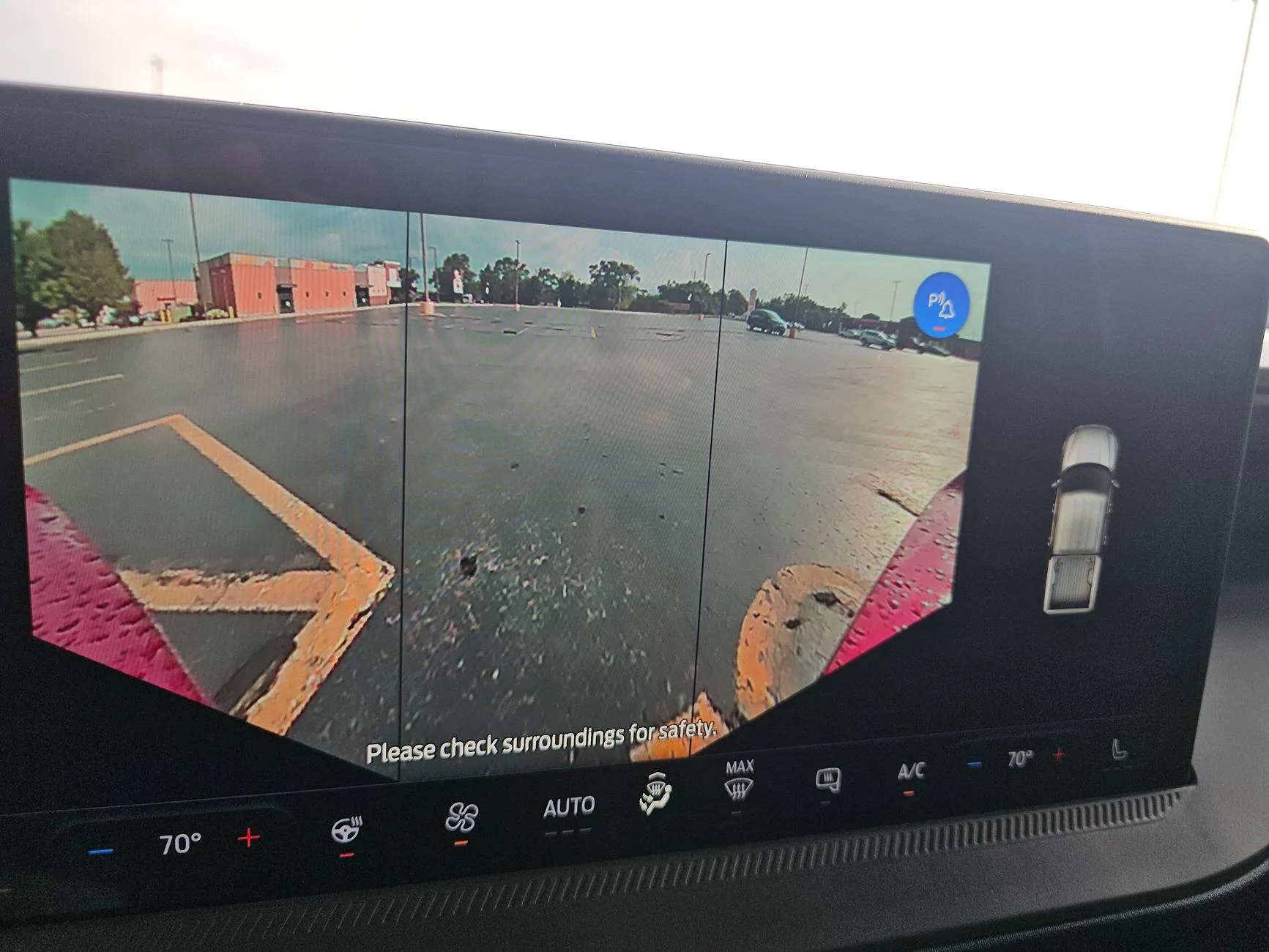

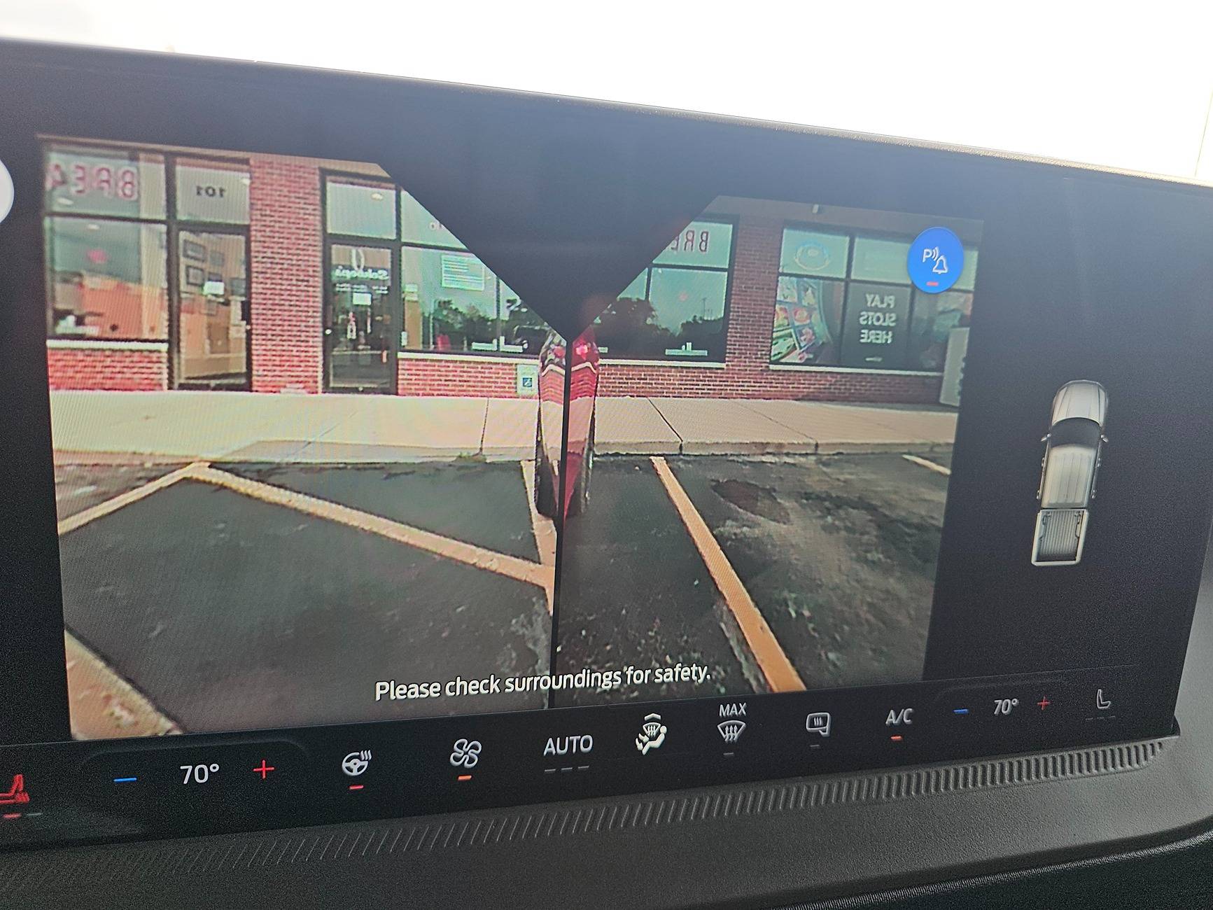

There are the other views of the camera

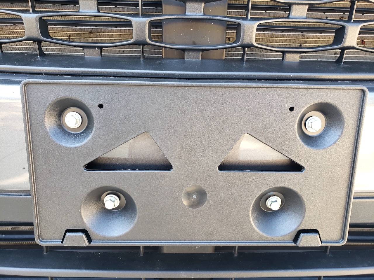

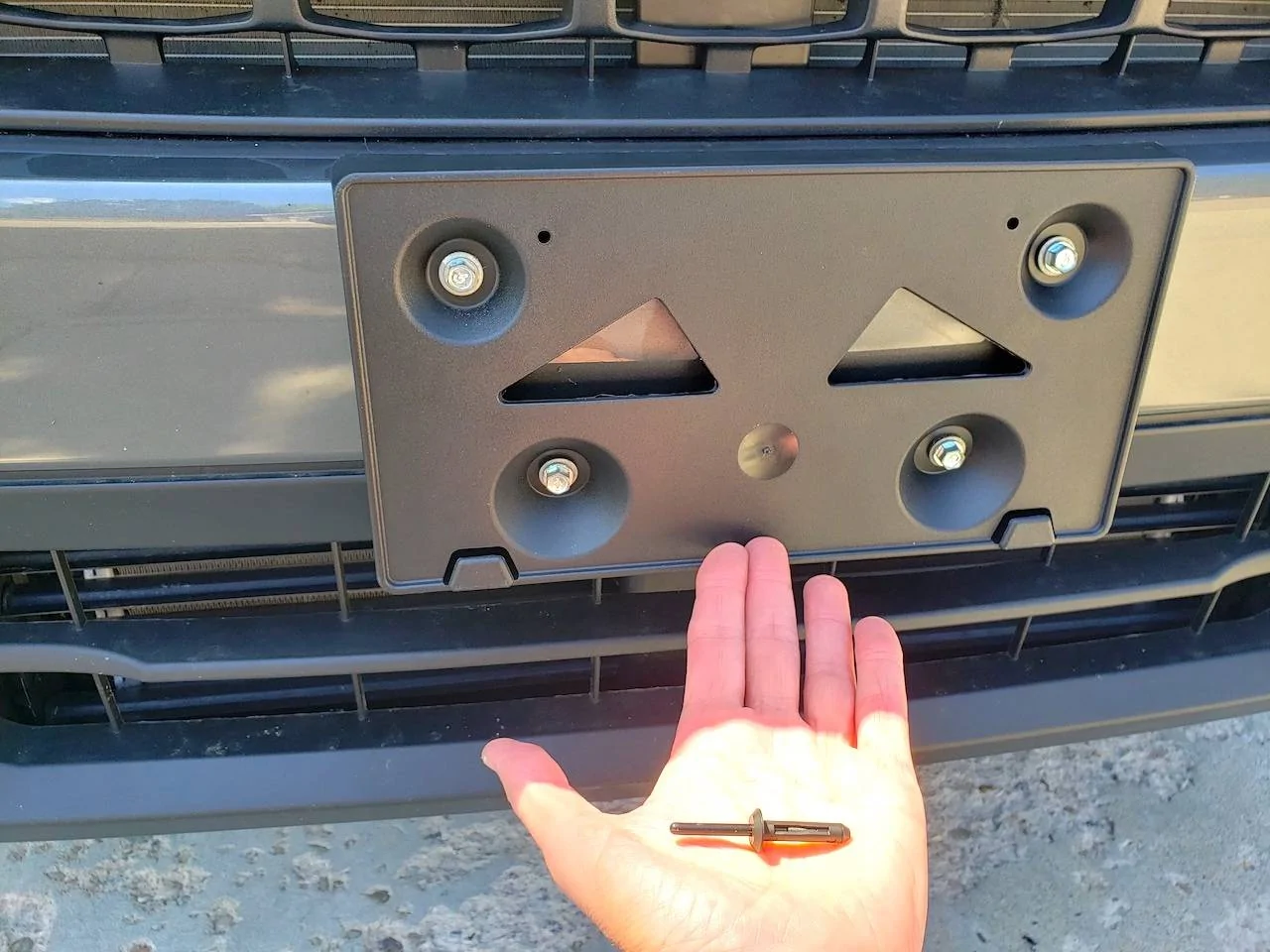

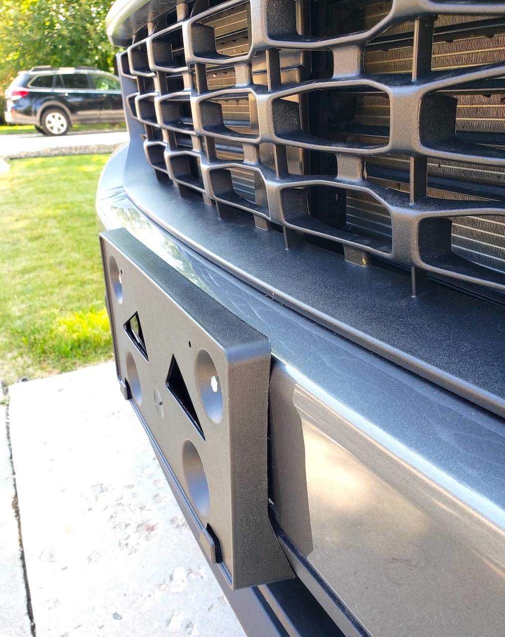

The factory mounting rivets suck!

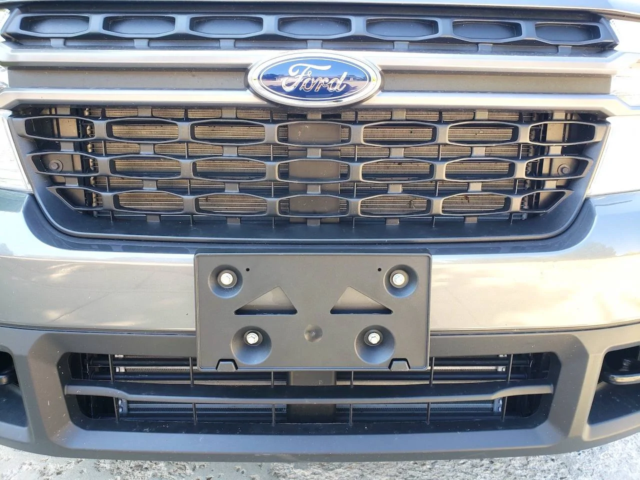

Tried to mount the front license plate bracket today with the pop rivets they include but they just broke. My cousin suggested using self-tapping screws and it worked fine, and is on very solid. We moved it up a little so it's not quite flush with the top but it's okay.
I don't want to get pulled over for no front plate, esp. after an IPA or two at the brewery ha ha

Yes, the rivets are difficult to install without a rivet gun for 1/4" rivets, but you can do it by pushing on the rivet with the box end of a combo wrench and pull the rod with pliers. The rod snaps off once you pull it home.

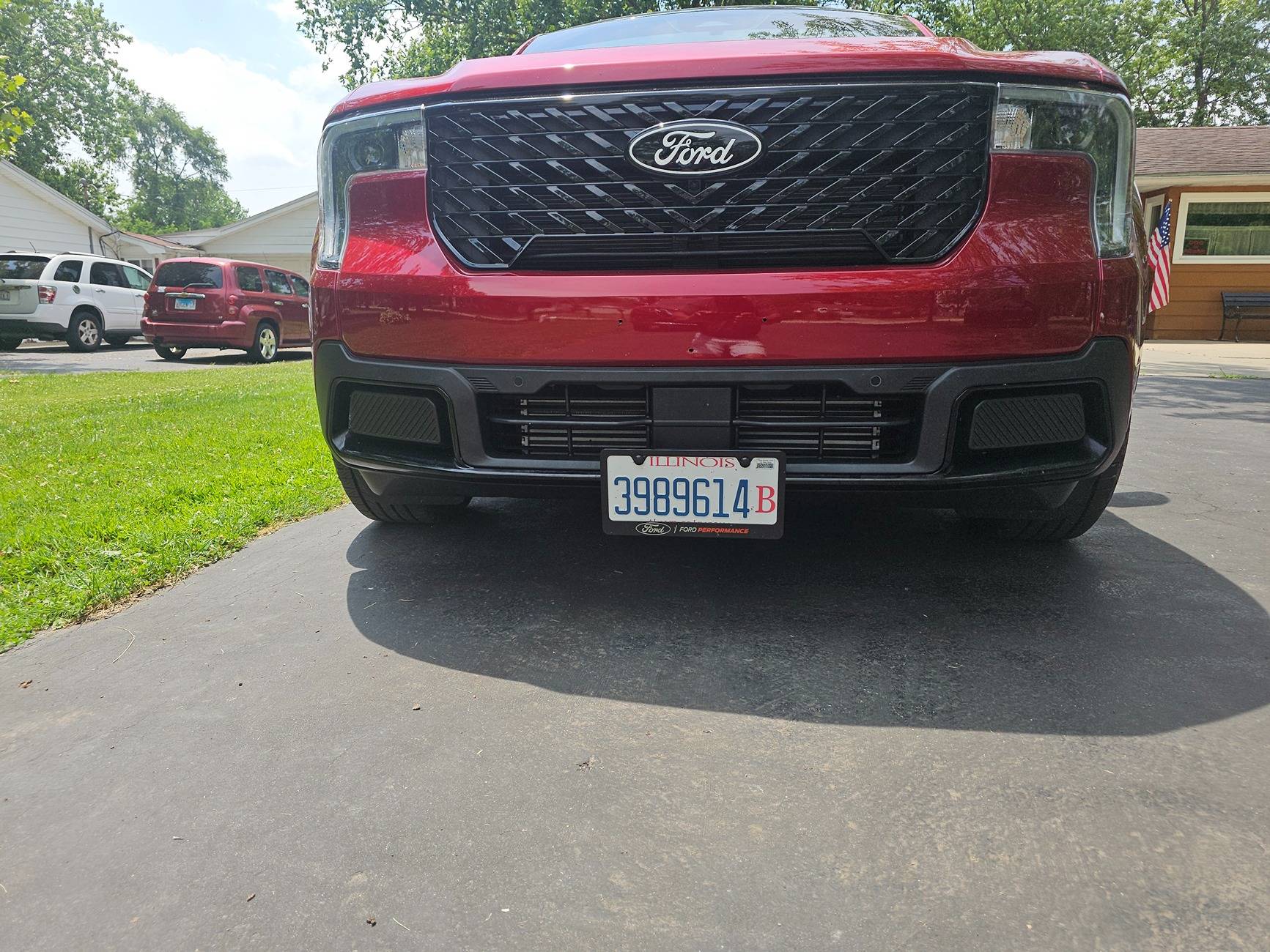

My license plate bracket head plastic rivets in it but I changed my bracket so I have to have the holes filled. I think there's a picture of my new bracket on here but I'll post it again
