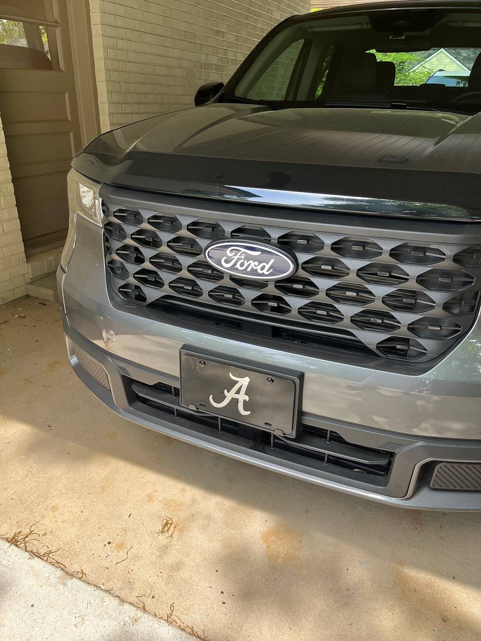

For my ā€˜25 XLT, even though Georgia does not do a front tag, every vehicle I’ve owned over the last 40 years has had a tag on the front (Alabama Crimson Tide). As has been stated above, the OEM bracket for ā€˜25 model is $160+. So I ordered a ā€˜22-ā€˜24 version from Amazon. Only modification I had to make was on the backside—the little vertical dividers below the solid ā€œbumperā€ are spaced differently so I itched-out the plastic. Seems to have turned out OK.
Ford Maverick Front License Plate Bracket IMG_2241
