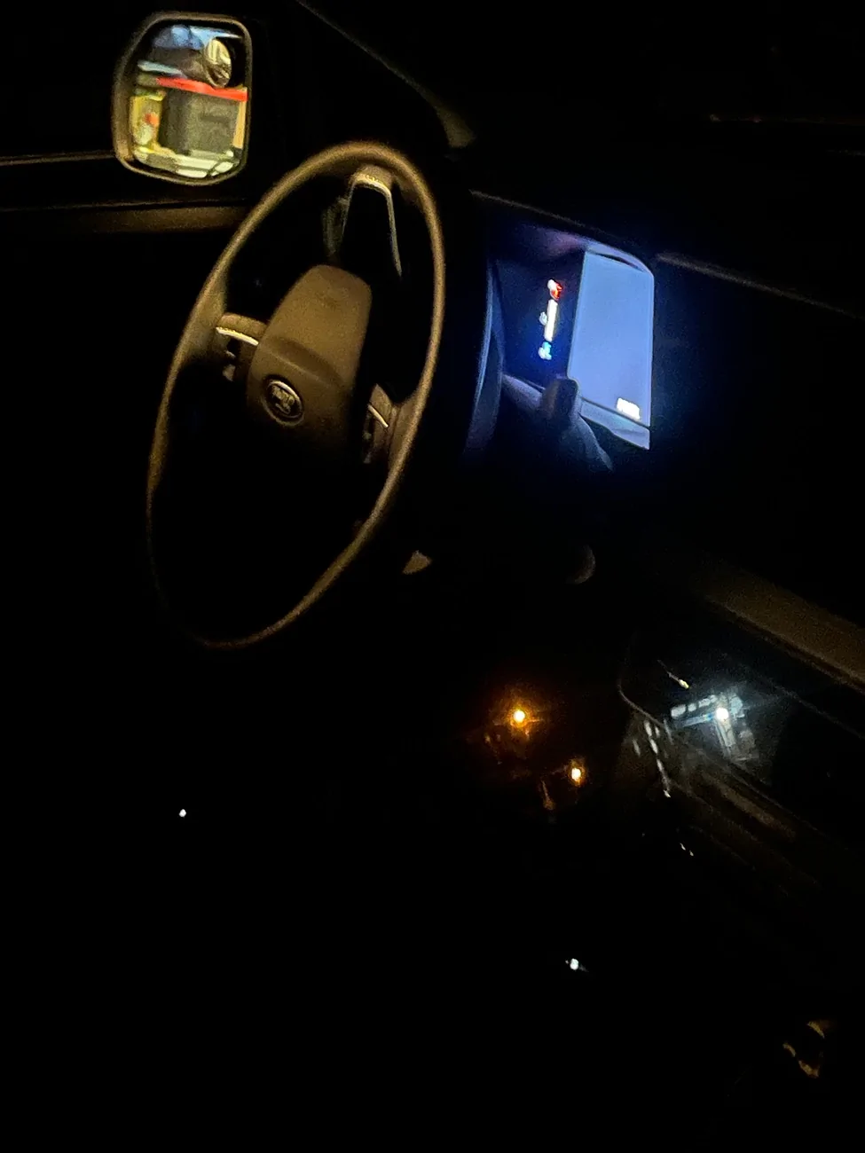

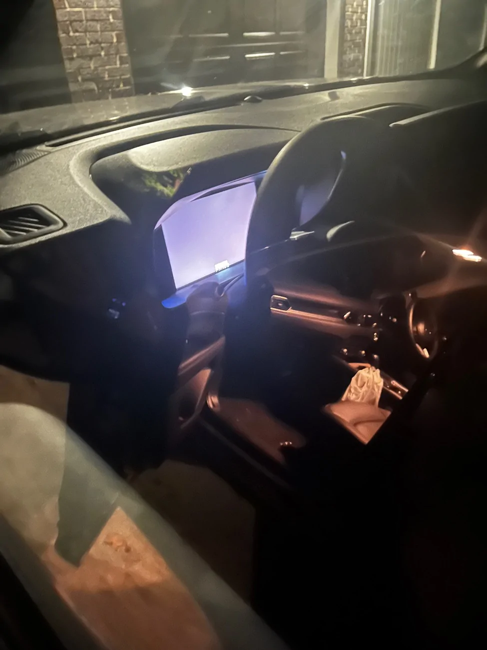

The problem has returned!
  1. Oct 6 2025 Truck failed to start. Battery read as 5 1/2 volts and Ford app showed vehicle was on while it wasn’t. Truck was jump started and left to idle for 20 minutes with all lights and accessories off.
  2. Oct 8 2025 8:45 pm Noticed Display screen was lit (no data on screen). Remote started vehicle for 5 minutes and came out to if screen was still on and it was. Remote unlocked vehicle and opened and closed the door then locked it again. The screen was now dark.

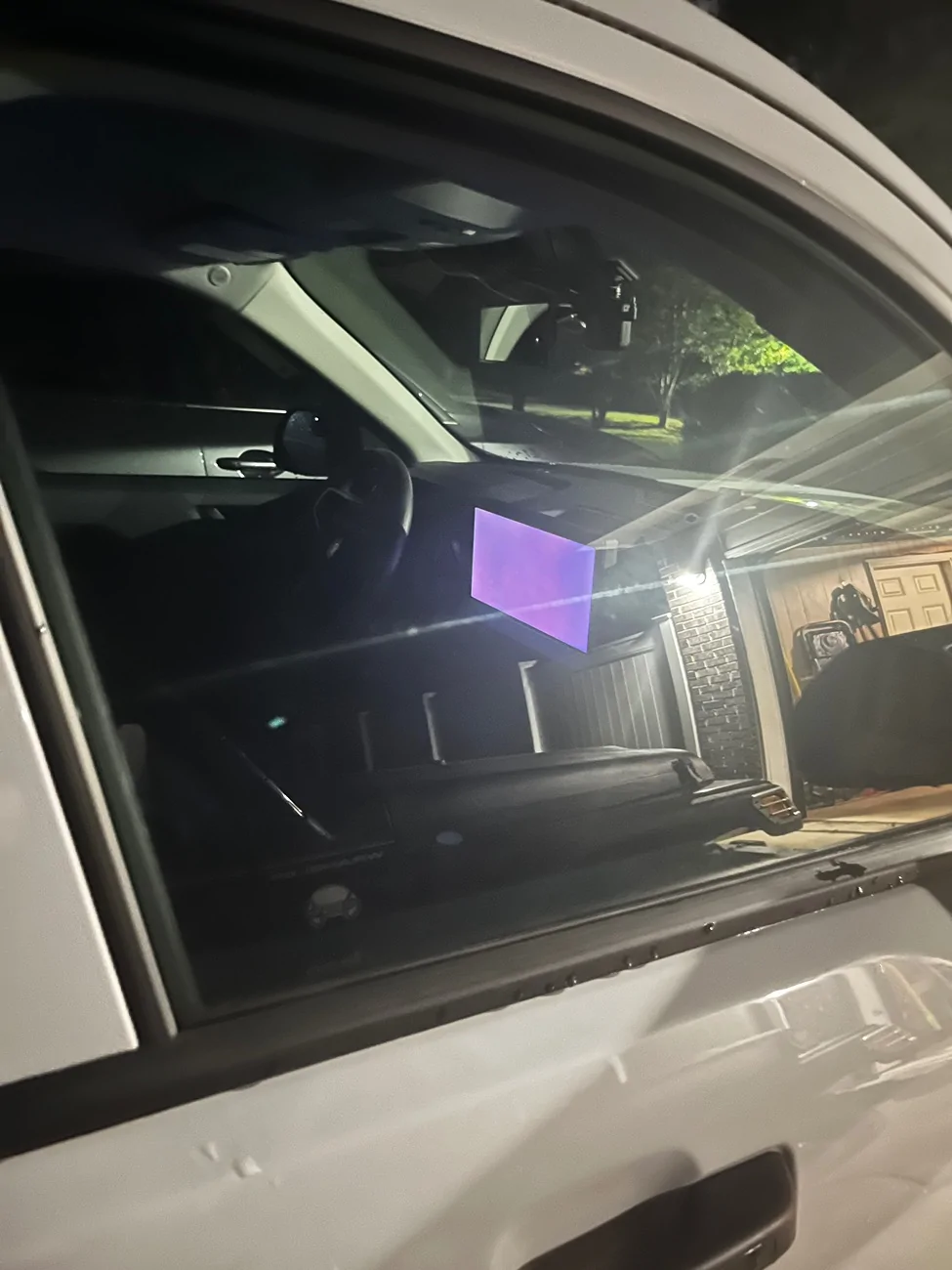

Another update: Another two jumps were required but this time I was prepared with a an AUTOWIT 12 volt charger. Both times I connected it to the battery it registered 5.5 volts. After it built up the voltage I was able to start the vehicle.
The vehicle was left unused while on a 14 day vacation and I was amazed it started right up. A few days another jump was needed. Finally I wanted to post a photo of the dashboard when the vehicle was not being used at night. I walked assed the truck and noticed a glow from the monitor. There was not an update scheduledat the time. Maybe this is the cause of my battery problems.
