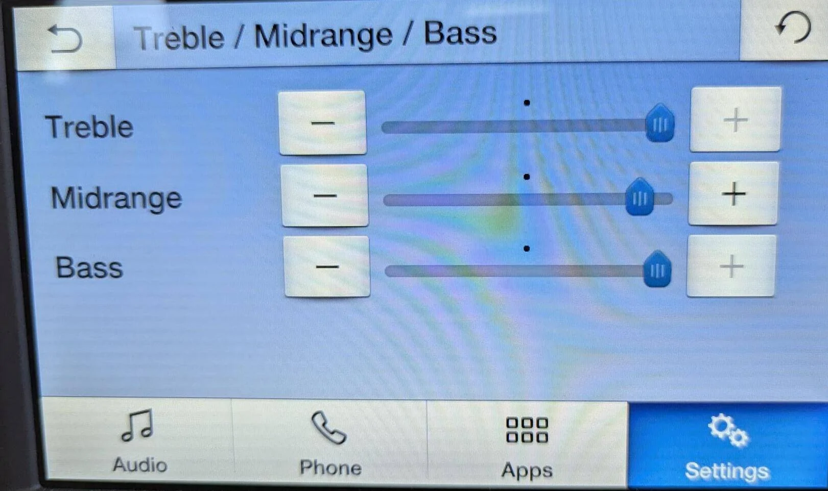

Try setting the sub crossover to 55Hz, then using the head unit tone controls set to this:

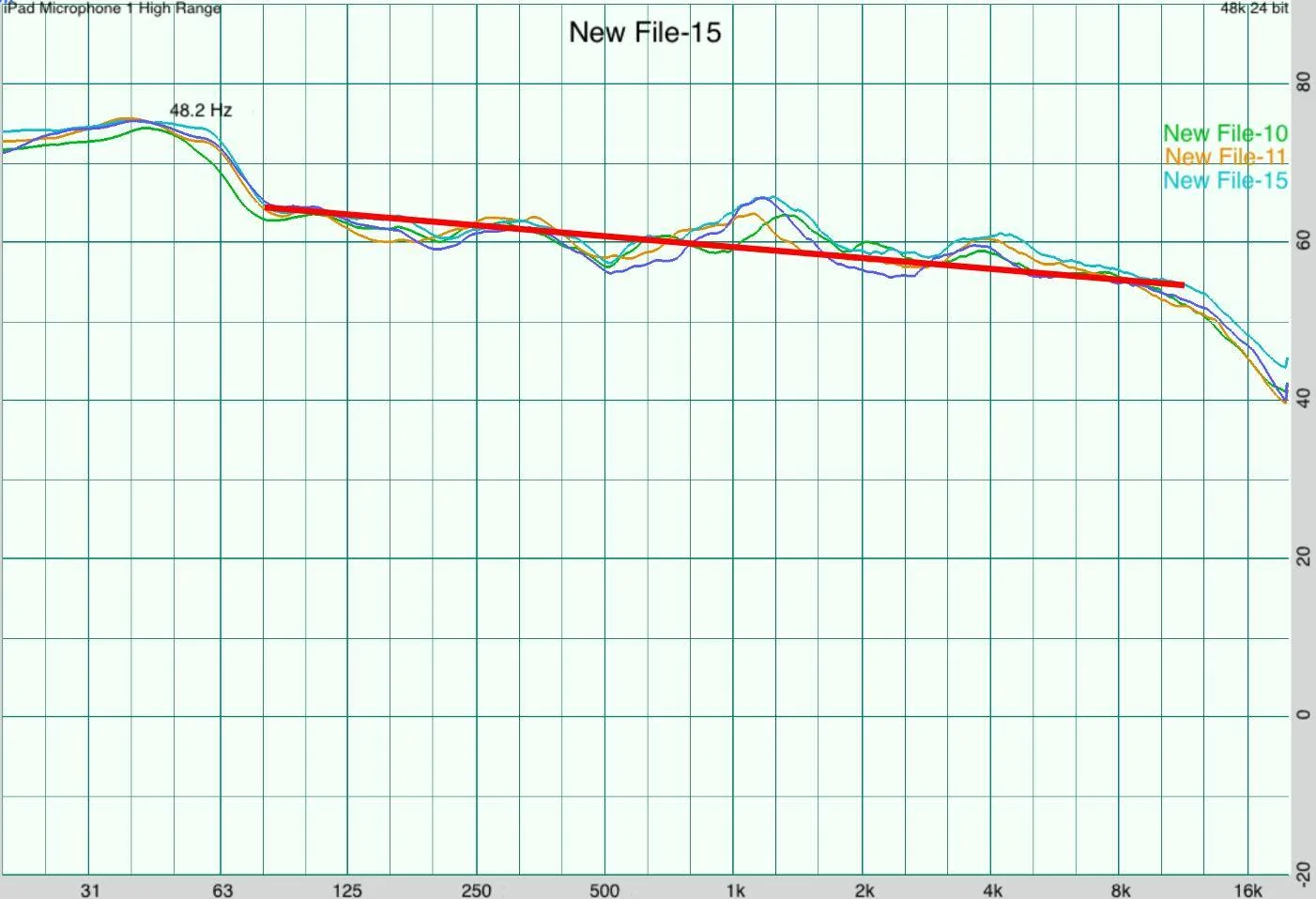

Which will produce a measured response at the driver seat, head height (where I sit, anyway) of:
Ford Maverick ForScan Flat EQ before key200.4? 1730389318822-wa
These settings significantly (but not perfectly) address the deficiencies of the stock speakers using "flat EQ" in Forscan, and blend the sub in more seamlessly. And don't require modification of the stock head unit/ACM to insert an aftermarket DSP.
Many people will find these settings and curve quite pleasant and punchy. At higher volume the peak at 1.25kHz will begin to bite a bit, but it is vastly prefered over the huge sag in the mid-bass and lower mids. Most will aos find the HF adequate as well, despite the rolloff above 8 KHz.

The curve above is measuring the effective power response, which should NOT be flat but have a smoothly falling response of .5 to 1 dB/oct. I drew the red line to illustrate how well the measured curve fits a smoothly falling line. This represents how you will perceive the overall timbre of the system.
Oh, and for the alert, the mic used for actual measurement was a Denon receiver Audessy mic, using the calibration file some REW member extracted from an Audessy receiver. I used that mic as the calibration is diffuse field, which best simulates what the ear perceives in a car cabin with all speakers operating.

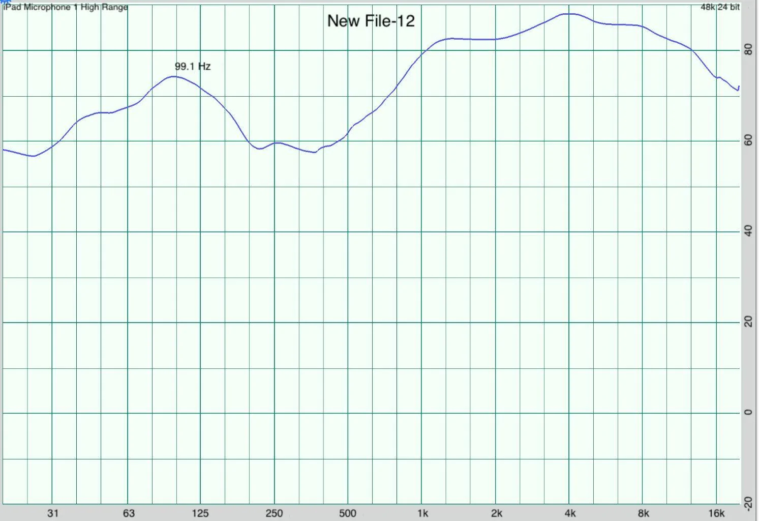

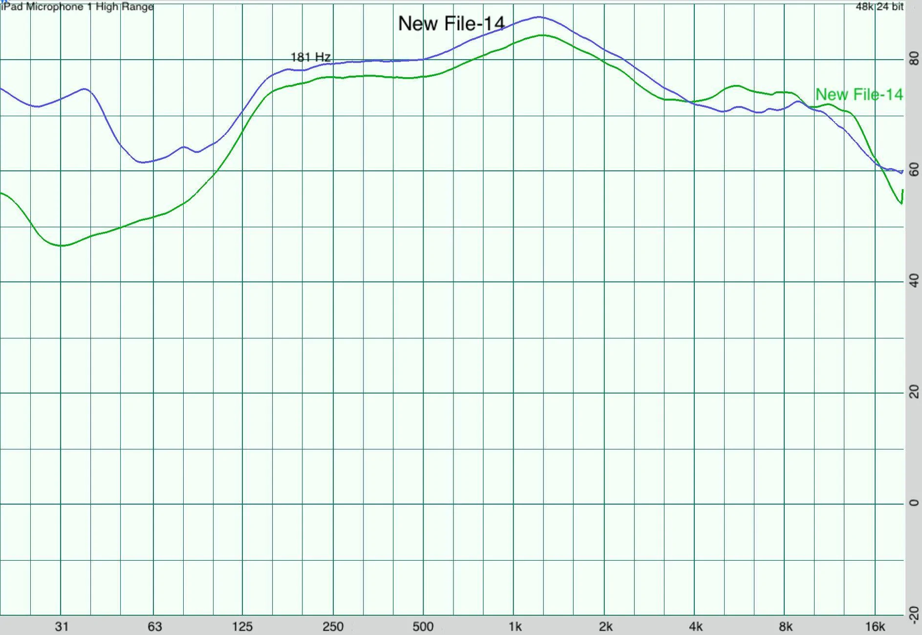

For those interested, here are the "naked" close-mic'ed curves of the rears, and dash tweets with Forscan in "flat eq" and with head unit tone controls zeroed.
REAR Speaker. GREEN = zeroed head unit tone controls. BLUE = tone controls optimized, as shown in previous image. Notice the sizeable peak at 1.2KHz, which seems largely responsible for the (undesirable) peak in the overall system response. When I have time, might suss out whether the driver is responsible or some interaction with the cavity.
Ford Maverick ForScan Flat EQ before key200.4? 1730394806231-j2
DASH TWEET: tone controls zeroed (I think): The tweet response is somewhat modified from factory, as I pulled them and raised the value of the high pass capacitors to move the cutoff to 2Khz. I have cap value noted at home. Ignore anything below 150Hz in the graphs, as there was some LF influence from the doors speakers when measuring the tweet, and some engine rumble when measuring the rears when the tone controls were zeroed.
