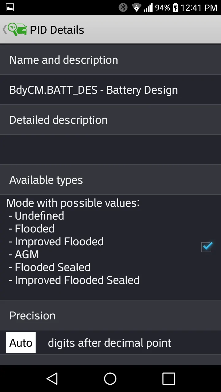

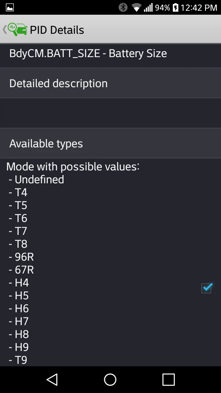

I have Forscan. What are the steps to raise the charging level. I need to do something besides helplessly continually checking the battery's state of health. I just can't believe we are still having to talk about and deal with this.
If it's a PID that is even actually used (because the only reports I've seen on it in the past included 3 things done at the same time - so rather impossible to logically say it was this change that made the difference), it's these related ones - might as well correct all of them with your actual battery stats. As they are currently read on my 24MY - no option is checked.
The view you see of options in the examples is merely the checkbox in the middle of the range.
BCM.BATT_CAP, CCA, DES, MAN eh skippable?, SIZE, TYPE.
Unshown BATT_SOC Charge level (thought I had it, but it displayed like the others a current null value) - this could be set to 85% as that is the max fully charged battery level. I'd bet 100% is an invalid figure so the setting is not even used then.
(for anyone wondering on 1st pic - yes 9 months is not 50 days, I did the BMS reset, which helped in no way except Zero out the charge/discharge PID's, and the day count)
After you make the changes - suggest a full charge, then unhook charger, and BMS relearn for 8 hrs overnight locked. Start off on best foot possible!
