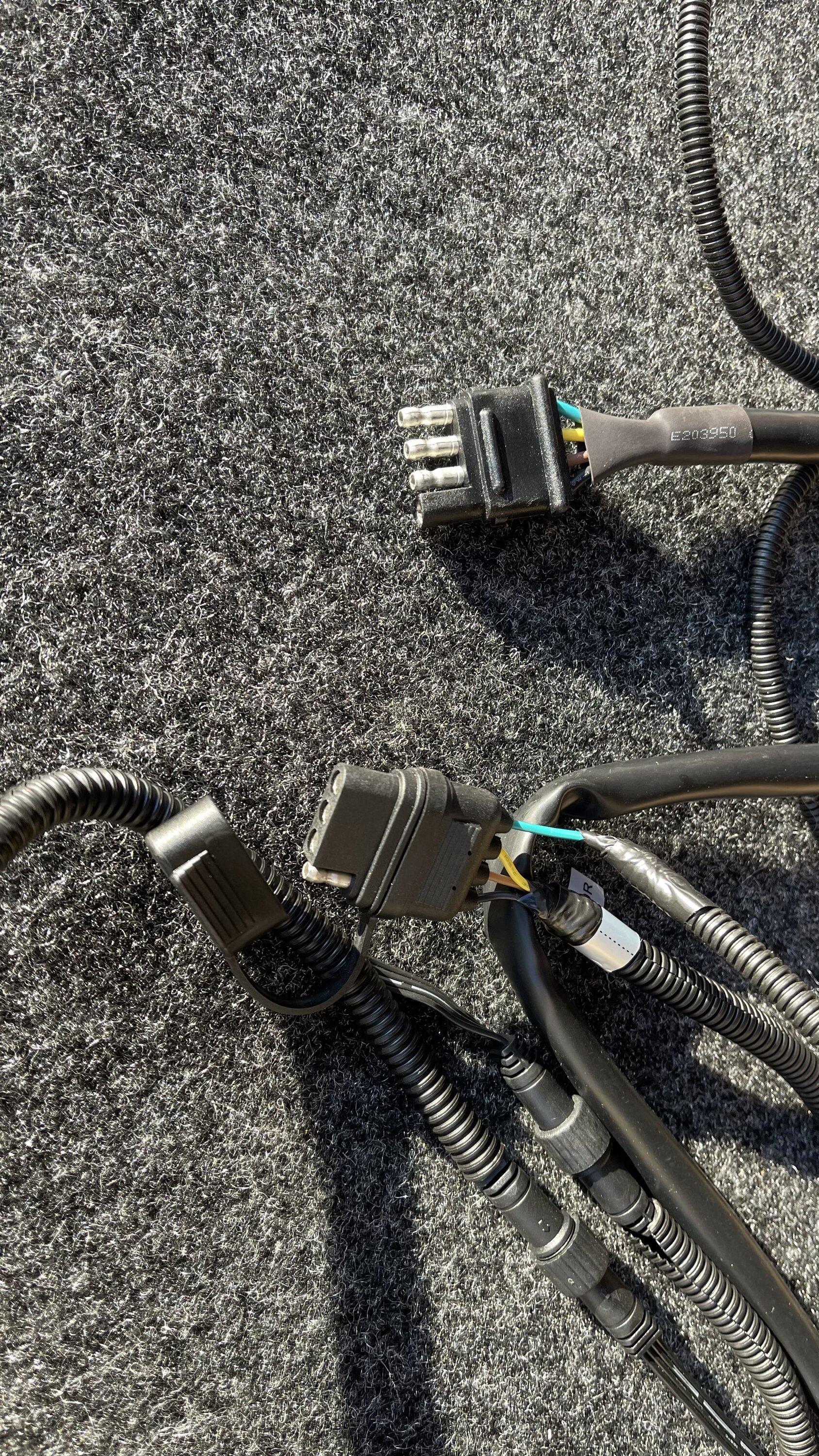

The instructions should have been more explicit that the only harnesses they were referencing were the taillight harnesses and the light bar harnesses. There is nothing there that has anything to do with the factory tow harness.
The light bar has a trailer-side 4-pin connector that mates with a truck-side 4-pin connector on the taillight adapter harness (NOT the factory one). we actually cut off both 4-pin connectors and spliced them together to avoid corrosion at the connectors.

So what you are saying is they should have just hook ed up the two taillight harnesses - then the for plug pictured below either gets plugged into one another or spliced?
That is correct.

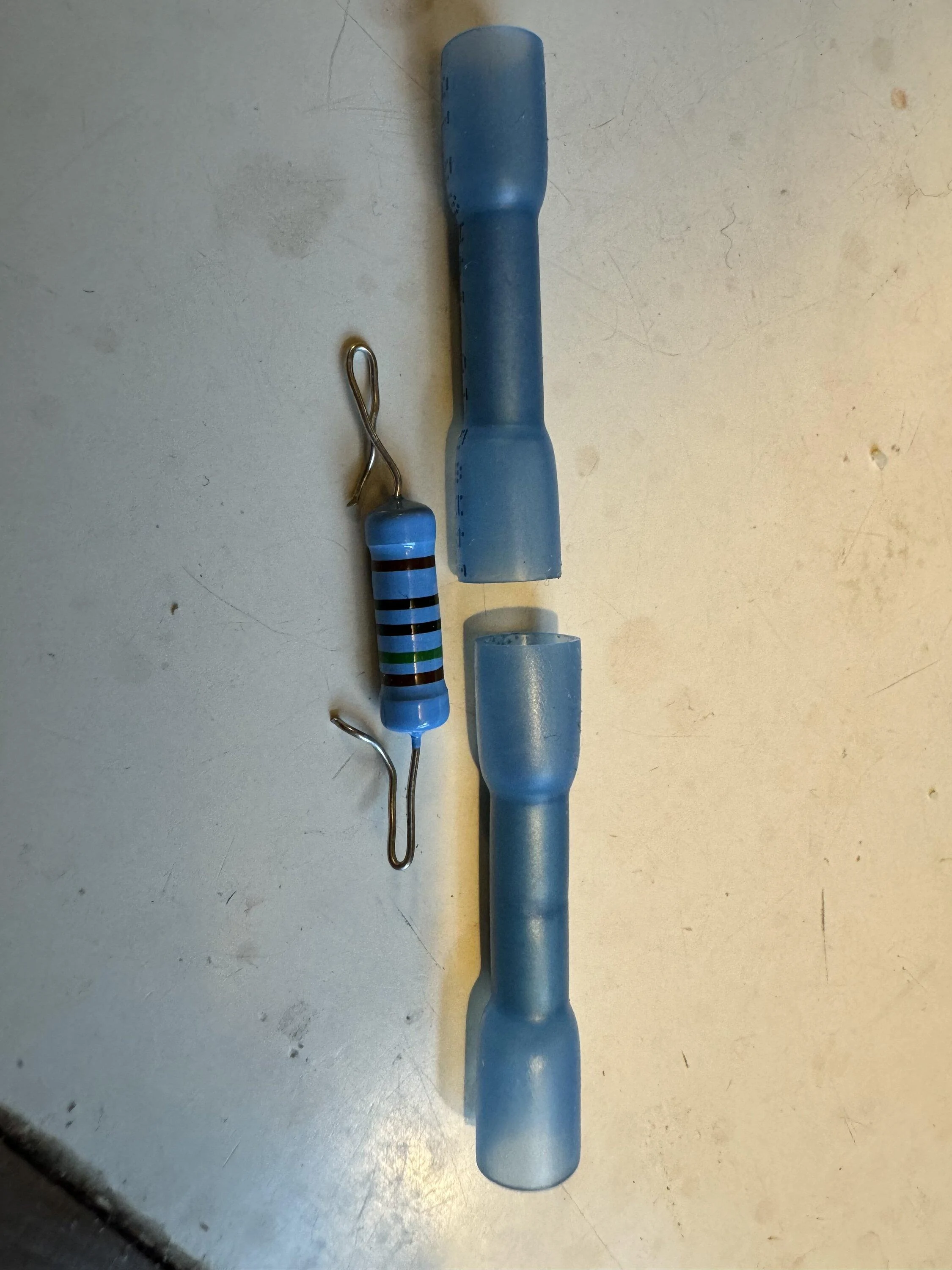

Awesome, thank you for the information. And to clarify it's still a 2-watt resistor similar to these Resistor?
Really new to resitors.

Yes On the resister.
I used 2 heat shrink butt connectors (blue 14-16awg) on either side of the resistor, cut the brown wire in the supplied harness near the control unit supplied with the lights and splice the resistor inline. I doubled over the leads from the resistor to allow for a more secure connection in the butt connectors. I like to use heat shrink connectors to help keep out the elements but not required.
