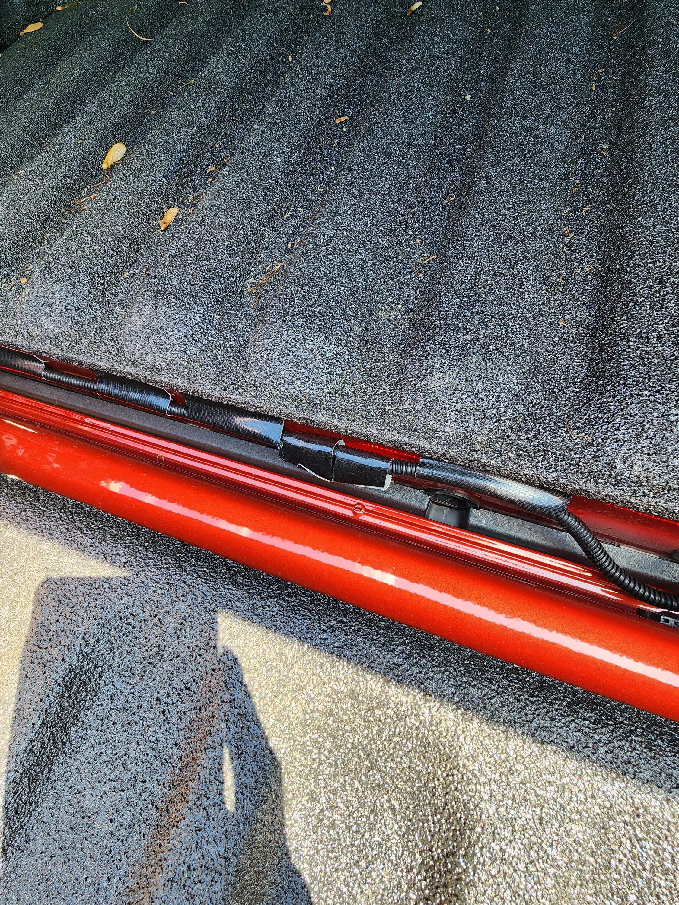

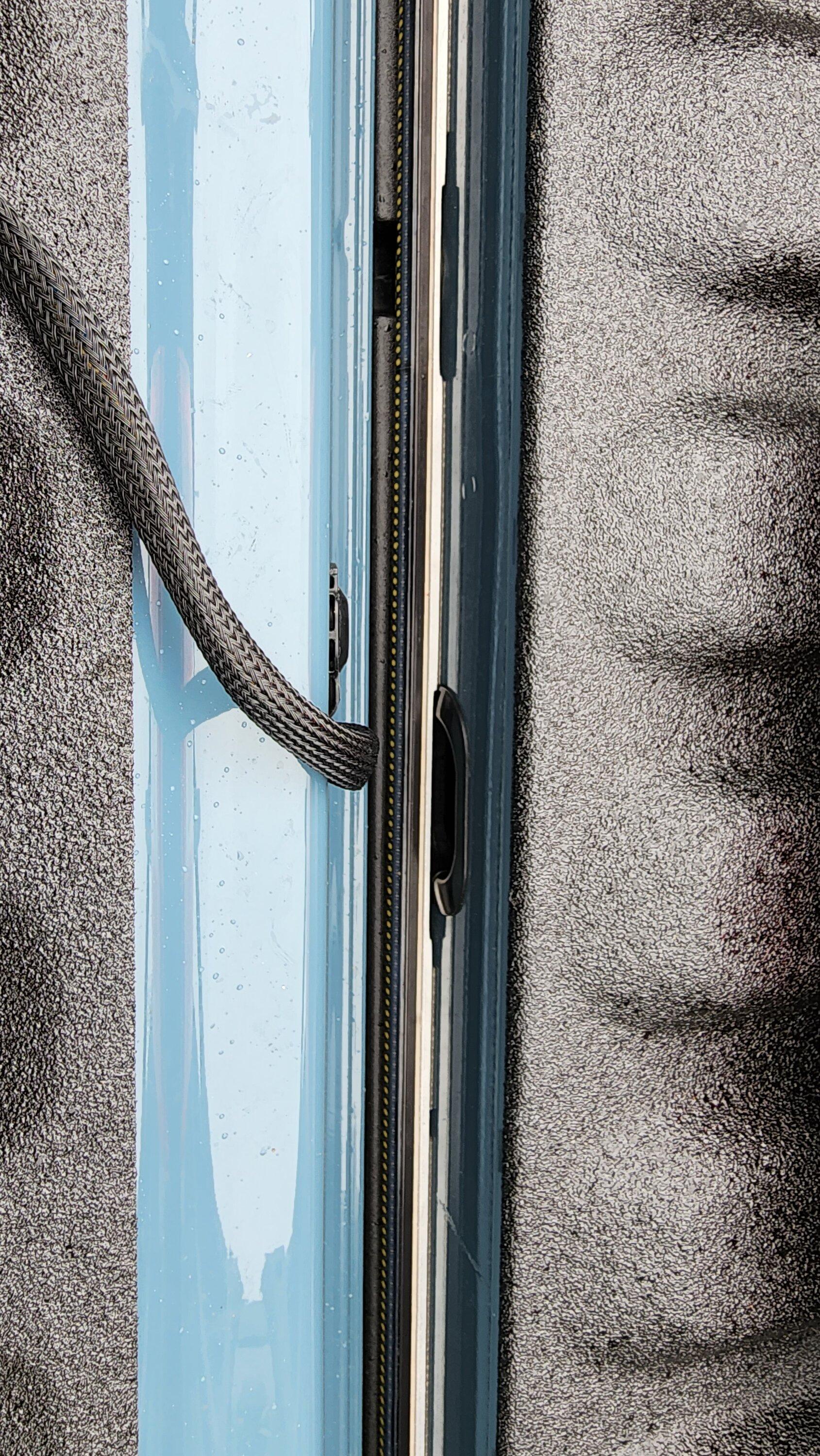

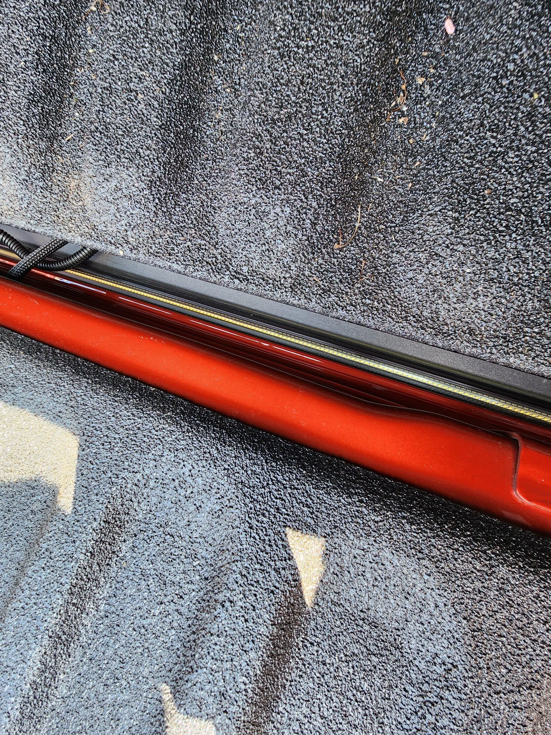

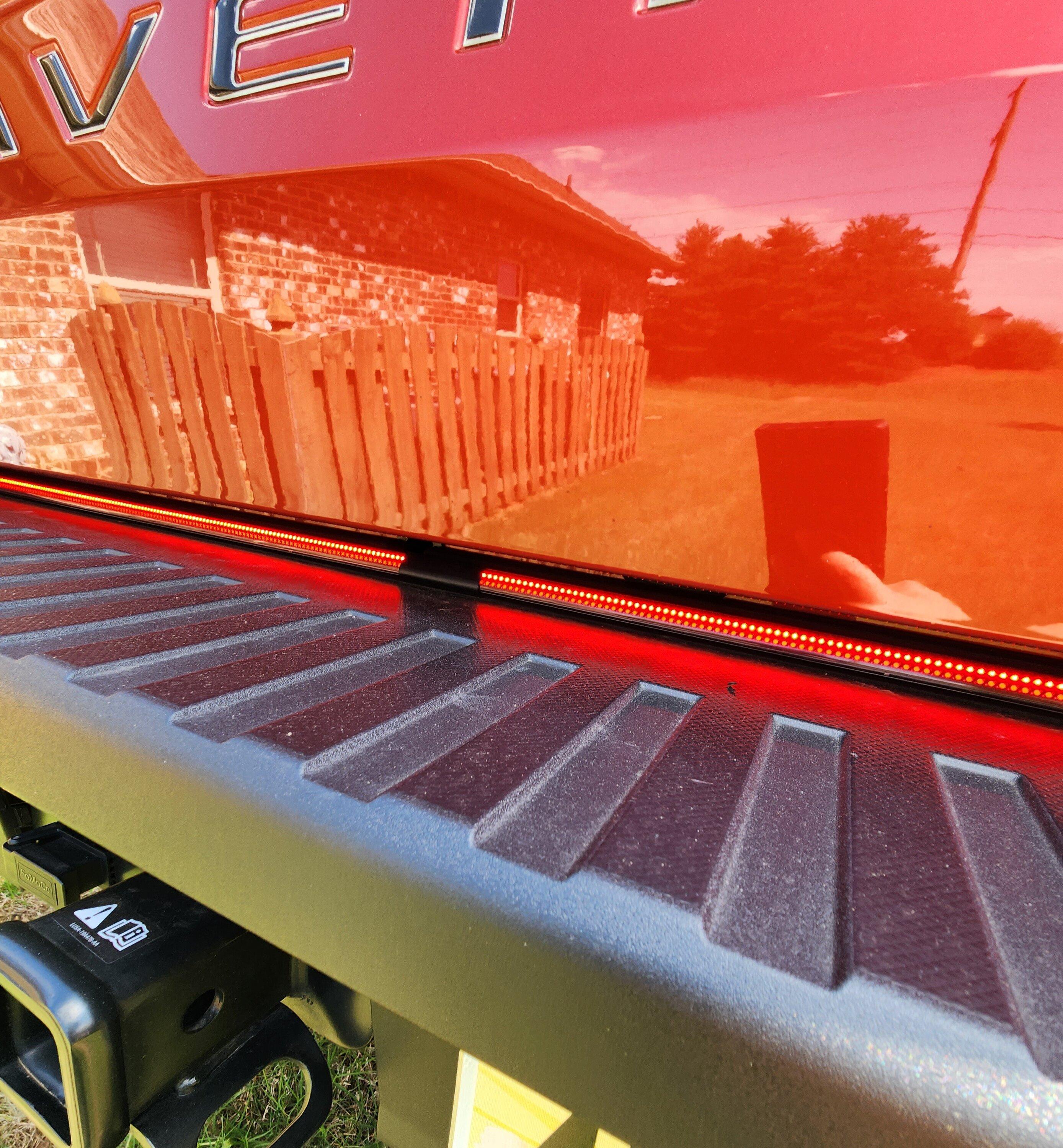

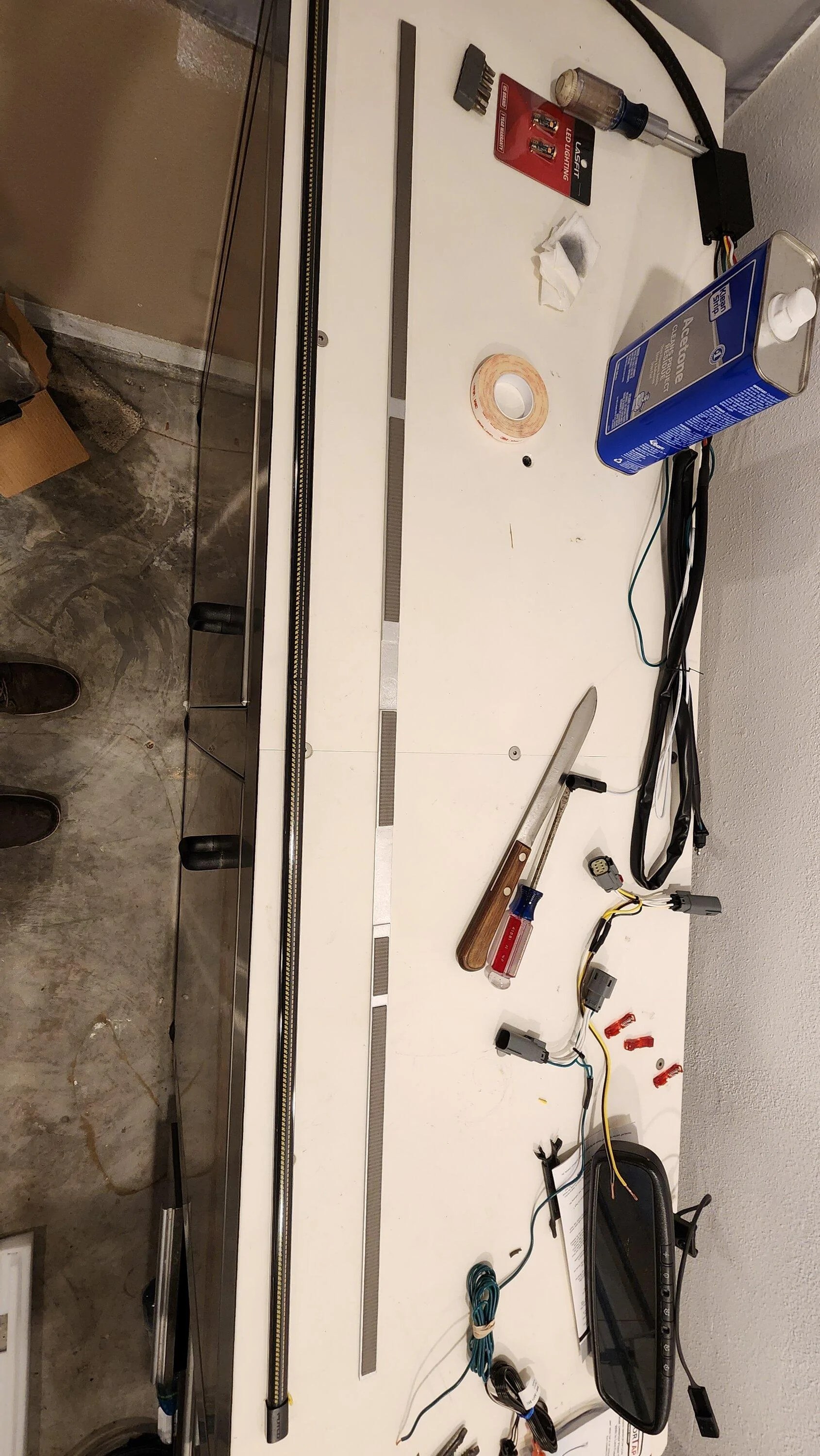

How is it mounted? Pics? Uses screws? Double sided sticky tape? The mounting surface of the plastic bumper is angled up.

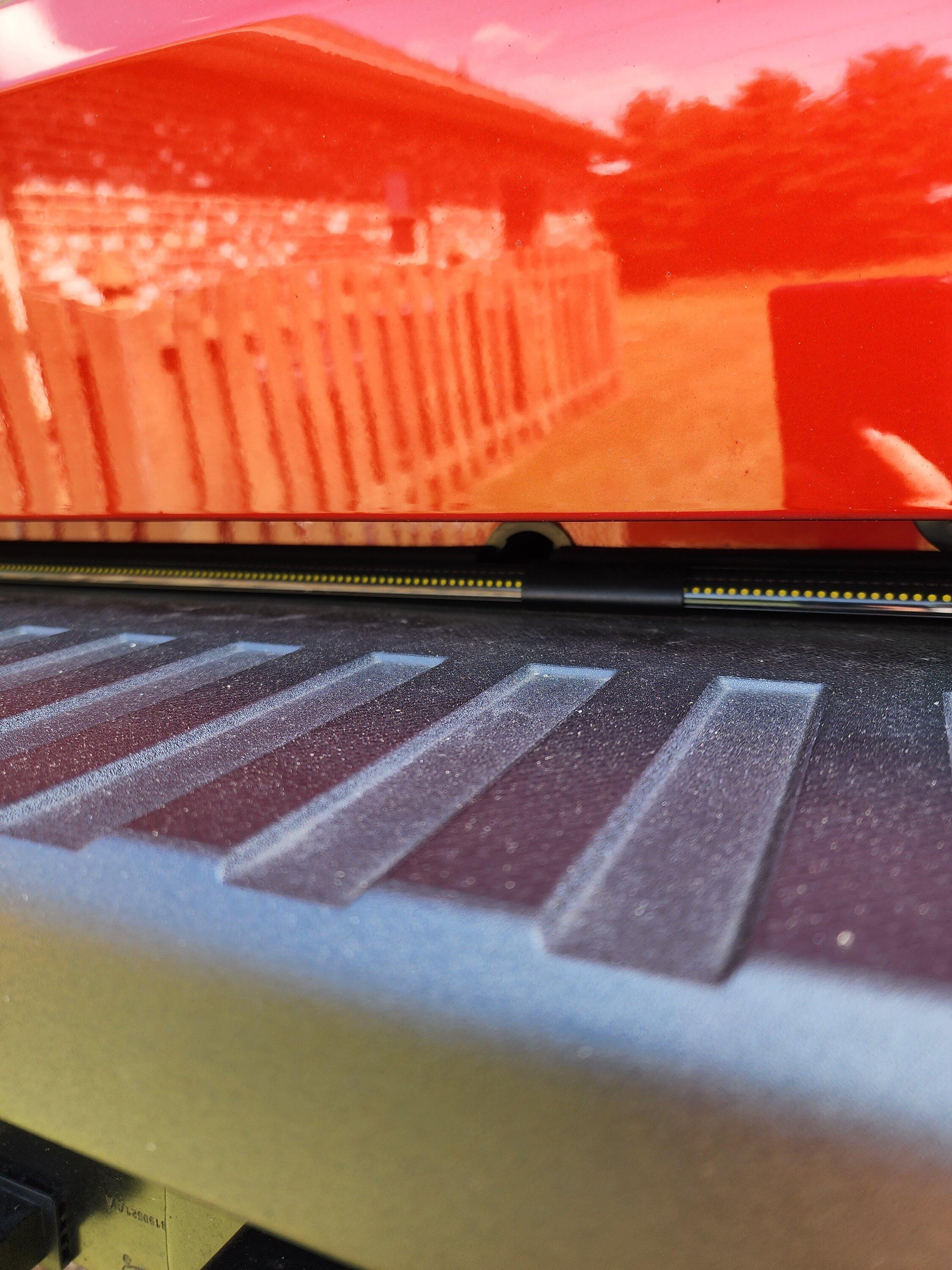

They used the adhesive that came with the bar as well as tape to paste the wiring to the tailgate. I apologize if not in order, but there are some pictures attached to this post:
**Note: The third picture is what it looks like with the tailgate fully down. You do not see the light bar unless you lift it slightly. Hence, why the light bar is visable in pictures 2 and 4. ***

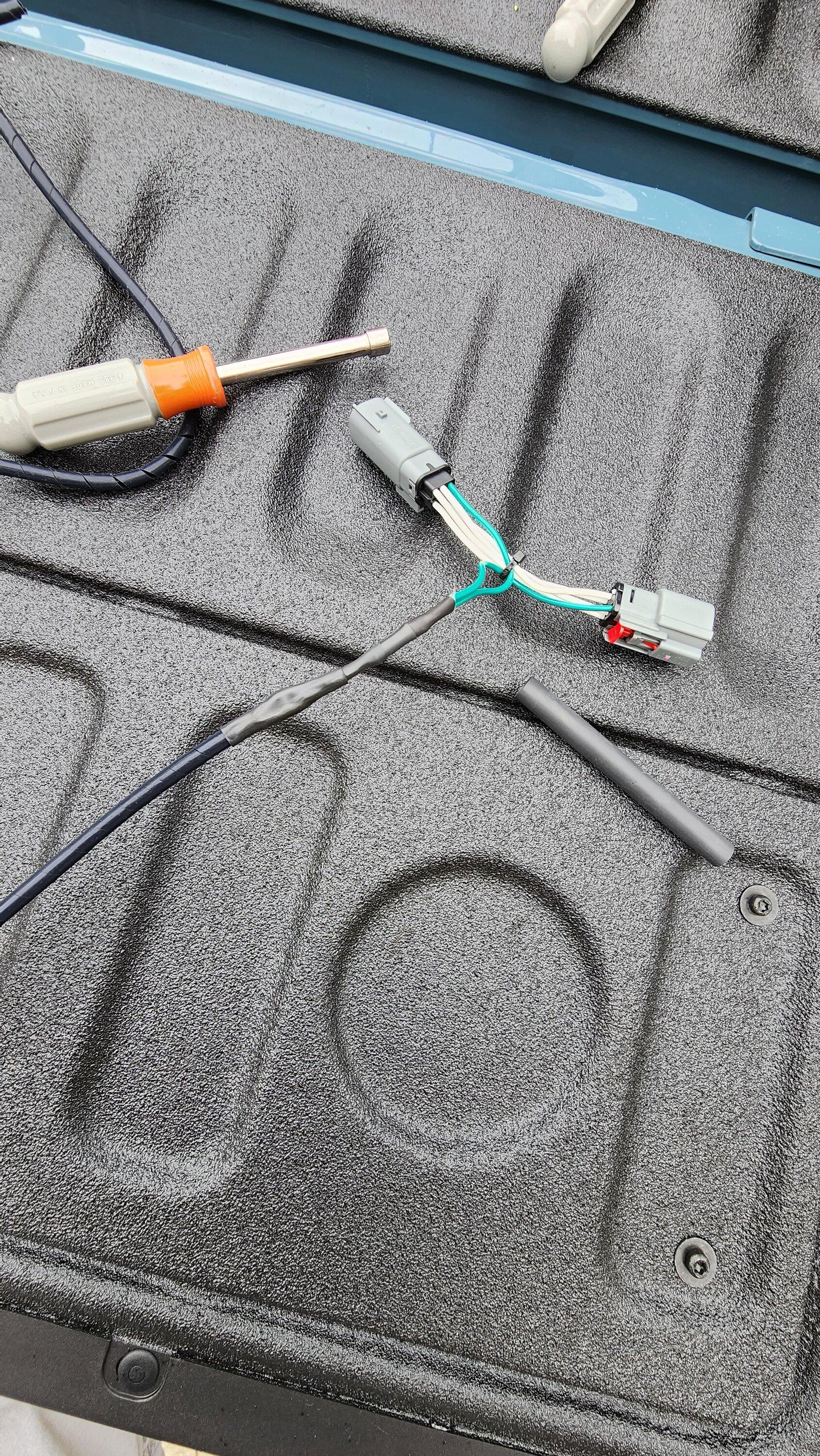

Putco: “I have one idea you can try, if it works it would require running a wire from the battery to the blade but it may solve this issue in the meantime of the engineers finding a more user friendly solution.”
Me: I purchased this from Ford accessories directly so that I don’t have to cut or slice any of the trucks wires, what would you suggest?
Putco: “It would require running a wire from the lightbar to the vehicles battery so your vehicles wiring would not be touched but the wires coming out of the lightbars black box would need to be modified.”
Me: OK, what wife do I need to alter?
Putco: “Coming out of the blade box you will see 2 red wires, one side will have a heat shrink and one side is plain cut the side with the heat shrink and give power to the plain side.”
