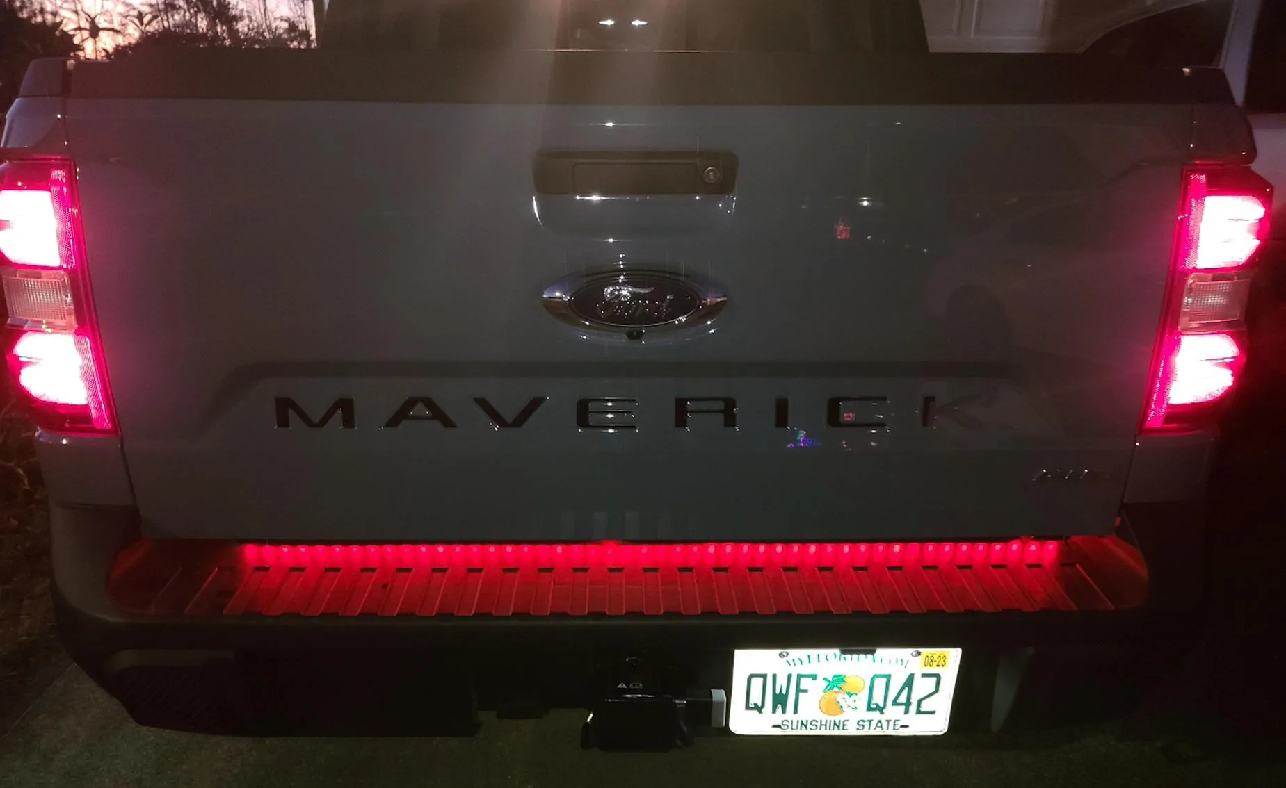

Just installed the tailgate letters and the lightbar today.
Question? How do you lower your spare tire as the light strip seems to block the hole, I'm still waiting on my Hybrid but my dealer has EcoBoots I didn't see enough room for strip so I guess you'd have to peel it off to change the tire
Does your tailgate light bar work across all functions? namely brakes and turn signals? i see you got running lights working. Reason i ask is because i recently installed one tapped directly into taillights and can't get it to function properly even after testing and verifying.
Yes. It was a plug and play, however, I did have to tap into the reverse light. I ended up removing it because it turned off all other functionalities such as, reverse camera, blindside indicators and something else I believe.
