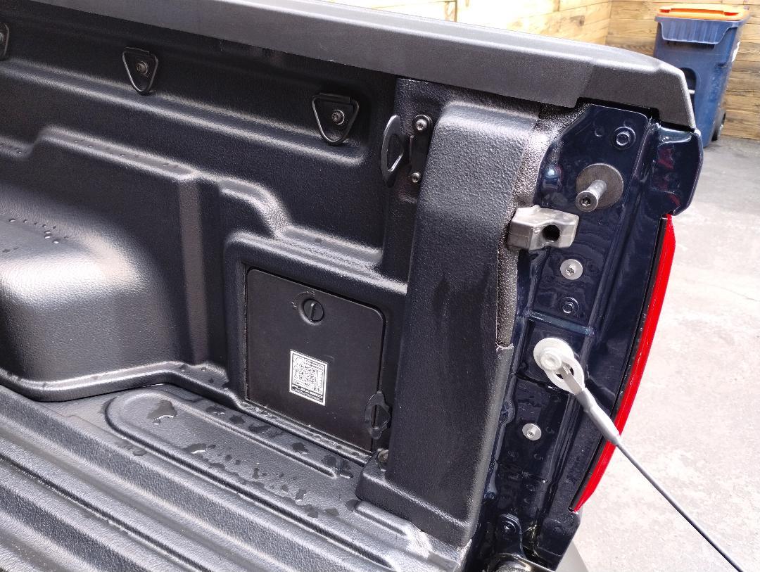

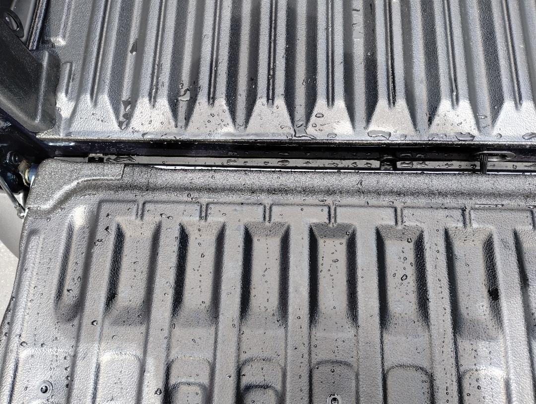

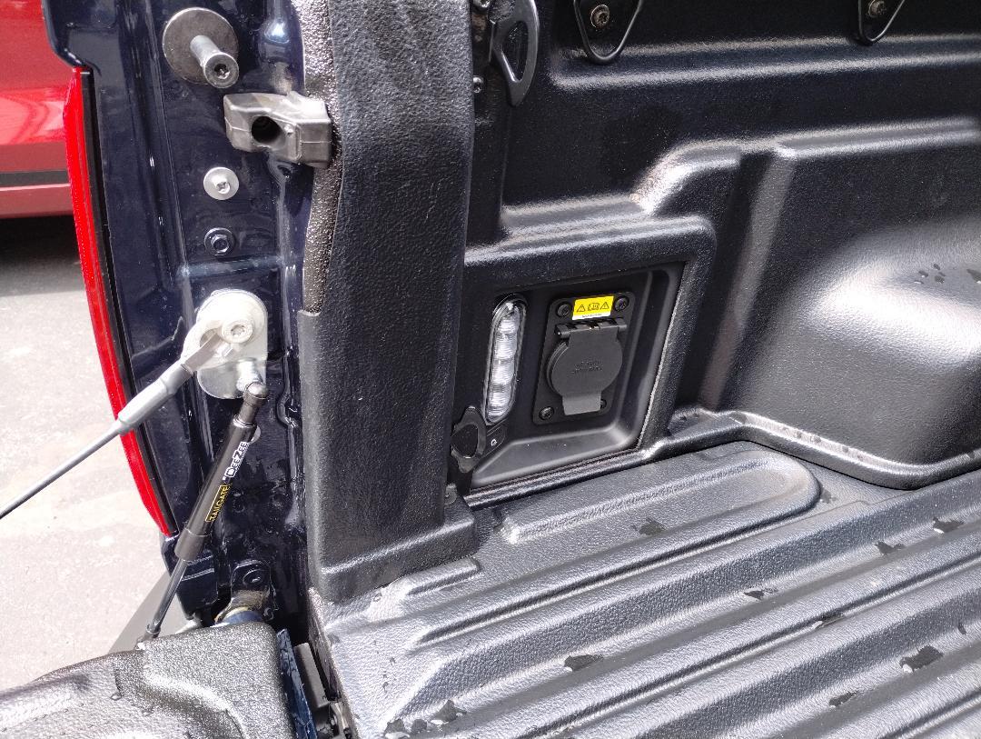

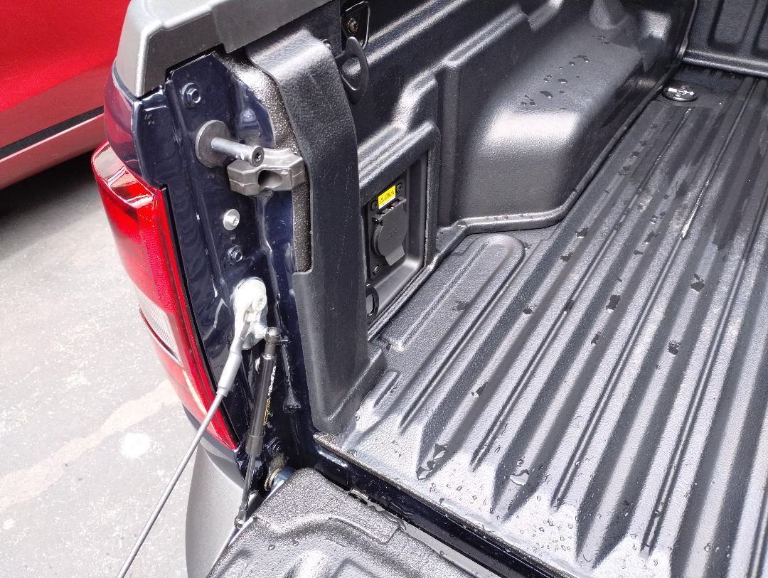

I figure you are referring to the DIBL over top of the Rhino sray in..
Even though the Rhino spray color closely matches the drop in bed you can see the difference at the back of the bed body. The Rhino covers a few more spots than the drop in. On the tailgate it is hard to see but the Rhino covers the full tailgate whereas the drop in liner is about 2 inches up from the bottom of the tailgate. The Rhino should protect the bed from scratches from the drop in liner. Like I said it is a tight fit but it does do in without any cutting down of the side of the drop in liner. Only around the LED light fixture did I remove some of the DIBL material and by the two places where they provided a support mounting bracket.
This is not an hour long project like the dealers claim. I spent a half day getting it all in and lining up and drilling holes in 90+ degree weather. I tested fitted parts first, then removed and reinstalled. Tyger 3 piece folding cover took me about an hour being careful and slow with it. It leaked at a hand car wash but I expected that.

Thanks for showing picture. My dealer wanted $265 labor to install the dibl. I’m 80 and decided to do it myself. Of course the hardest thing for me was cutting the holes on both sides. I ordered a jigsaw and it did ok for part of the way but it would hit something and I couldn’t go any further. What did you use to cut it? I did get the passenger side done but it wasn’t easy. The heat index in Georgia today will be around 110. I did use a box cutter but it was slow. Any suggestions would be helpful. As far as a spray in liner goes I had one before and after a few years the color faded. I hope this dibl doesn’t. Thanks, Ronnie

I cut the holes with a jig saw... Measured about where i had to cut temporarily installing pieces and then pulling back out to cut holes and retesting.. worked okay with just a jigsaw
