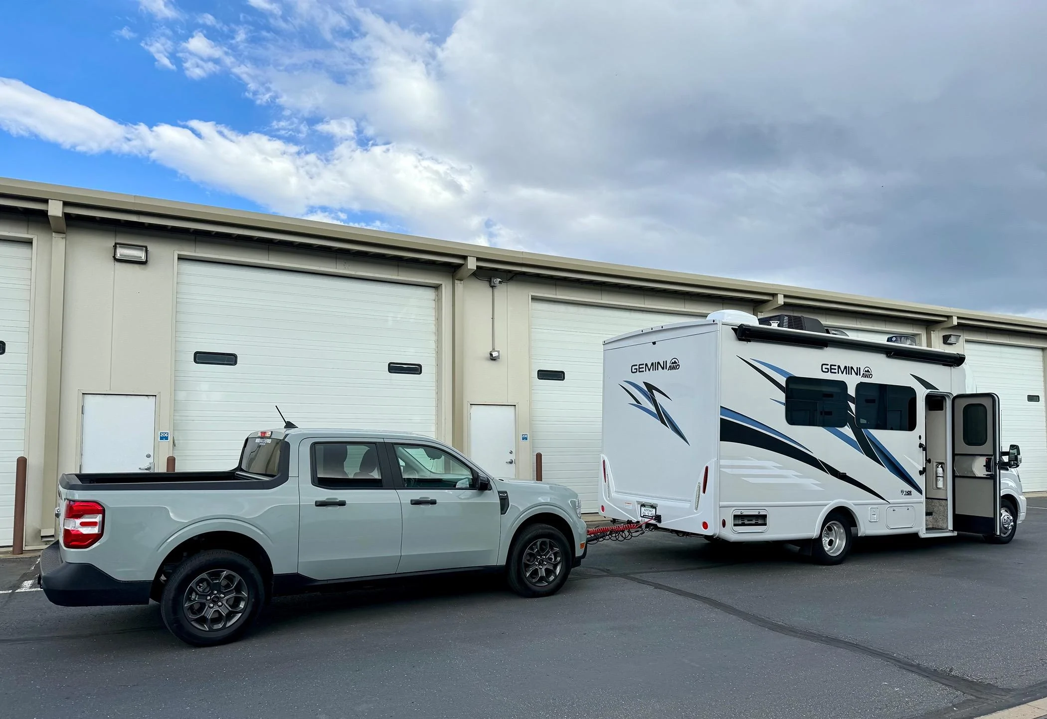

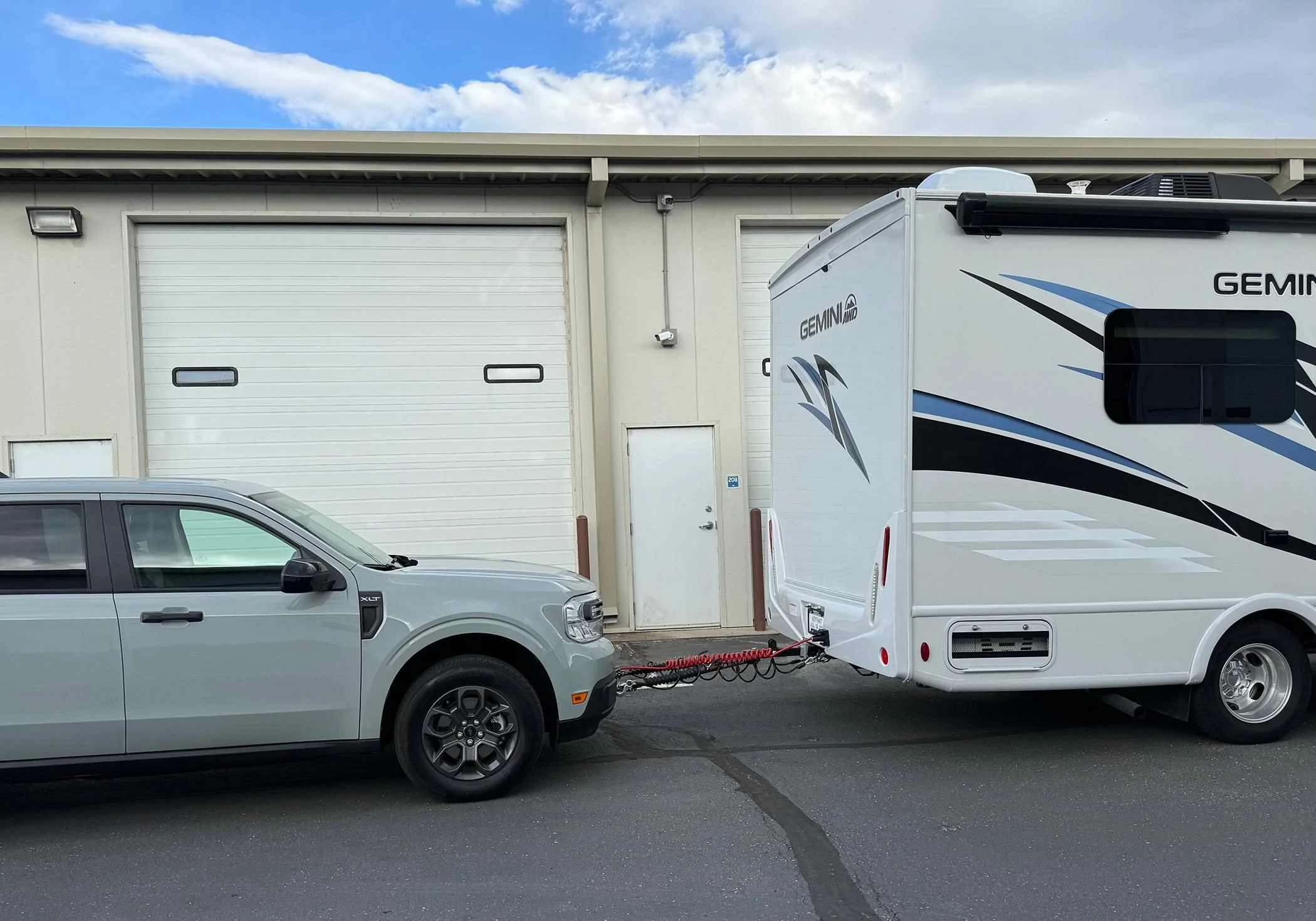

Anyway, we had our Demco baseplate and wiring kit installed on our newly purchased 2024 Maverick today. That choice, over Blue Ox products installed on 3 past Class A RVs (2 of them DPs), was based upon information shared on this discussion board. Still using our Blue Ox Avail tow bar, of course, which hooks right up to the Demco mounts. Still using our RVI2 brake controller too. Most important to my comfort is the fact that we had the work all done by the company that did the successful installations on 3 different Jeeps in the past. Completing their installation today, a lead tech went through the connection and Ford instructions with me step-by-step as we hooked things up for the first time and tested things. I'm a capable reader, but I know how easy it is to miss one tiny tip among the many details... but I gotta say that the process may have been even easier than my Wranglers of the past. Well, except for the special caresses required during multi-day trips. Anyway, it worked fine on the way home today, and I feel prepared for our first trip in our down-sized rig next week. Sure hope the gremlins described in this thread don't visit us along our wanderings!
PS: I know: I need to change the angle a little using a 3" drop hitch from Blue Ox I have from our first RV installation.
