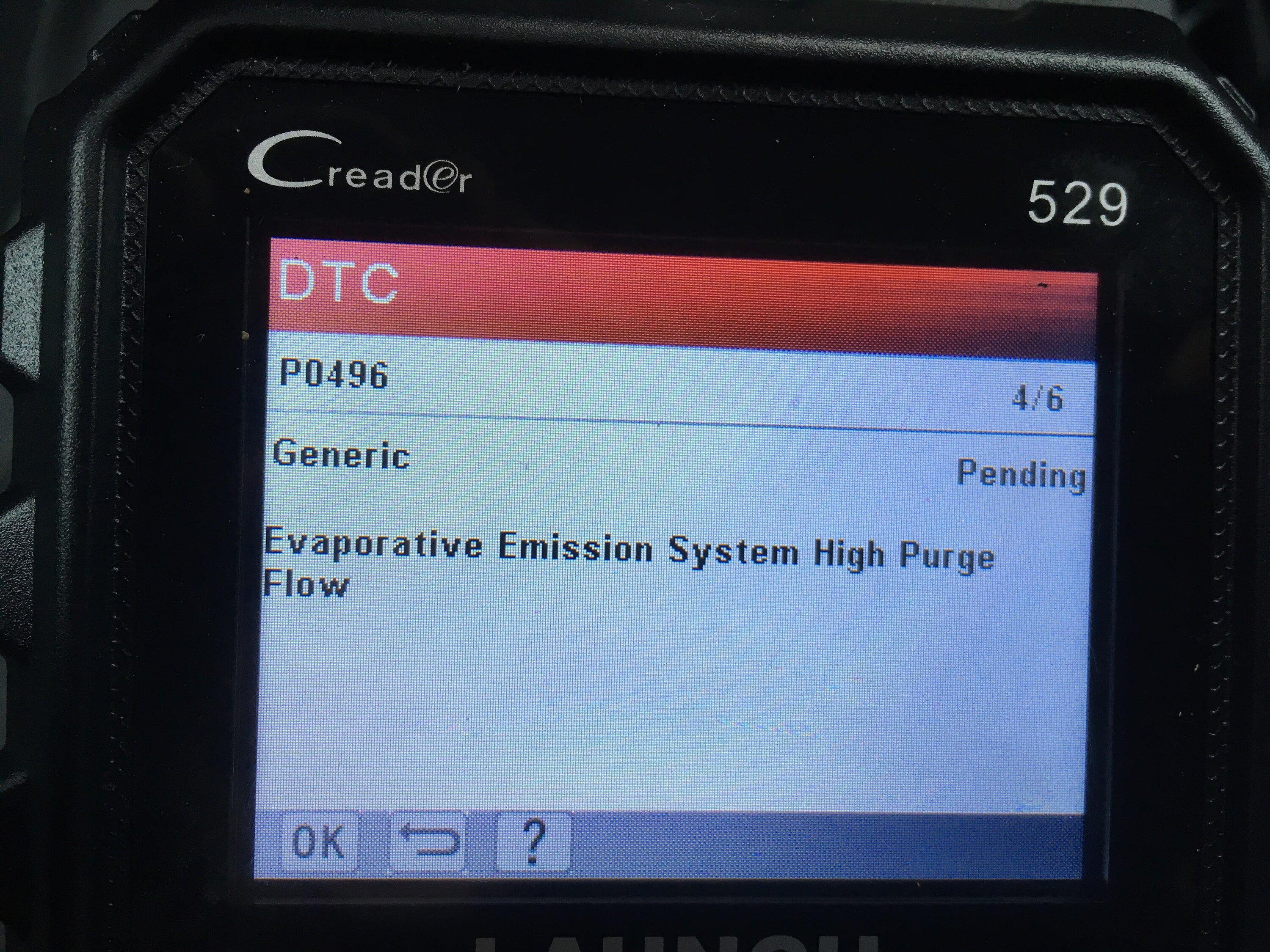

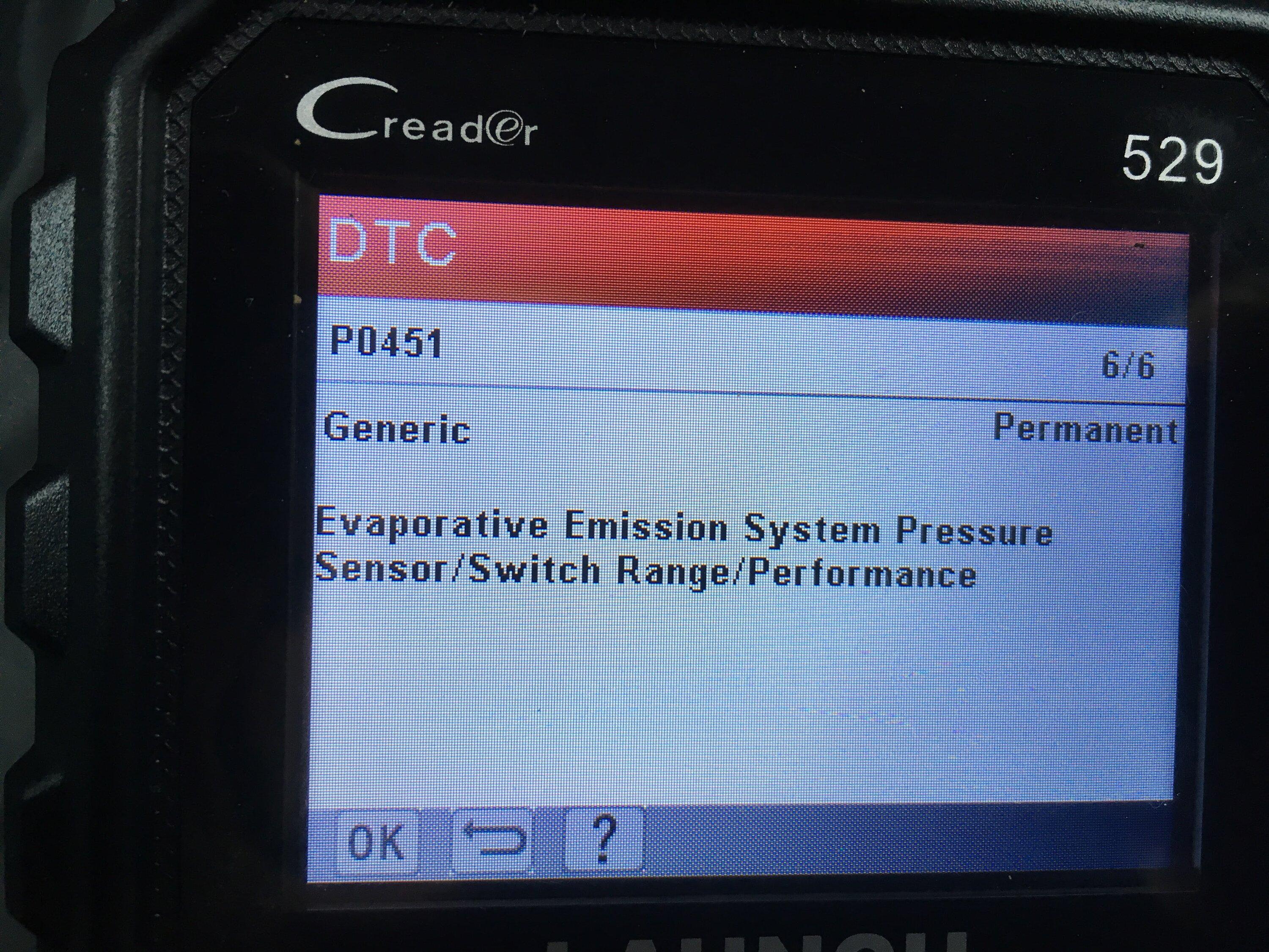

I hit the same issue with a p0496 last month at 39k miles on my 22 Lariat. Ford replaced the purge valve and this was not covered under powertrain warranty. Today, 15 days later I get p0451. This looks likely the same problem. Does that sound probable?
