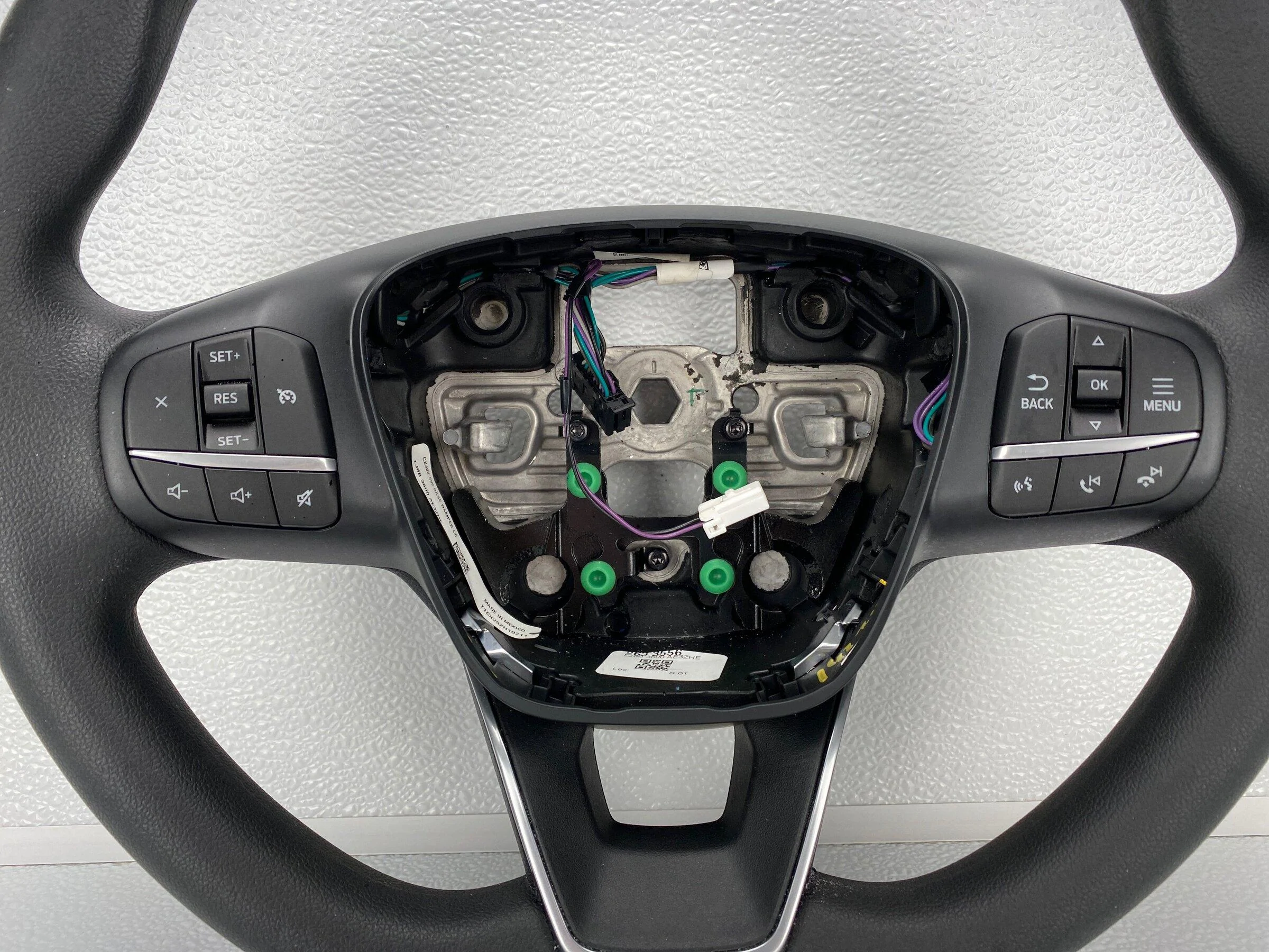

Saaaame thing I ended up doing LOLI purchased a steering wheel with the adaptive cruise by mistake and can confirm the sccm line will not program correctly. I do not know if anyone has found the correct line for the adaptive switch pack. I am now awaiting a non adaptive switch pack.
Replacing the left-hand cluster isn't difficult - just take your time so you don't bust the trim. It's a bit of a pain to work loose without feeling like you might break something.
