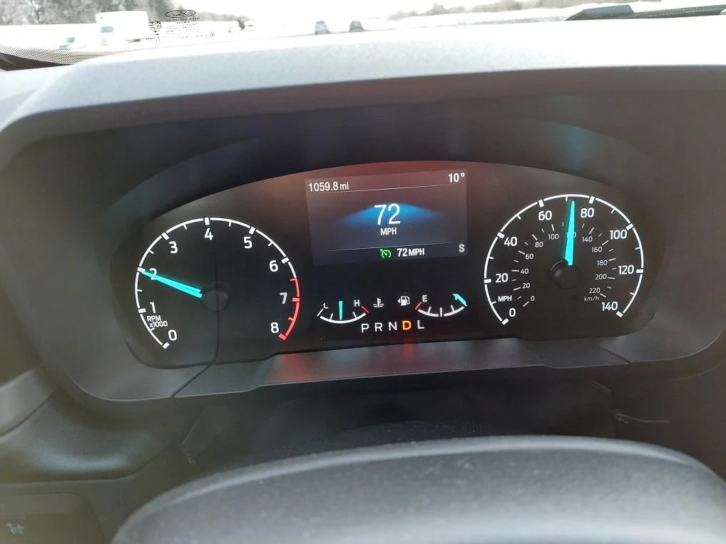

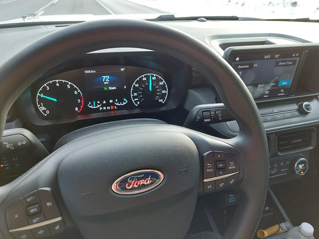

Just confirming that I now have Factory Cruise on my 2022 Maverick XL. Here are the pics. You can see it actually on in the photos I took on the way home today after spending the day over with
Tyvemattis.
He was having a little trouble at first but it now works and everything functions 100% and is probably the best bang for the buck. Its a learning curve and I think he was glad to try it on on my truck too.
Tyvemattis is a really nice guy and I probably could have stayed there bull$hitting with him for another 6 hours. Lucky I live close enough to drive over to him. If he gets this setup going where he mails the laptop and data cable out with instructions to those in need please know he is spot on about what he is doing and this is for real.
I guess I am one of maybe 3 now with factory cruise on the XL Maverick.
Thanks Dude !

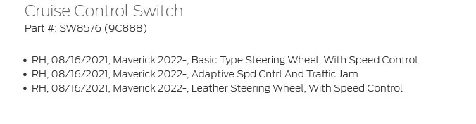

Edit (January 20): These are confirmed the right part numbers, and are working correctly on my XL hybrid.
OK, for those interested, here are what I think are the correct replacement parts, if you are only replacing the switches. (source: https://parts.ford.com/shop/en/us/steering/steering-parts-other/steering-wheel-13291447-1) The switch parts are found in "Related Parts."
Ford Maverick Factory cruise control enabled on XL with Forscan and Escape steering wheel LH Switch
Ford Maverick Factory cruise control enabled on XL with Forscan and Escape steering wheel RH Switch
So, PNs SW8579 and SW8576. But don't pay the full price at the site referenced above! At SuperiorFordParts.com, the two of them together come to $72.55 (plus reasonable shipping).
So, I am ordering these, and will hopefully post here in a few days whether it works out. Use at your own risk.
Tyvemattis.
Thanks Dude !
Thanks to the both of you, Vespa and Tyvemattis, for leading on this XL hack on a brand new vehicle. Thanks to Tyvemattis for putting all the separate parts, tools, and tech together, and for Vespa to be trusting enough to verify it with him. Two very cool dudes. :cool:
