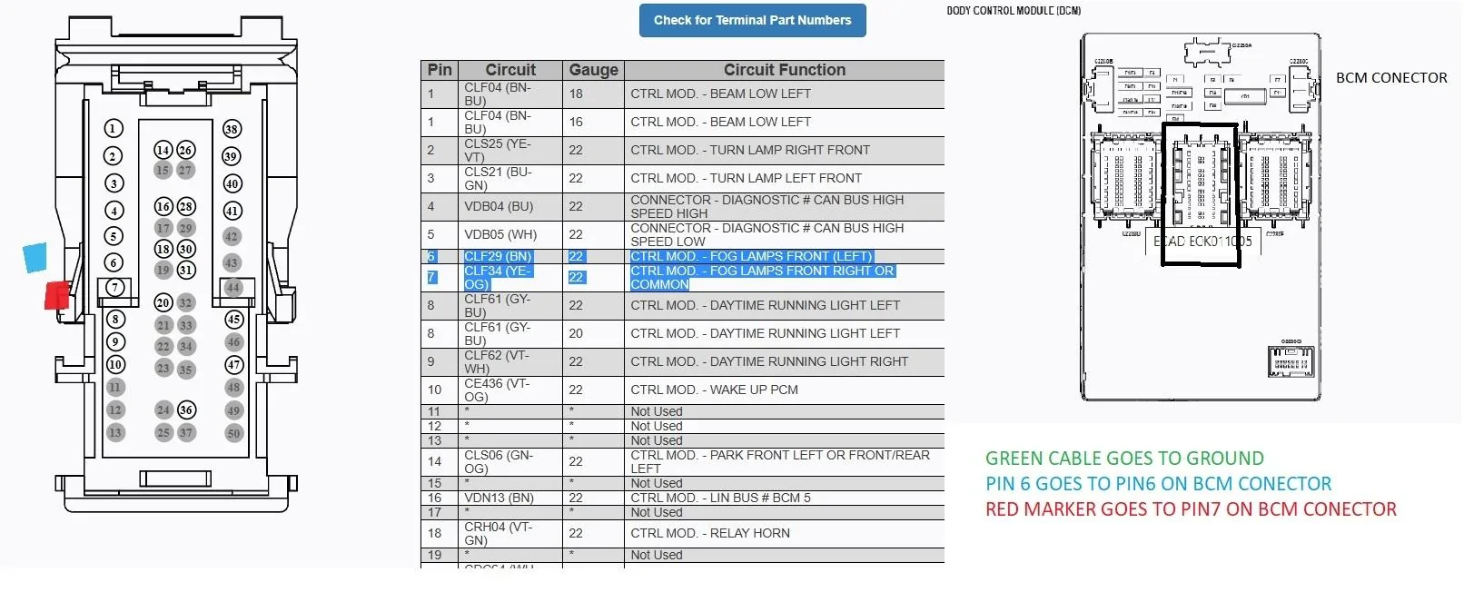

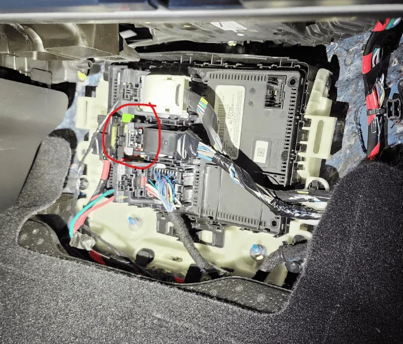

Hi @Vtech87pr1, great tutorial. I had purchased and installed my DD fog light kit but was a little disappointment at the switch it comes with and was hesitant to install it. And then I came across your post and I can't describe my excitement. Right away I went online and ordered the switch and the leads for the BCM connector. I'm currently performing the install and ran into not being able to unlatch the BCM connector from the fuse panel. Is there a trick to it? I tried pushing the lever but won't budge. Help! :). Below is a snip of your own picture with markings on the latch I refer to.
In the middle of the lever there's that latch you need to push and then you can pull back on the lever.
Got it! Thanks.
Will be posting pictures soon as that is probably the part I consider the hardest so far. I'm very handy and comfortable around car electronics but I was panicking of thinking I could break that assembly and cause myself a bigger headache.
Thanks again.
