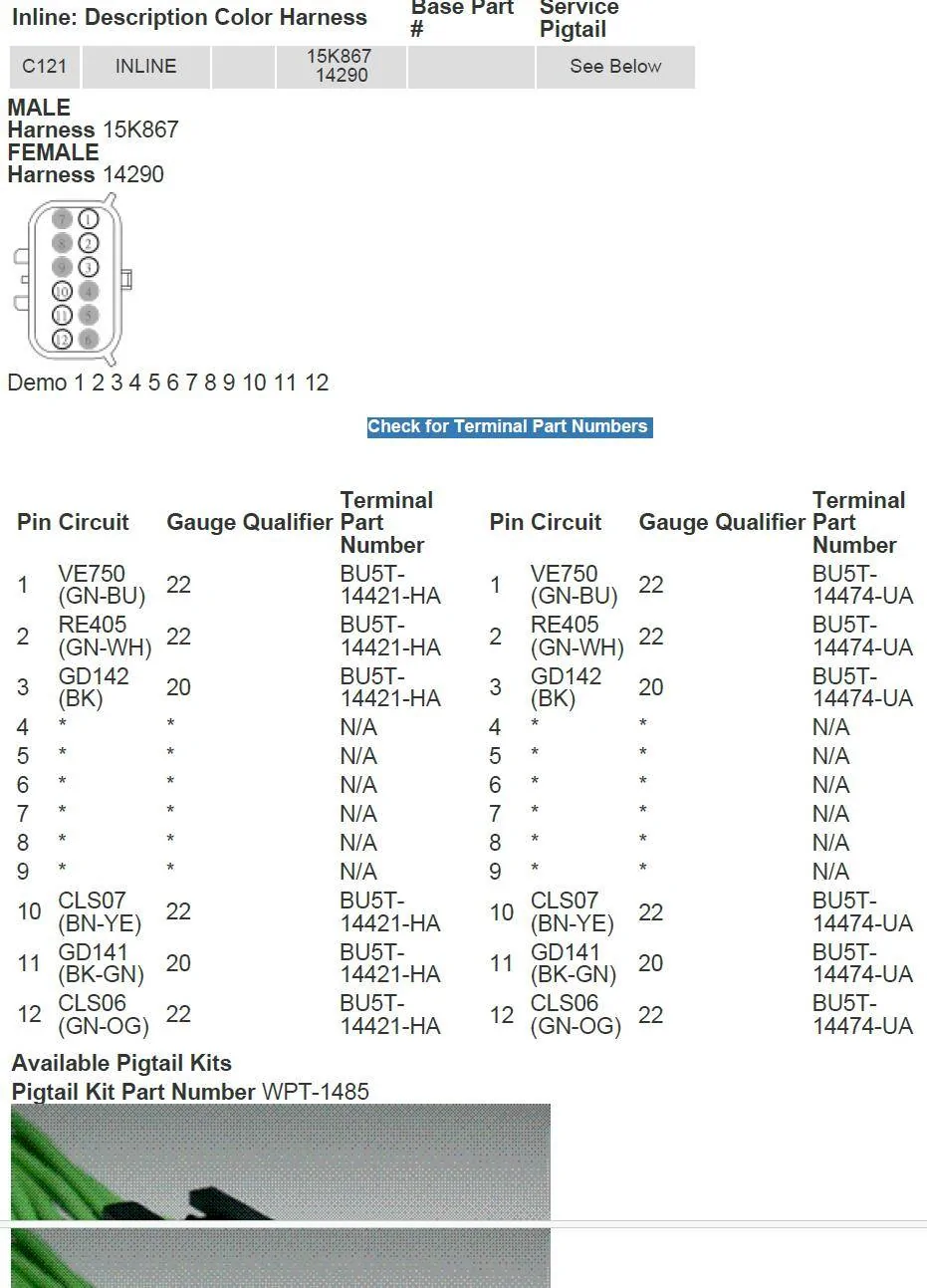

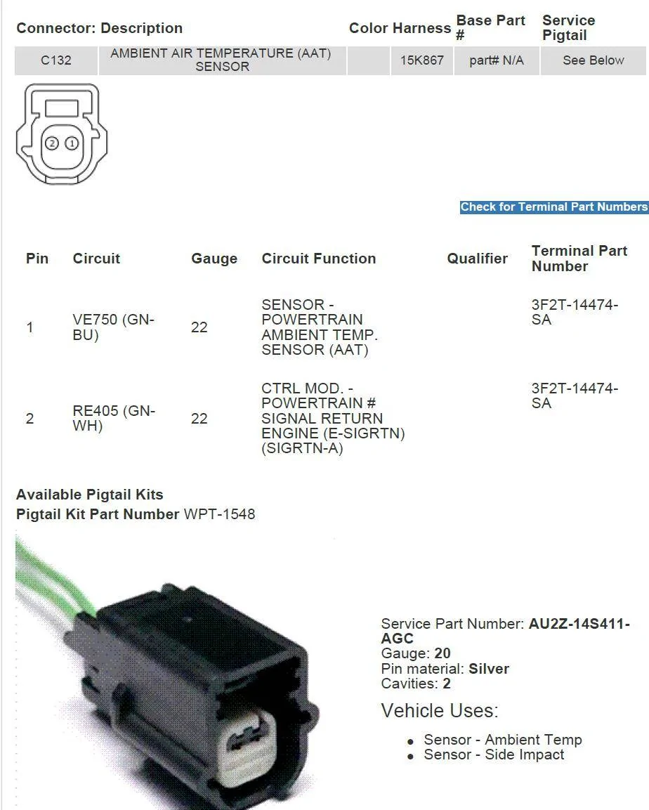

Similar to what leads me to join (Google searched). Have code for outside temp sensor P0073 Ambient air temperature sensor high output. Verified sensor is plugged in and no wire chafing, also verified obd2 port is seeing correct temperature through pcm with Bluetooth scanner Torque app. Guessing 2nd trip to dealer is needed (first is other thread about brake lights), starting to get old sending it in to dealer already with just 1k miles.
