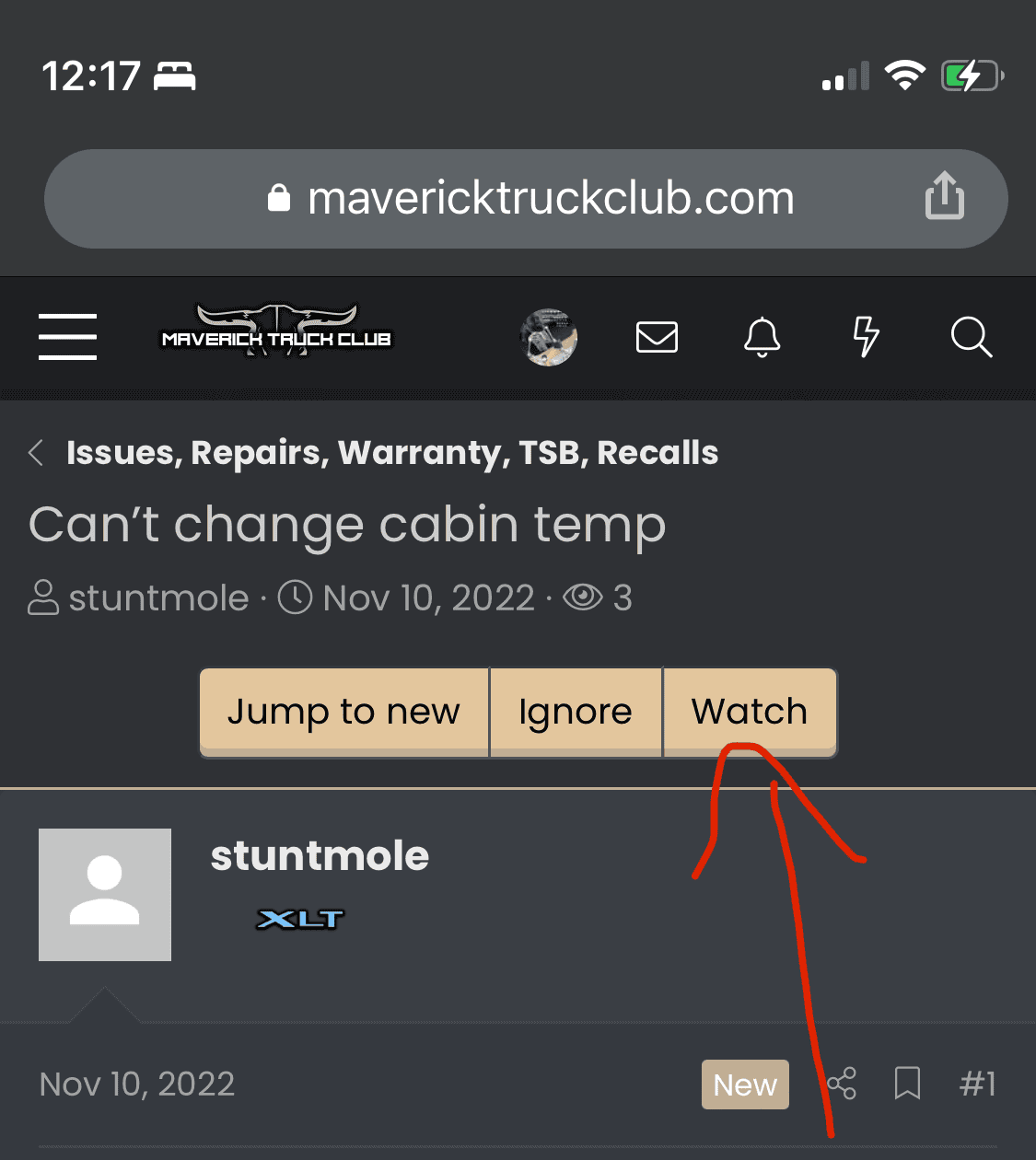

Inch-resting (commenting to be able to read further replies)
FYI you can get a notification of all comments by hitting this button (you can do this on any thread individually), you don’t need to add a comment.
