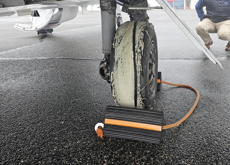

This happened on take off and was out of balance. When they landed three hours later the crew didn't know anything happened. Until I pointed it out to them on a post flight. The crew even stated it was one of their best landings..

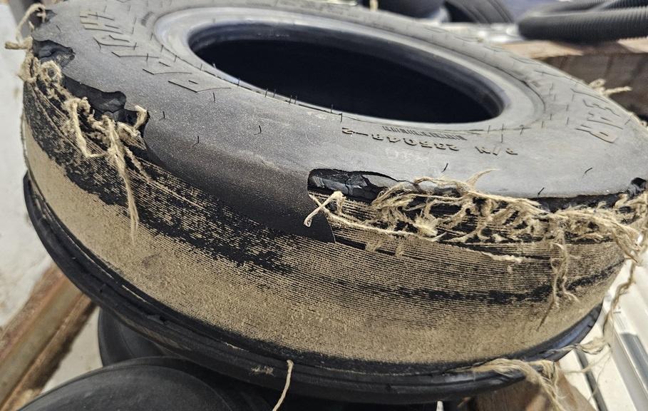

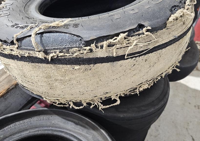

This is what 14 ply tire looks like with the majority of the ply's not longer there. This tire is service 220 PSI. If it's off the aircraft when being service you have to service it in a cage for safety reasons.
