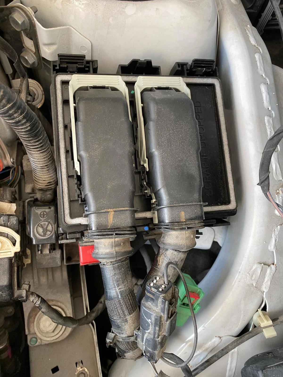

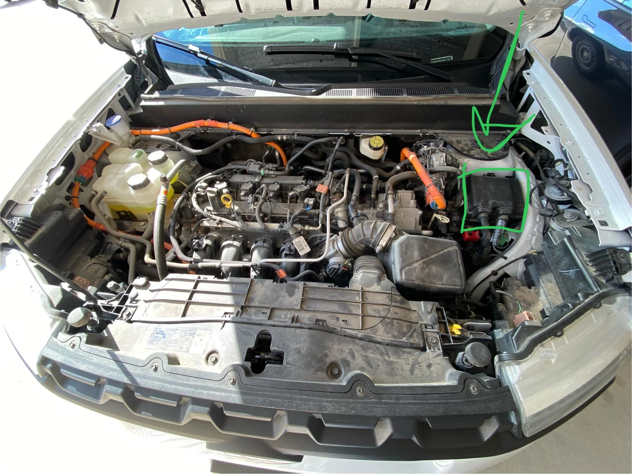

The fuse box (service tech liked to call it a juke box) went bad. I was told it had some burnt wires under it and they also found some other burnt wires somewhere else that connected to the fuse box. Under the hood I was able to find the part that was replaced and I took a picture of it for all of you.
Service tech said they also replaced the BCM and did all updates to be sure it was not update related.
For the simple, some wire connections got too hot and melted or fused open which caused something else to go wrong.
