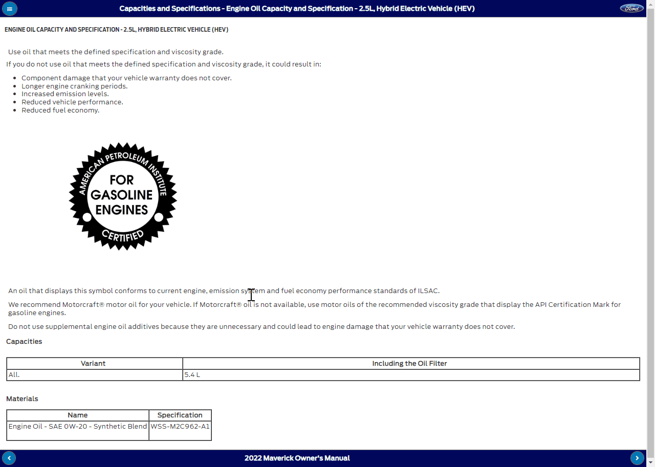

Hi All
Just realizing that the owners manual on the ford website calls for "Synthetic Blend" for the 2.5L and the manual from the FordPass app says "Full Synthetic"
I am currently fighting with the dealership service department about this because they are telling me my "premium maintenance " plan will not cover full synthetic because its not specified in the owners manual.
Any thoughts? Anyone Else dealt with this?
Ford Maverick Engine Oil Type Owners Manual Version Mismatch From the Ford website
Ford Maverick Engine Oil Type Owners Manual Version Mismatch From the FordPass a

Both versions recommend specification # WSS-M2C962-A1 which corresponds to Motorcraft 0W-20 Full Synthetic. There's always the chance that they tried to switch it from full synthetic to synthetic blend but forgot the spec #, though if I had to guess, it's the "blend" wording that's in error.

I do think that it is an error in the owner's manual. 0W20 is likely going to be full synthetic?
If they sold you a maintenance plan that doesn't cover full synthetic, that could be an issue (but there may be some exception before 0W20 is only available full synthetic???)
It is not an issue I have dealt with before. Either the plan should accept 0w20 because that is the only option. OR, the dealership sold you the wrong plan. Maybe you have upgrade the plan? Or have dealership pay the difference?
(Or maybe they'll do it but ask you to pay the difference.....but that would really only make sense if you bought a regular plan (where synthetic blend and then insisted on full synthetic)

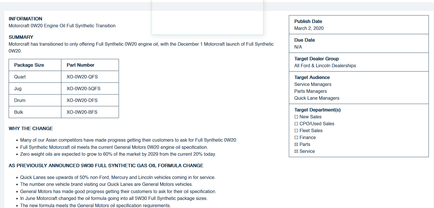

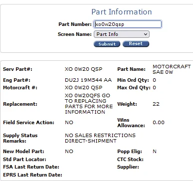

Sorry, your info is old and incorrect. A couple years ago Ford stopped making semi-syn 0w20 and only makes full syn 0w20. If you are buying semi-syn, then it is New Old Stock.
Ford Maverick Engine Oil Type Owners Manual Version Mismatch 1661399280209
https://wwwqa.motorcraft.com/us/en_...oils/sae-0w-20-full-synthetic-motor-oils.html
List is $9.29/QT
And it is available from Motorcraft oil distributors in bulk oil at a reduced price.

So I believe the blend suggestion is for older 2.5L hybrids like my 2015 Fusion and 2017 C-Max. Those manuals recommended WWS-MC947-B1 spec oil. This matches the 0w20 blend as well as the rev 6/18 synthetic bottle and is SN/SN+ GF-5.
The 11/19 rev bottle states WSS-M2C962-A1 and meets API SP and GF-6. WSS-M2C962-A1 of course supersedes the older spec so it's fine in the older engine's but I don't know about warranty if you put 947-B1 in the newer 2.5L engine that is asking for 962-A1.
My C-Max is out of warranty now so it does not go to the dealership for service, though that may change for the next service. I don't know if they still stock the blend or not but I would not be using it in the Maverick 2.5L engine.

3/2/20 Ford announced the change, as I said before, Ford only offers 0w20 in full synthetic which is used in hybrid engines.
Ford Maverick Engine Oil Type Owners Manual Version Mismatch 1661401464202
