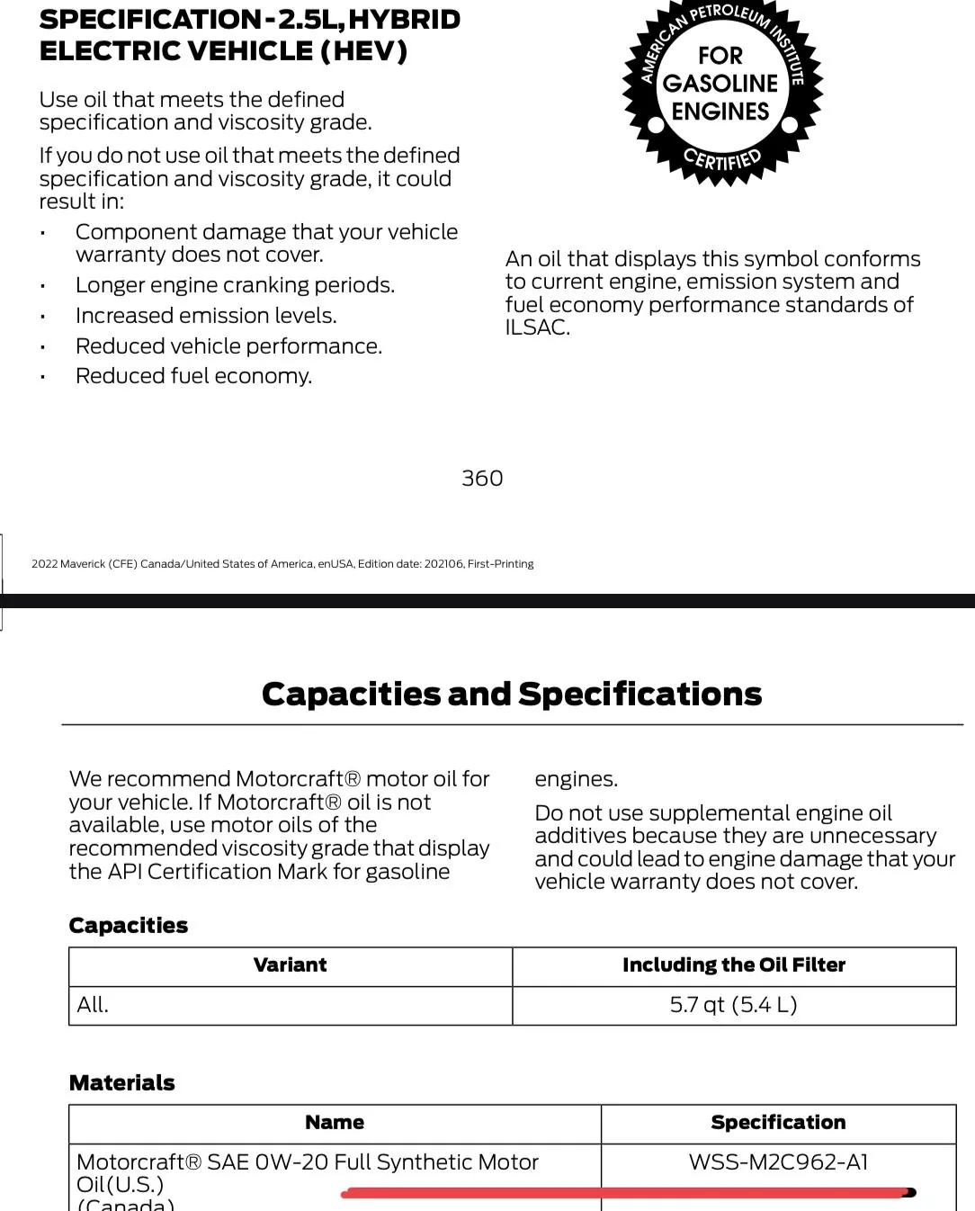

Per the manual -
2.0L: 5W-30 synthetic blend or 0W-30 for cold climates WSS-W2C963-A1
2.5L: 0W-20 full synthetic WSS-W2C962-A1.

Doesn't matter if it's syn-blend, or full-syn.
As long as it meets the latest WSS- Ford oil spec, that is all that matters.
In a hybrid it does matter. Owners manual call for full synthetic and a specific WSS that differs from a semi synthetic.
No, it is an oil recipe choice, independent of any Ford WSS- spec.
The base oil could come from Unicorn tears or bat wee for all we care, as long as it performs in the additive package they use with it, to meet performance.
(Yes, they want to suggest you use their Motorcraft brand Name, which happens to be a full syn.)
The word "synthetic" is descriptive of that particular Motorcraft brand oil formulation ONLY.
Again, it is not part of the WSS-M2C962-A1 spec.
Any random brand of WSS-M2C962-A1 spec oil on the market COULD be semi-syn if they really wanted to (Pennzoil Gold comes to mind although I think SOPUS is giving up on that one for economics reasons.)
Most don't go the semi-syn route because it no longer makes economic sense to put in stronger additives to counteract the effects of some GroupII base oil's effects and still meet SP/GF-6A/dexos1 engine test performance.
Doesn't matter if it's syn-blend, or full-syn. That formulation detail is irrelevant to the spec.
The only thing that matters on an oil container you buy is these WSS numbers printed there:
Ford WSS-M2C962-A1 (0w-20 for the Hybrid only)
Ford WSS-M2C961-A1 (5w-30 for Ecoboost only)
Ford WSS-M2C963-A1 (0w-30, Ecoboost only when you might start it at below -10F)
This is like Fleet Manager training or something, trying to tell non-engineers and non-industry people what to look for, and what to ignore. (Ignore full-syn vs. semi-syn, WE DON'T CARE, YOU DON'T CARE).
