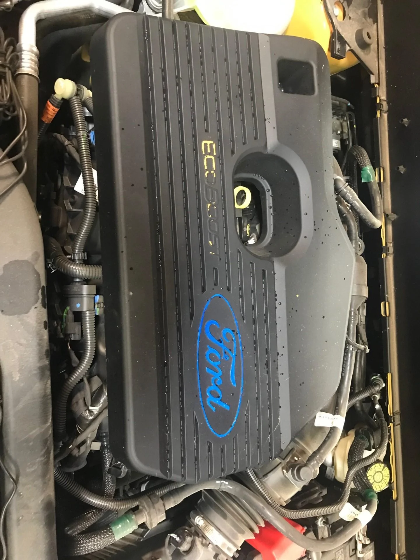

If anyone is looking to purchase an engine cover for a 2022 - 2024 Maverick Lariat 2.0 L Eco Boost, be sure to consider the following Ford Part Numbers (P/N):
- Engine Cover P/N K2GZ-6A949-B 1X
- Stud-Ball P/N AA5Z-6N958-A
- Stud P/N -W714647-S450B
When ordering an Engine Cover the two required fasteners are not included. You have to order them separately. I learned that the hard way.
