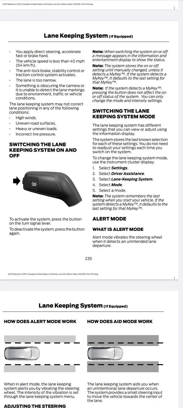

I saw something awhile back about lane centering on a xlt. I have a 24 hybrid xlt when looking through for scan I saw something about centering do I need anything special for it to work with the lane departure system?

Do you have a button on the end of your turn signal stalk?
No I do not but I have the lane departure set up to work without that button. If I need the button for it that’s fine with me

If you don't have the button at the end of the turn stalk then your vehicle does not have CoPilot360. No amount of ForScan changes will enable this. Your vehicle lacks the physical hardware.

You can install the stalk and enable Lane Keeping with FORScan, but for Lane Centering such as on the CoPilot Assist/2.0 then you need the full radar setup for adaptive cruise.

I have lane keeping working without the stalk. But for centering I understand the need for the other stuff.

I saw a video on YouTube where a guy added that stalk on his XLT and enabled it with Forscan.
That was for lane keep not centering. Unless you saw a different one. The install is easy. But I chose the option to use lane keep without the stalk cause I keep it on at all times anyway

You are probably right. Lane centering requires adaptive cruise control which requires the bliss sensor on the front. I think that only comes on a Lariat
