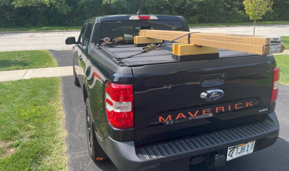

You are correct. Putting a lot of inward tension on them will cause the rail to roll inward, so no more pressure than necessary.
