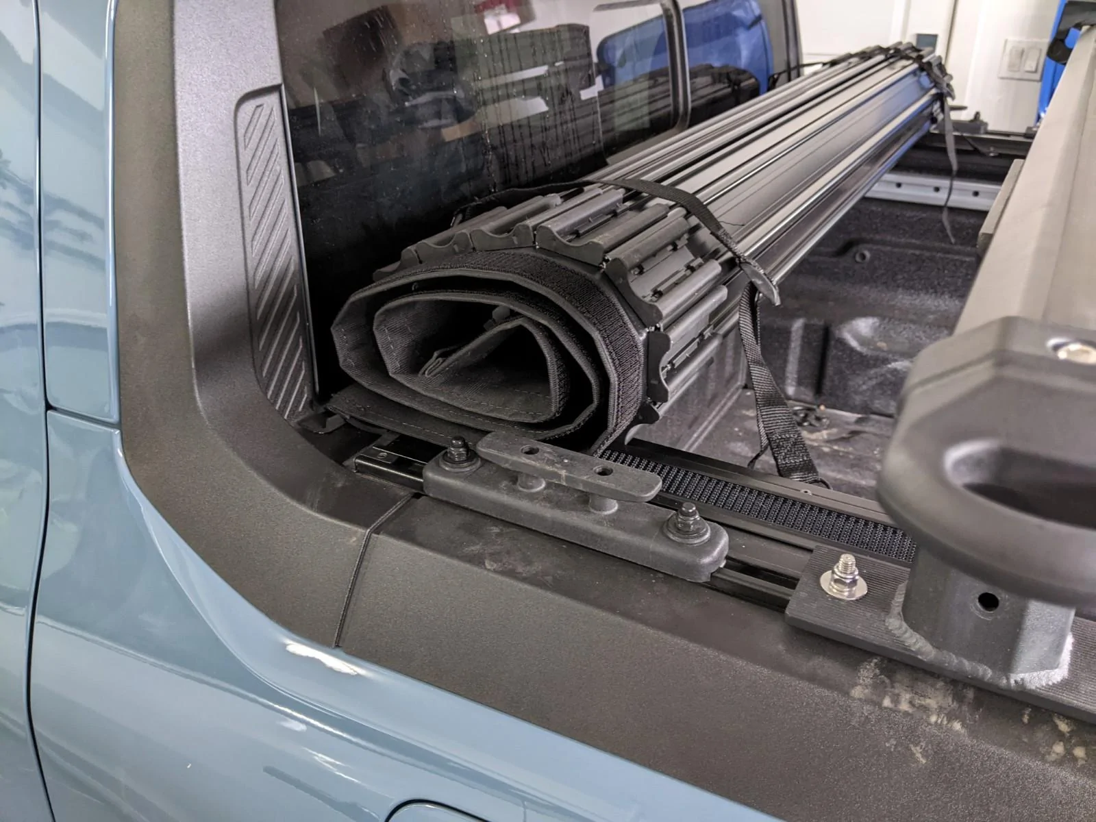

Is the bottom of this plate flat, could the bolt holes be elongated maybe 1/4"-3/8" inward to allow the stanchion to move further outward, and provide clearance for the roll-up?
HRG
Yes it is flat base. With the correct tools I think you will be able to modify the holes

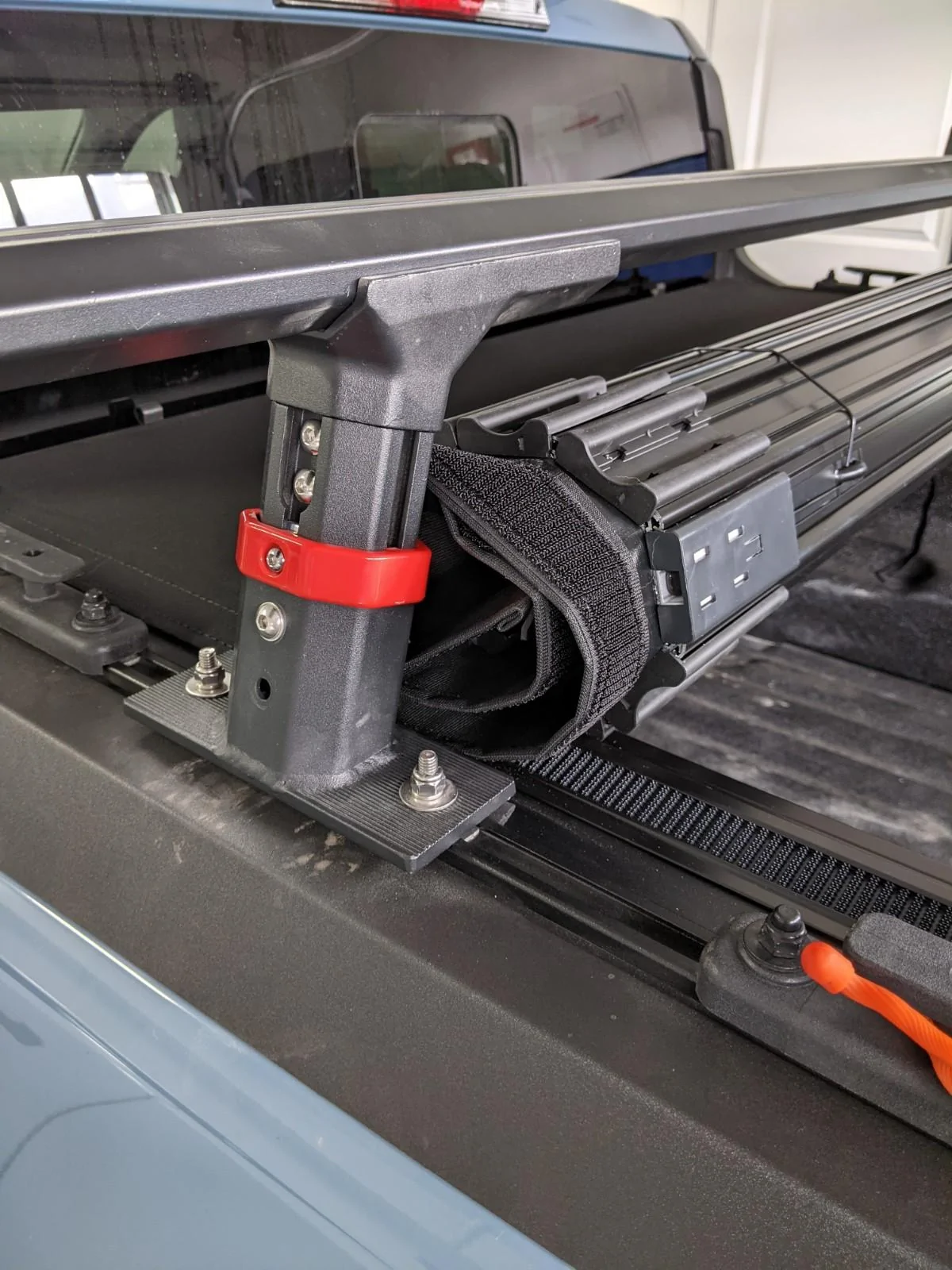

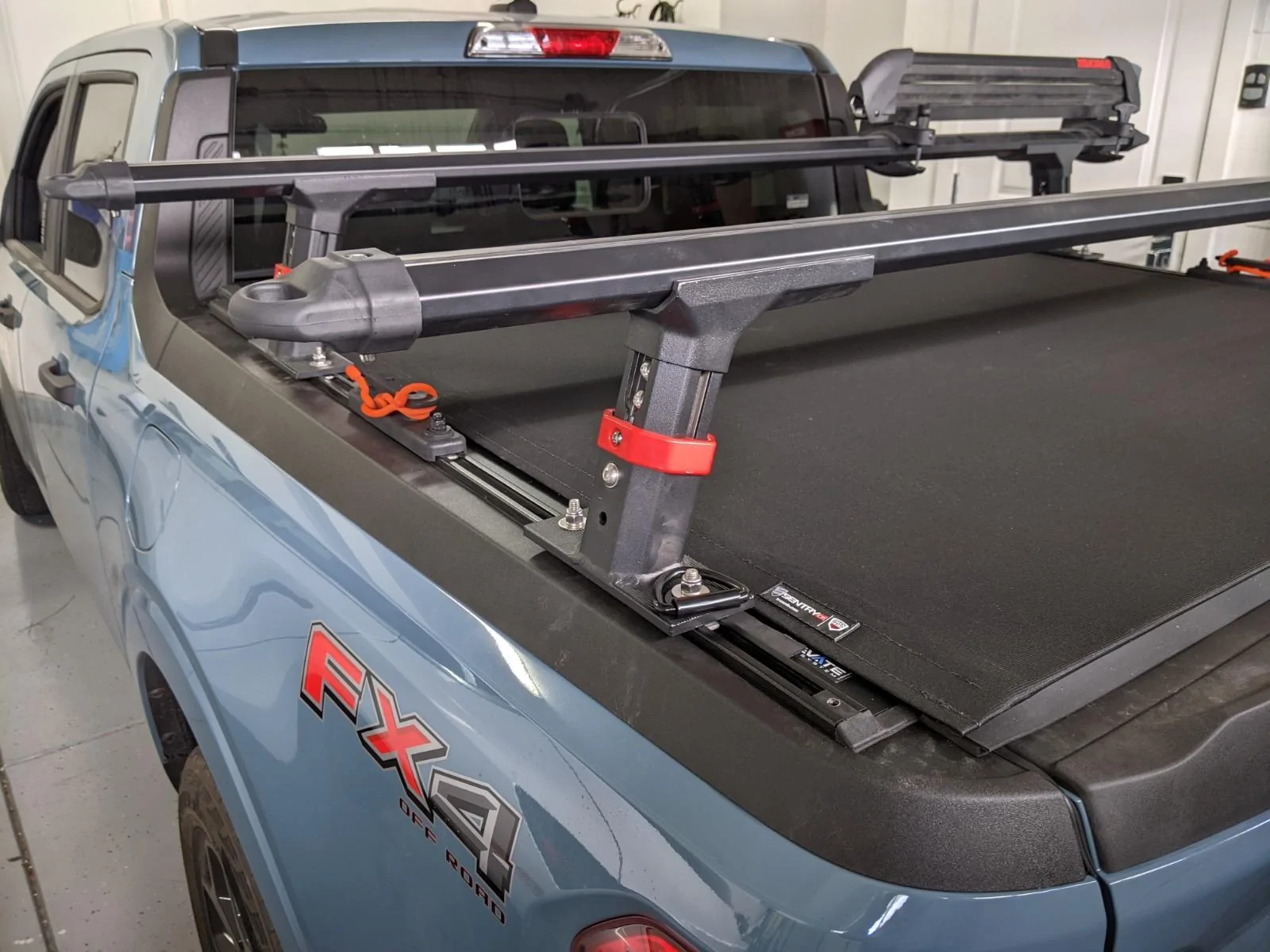

Got my Truxedo Sentry CT hard roll-up cover last night (800$ + tax thanks to this thread, https://www.mavericktruckclub.com/forum/threads/anybody-order-off-bakflip-com.5023/)
Spent ~2 hour to install the cover and adjust the racks.
Works as intended, only imperfection it that the cover rubs with the tower of the rack (the one closer to the front of the truck), but it can be pushed through.

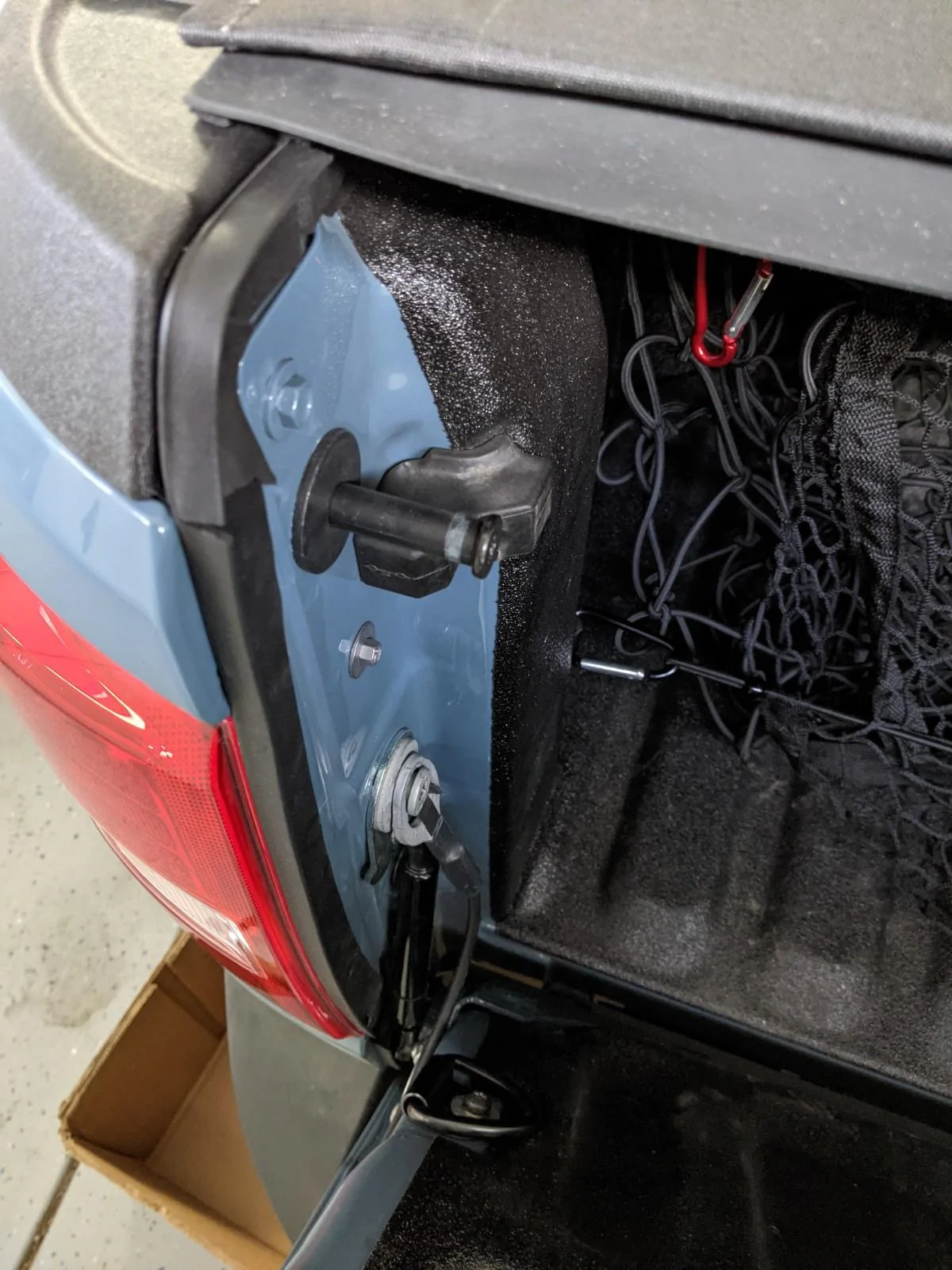

I end up having a lot of extra seals, and made myself some sort of weather seal at the tailgate.
I will be happy to answer any questions you may have in this setup.

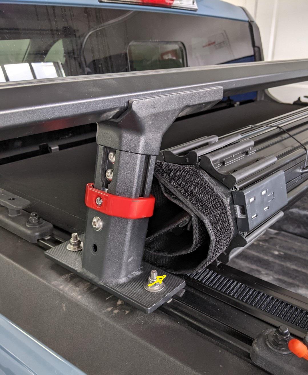

I have the sentry cover and TS rails as well but haven’t been able to fit the cover and rails on together. When I installed the cover without the rails it fits fine. When I put the rails on the bed it’s basically just narrow enough that the cover doesn’t fit correctly. Any tips or tricks on how you got this to fit? I tried for over two hours and couldn’t get it to work
You need to remove the thick foam from the rail of the cover, and replace with the thin foam that comes with the TS rail.

I saw that in the instructions about the foam on my sentry rails. The foam on the back was basically the same thickness as the thin foam that came with the TS rails. My rails were basically 1/4” off when installed. I guess the foam is that much thicker to make enough of a difference?
For me, the foam on the back side of the rail of the sentry CT is much thicker than the thin one.
Something like 2mm vs 0.5mm
HRG
So I did this drilling/milling with a local machine shop (made a 3/8" slot towards the inner edge, ending at 3/8" from the edge), now there is no rubbing with the cover.
I can open and close from one side of the bed without having to go to the other side to push the cover over the rubbing point.
