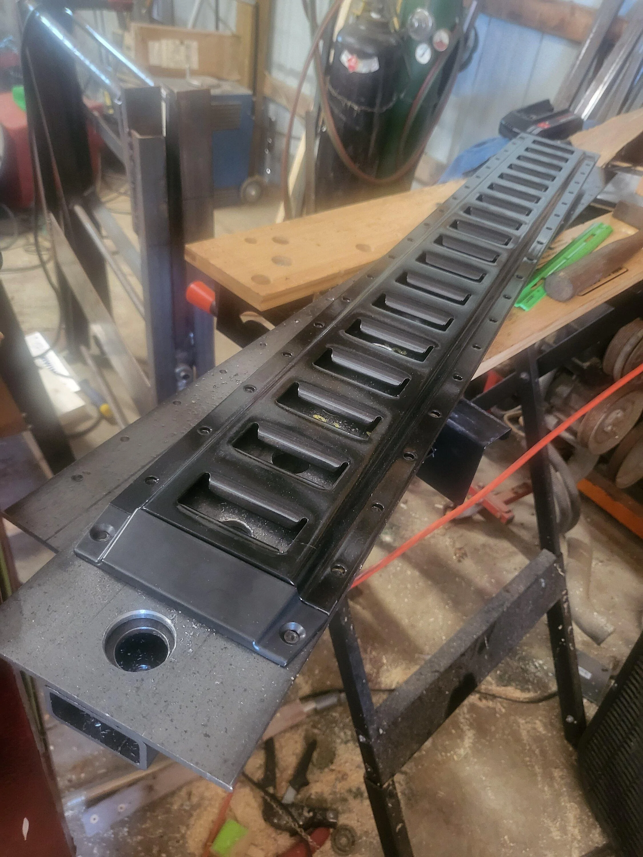

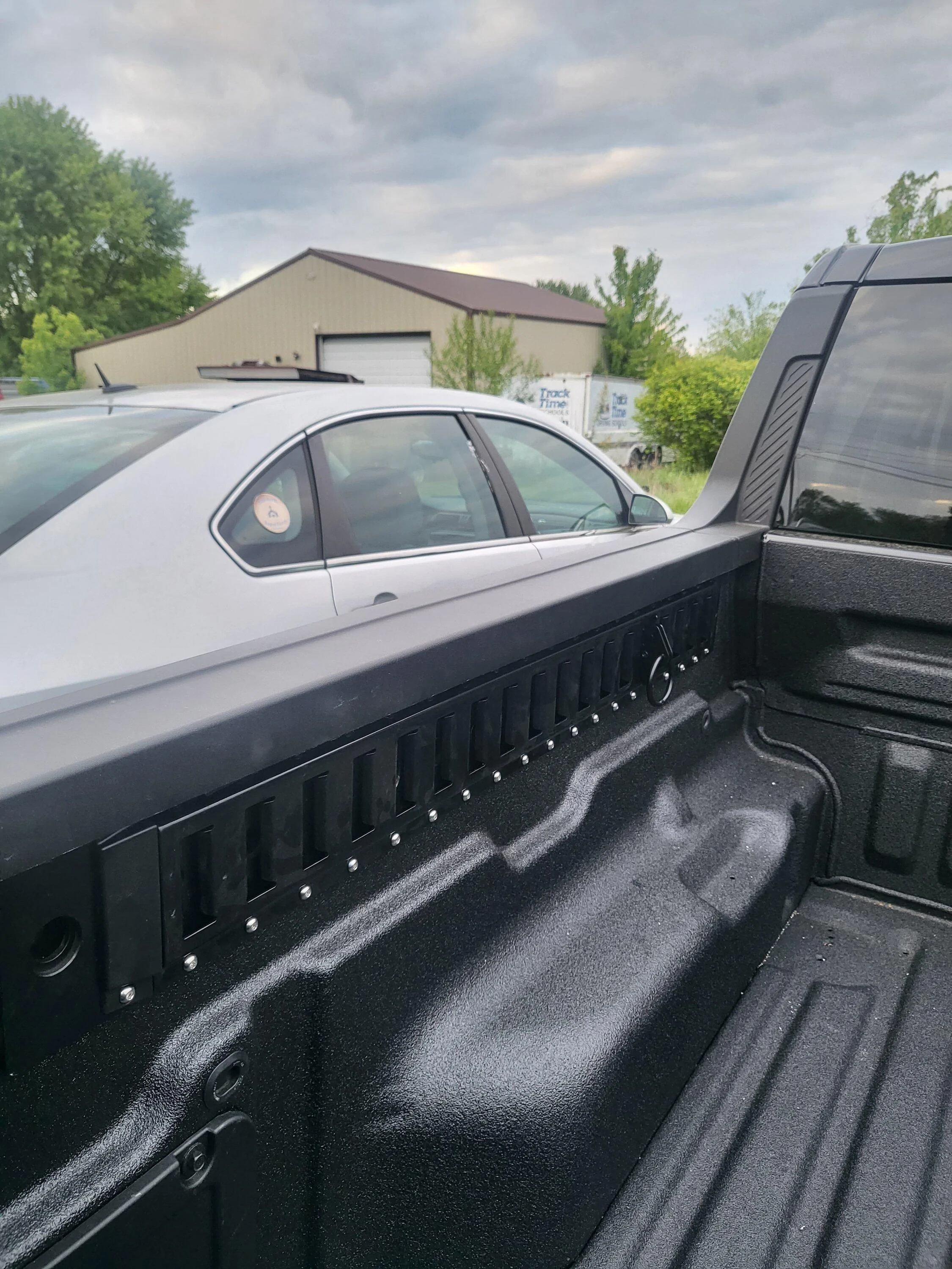

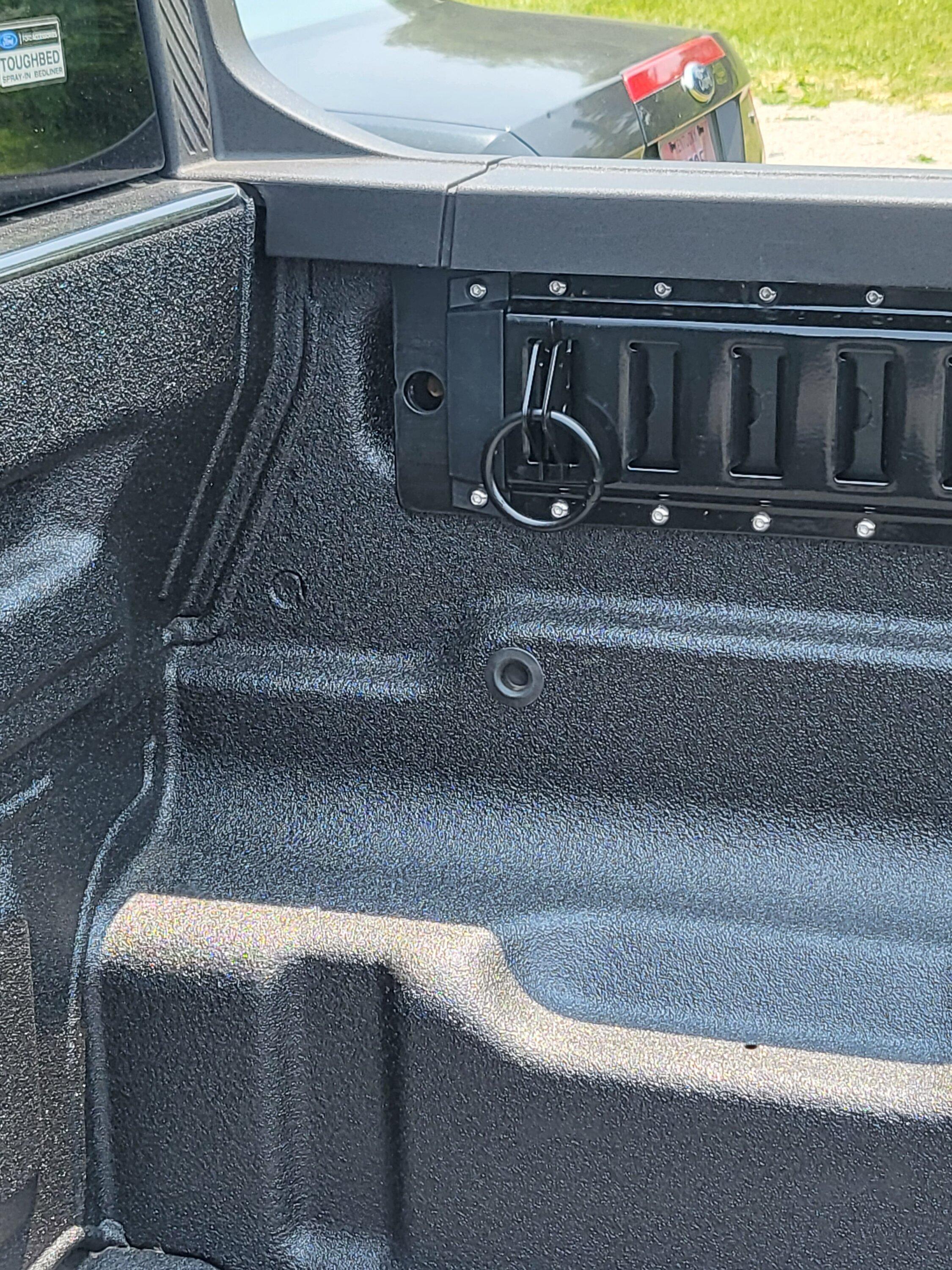

Here's more pics. I fabricated the adapters from 1x2 tube and some plate, it's bolted to the stock holes in the boxside with m8x1.25 and m6x1.0 bolts. The E-track bolts in place with short m6x1.0 button head allen screws.
