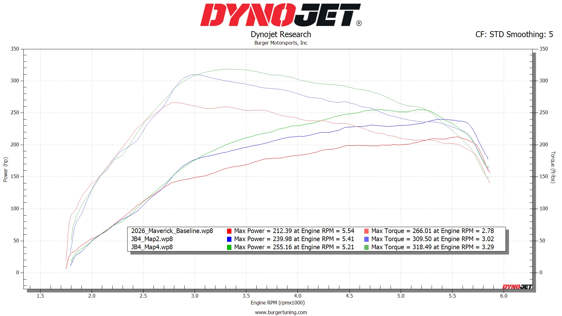

Ok guys I got it back!!!! This is fun holy crap you hit the peddle and it just goes. So they will have the 2025 up soon. I love the fact it’s plug and play nothing to flash and I can take it off for smog here in cali and put it back on after. They said it’s still an Alpha build I am dropping the peddle to the floor and sending them data.
Ford Maverick Dropping the Lobo off for Engine Tune. maverick_lobo_dyno

Thanks for the update.
Are you running through the gears in auto for their logs?
OR manual mode and 3rd gear pulls?
318 torque on 91 octane? (+52 over stock) Interesting torque Curves..that peak torque moved further out to 3k. That linearity of torque on Map4 Looks impressive. 250+ torque to ~5300
and +43 HP over stock.
You in a 2025 Lobo?
So are they still tuning further? based on your real world data?

Yes 25 Lobo and yes they are still tuning it based on logs I’m sending them I pulled a few (5 or 6) full throttle today on 91. I did some in sport and some in normal. I have not pulled any yet in lobo mode. I will try that tomorrow.

Nice gains what was the difference between the 2nd and 3rd pull was it more boost?
