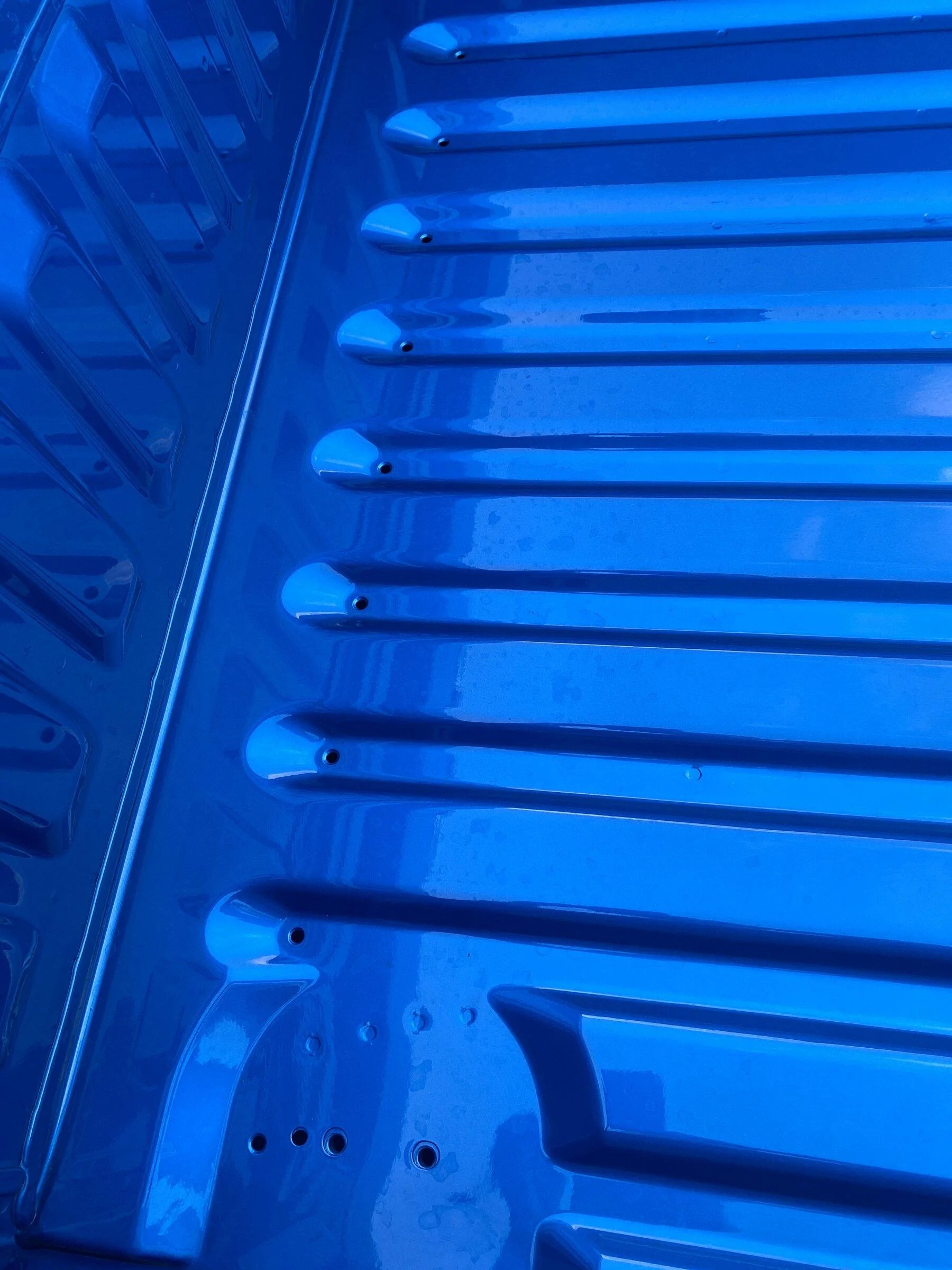

The Maverick already has drain holes? I was thinking of drilling some.
Yes, as someone said in a different thread on this same topic " where the floor meets the front wall of the bed".
Some of the ones in the image below are for the cleat tie down bolts, but most are just drain holes. If you have a drop in, those should be drilled out. Same with a spray in.
