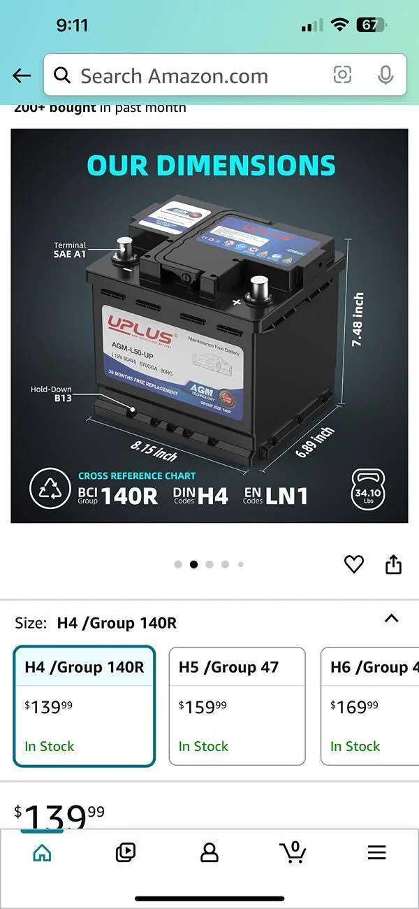

Amazon says this battery does not fit my 2023 Maverick, but I thought I read it does fit!

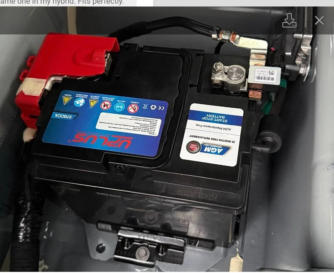

I have a 23 Lariat hybrid and this battery dropped in with no issues or modifications. So far, no battery issues even after the truck is not started or runs for days. I was able to get this battery a couple of months ago for $111 on sale from Amazon

Yes, it fits the hybrid. I have the same battery in my '24. Solves many issues!!!

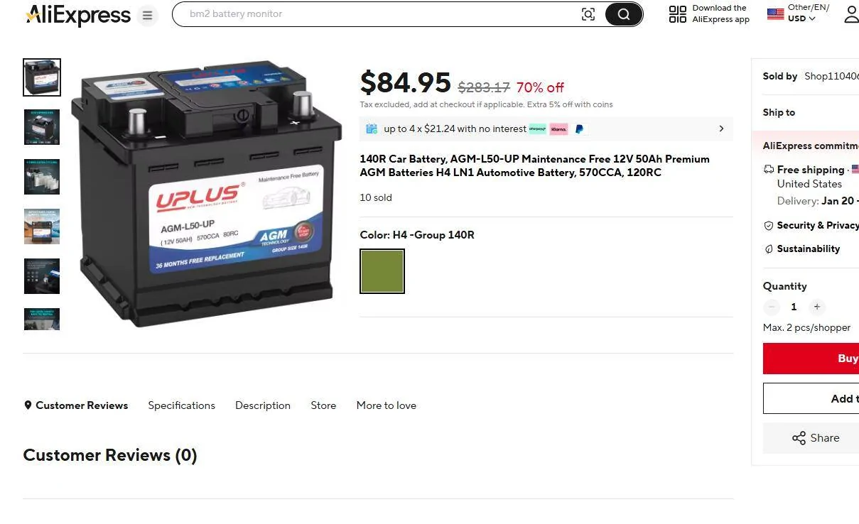

Got the exact same one Amazon is selling, of all places AliExpress $87.59 out the door and delivered in 2 days

Just to be clear we talking H4 group 140R?
Dad
Jan 9, 2022
64
5,694
6,321
SoCal
It will fit without any modifications, unlike the H5. Amazon posts it doesn't fit a Maverick because the AGM battery is not standard on any Maverick (except the 25's, so I've heard.)
