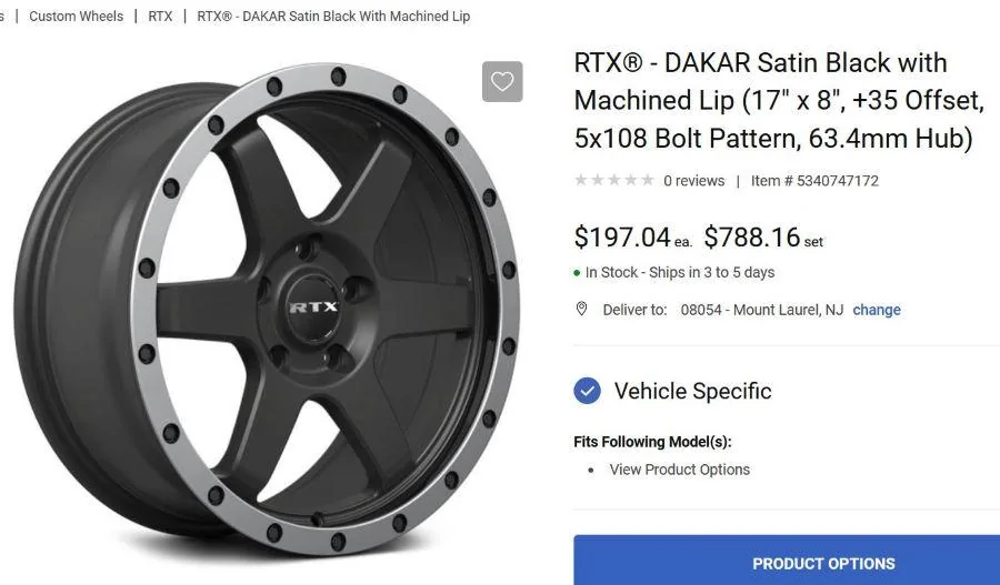

From the part # you provided, I assume these are the wheels? Just for curiousity, I would ask if the lug nut holes are sized for 12mm or 14mm (Maverick) studs.
HRG
Yup, that's the one. I'll ask about the lug sizes!
