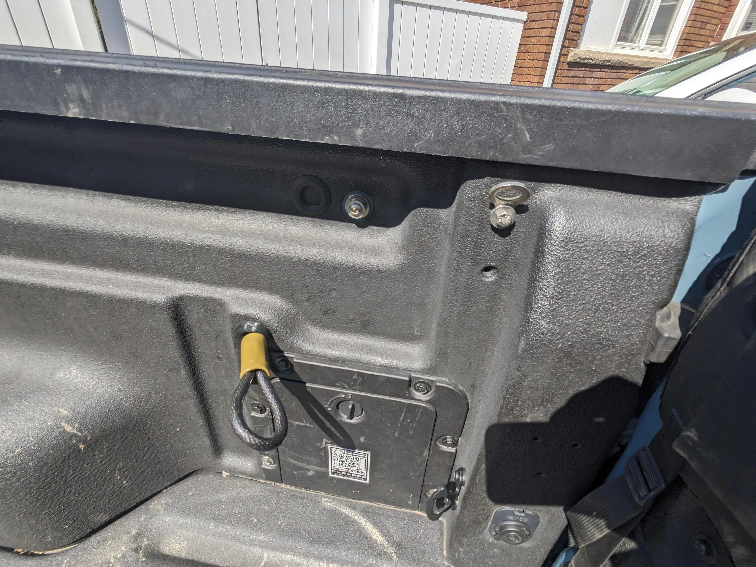

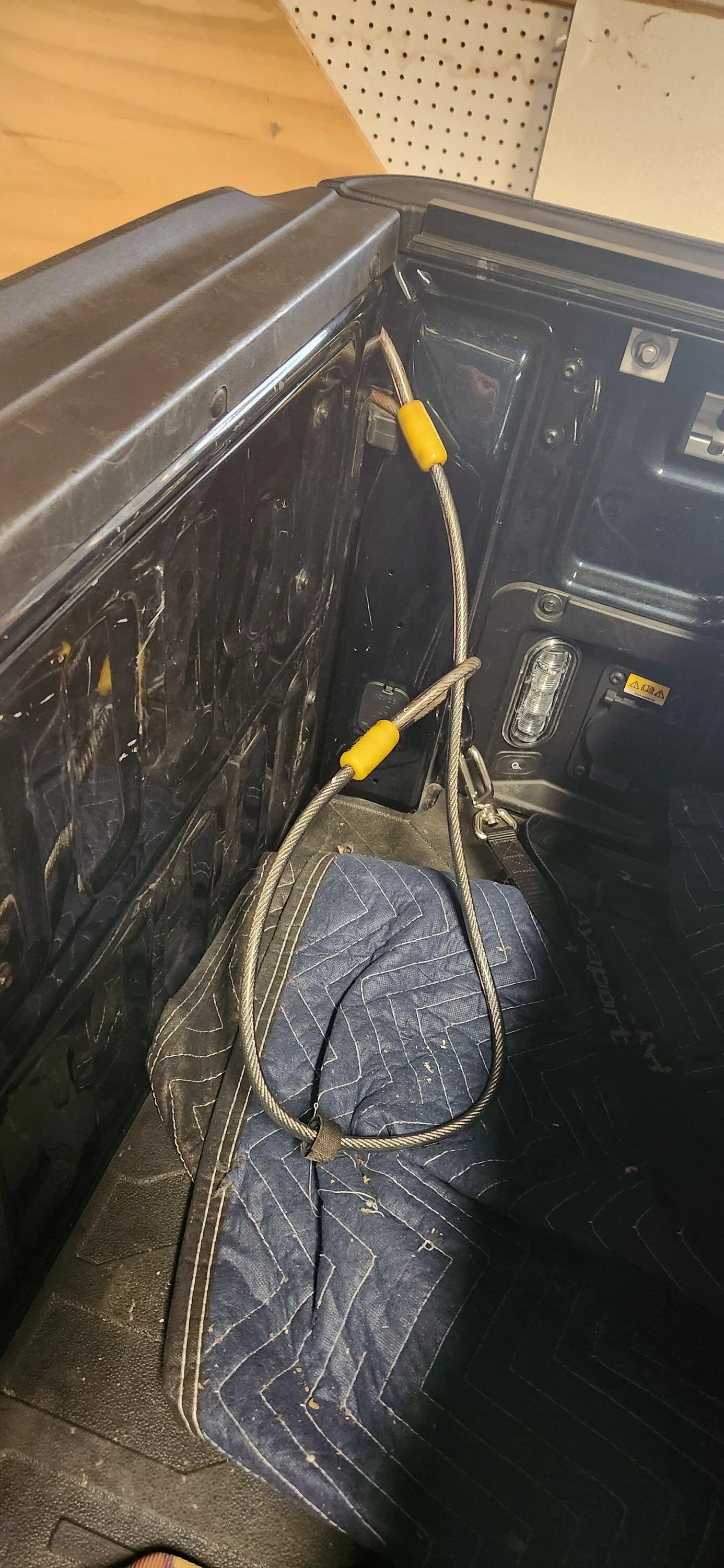

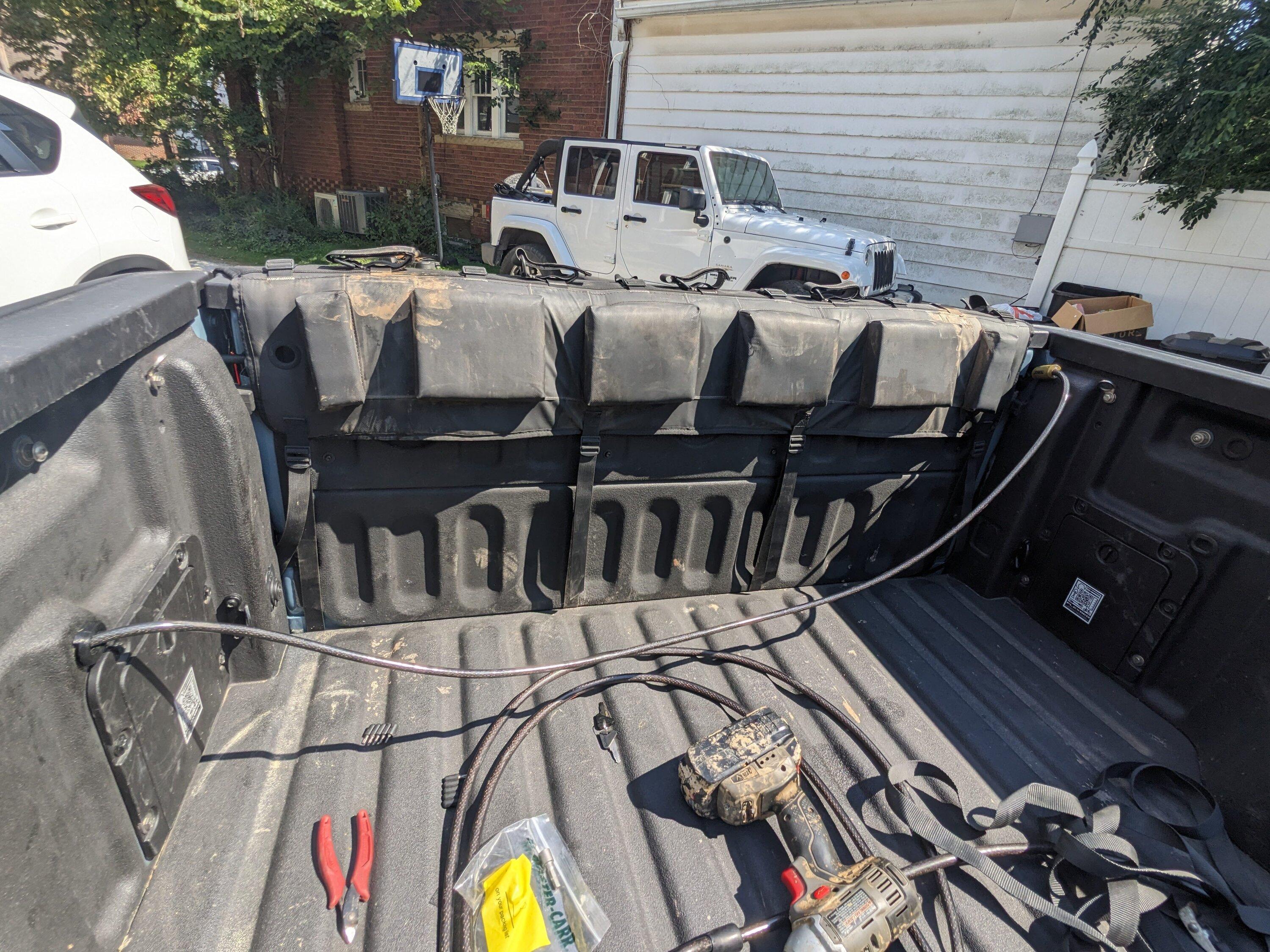

I haul mountain bikes in my Maverick a lot, and had the idea that a retractable cable lock would be a nice thing to have. No one makes a bolt in solution so I came up with this cheap solution that uses a 3d printed grommet in one of the existing holes and one of these cable locks: https://www.amazon.com/dp/B0031XXWIU?psc=1&ref=ppx_yo2ov_dt_b_product_details.
Ford Maverick DIY Retractable Cable Lock for Maverick bed PXL_20230904_191449366
Ford Maverick DIY Retractable Cable Lock for Maverick bed PXL_20230904_191504848
Ford Maverick DIY Retractable Cable Lock for Maverick bed PXL_20230904_190410084
Ford Maverick DIY Retractable Cable Lock for Maverick bed PXL_20230904_190354574
Details and 3d models on thingiverse.
If you don't have a 3d printer I'm sure you could come up with another solution for trimming out this hole.

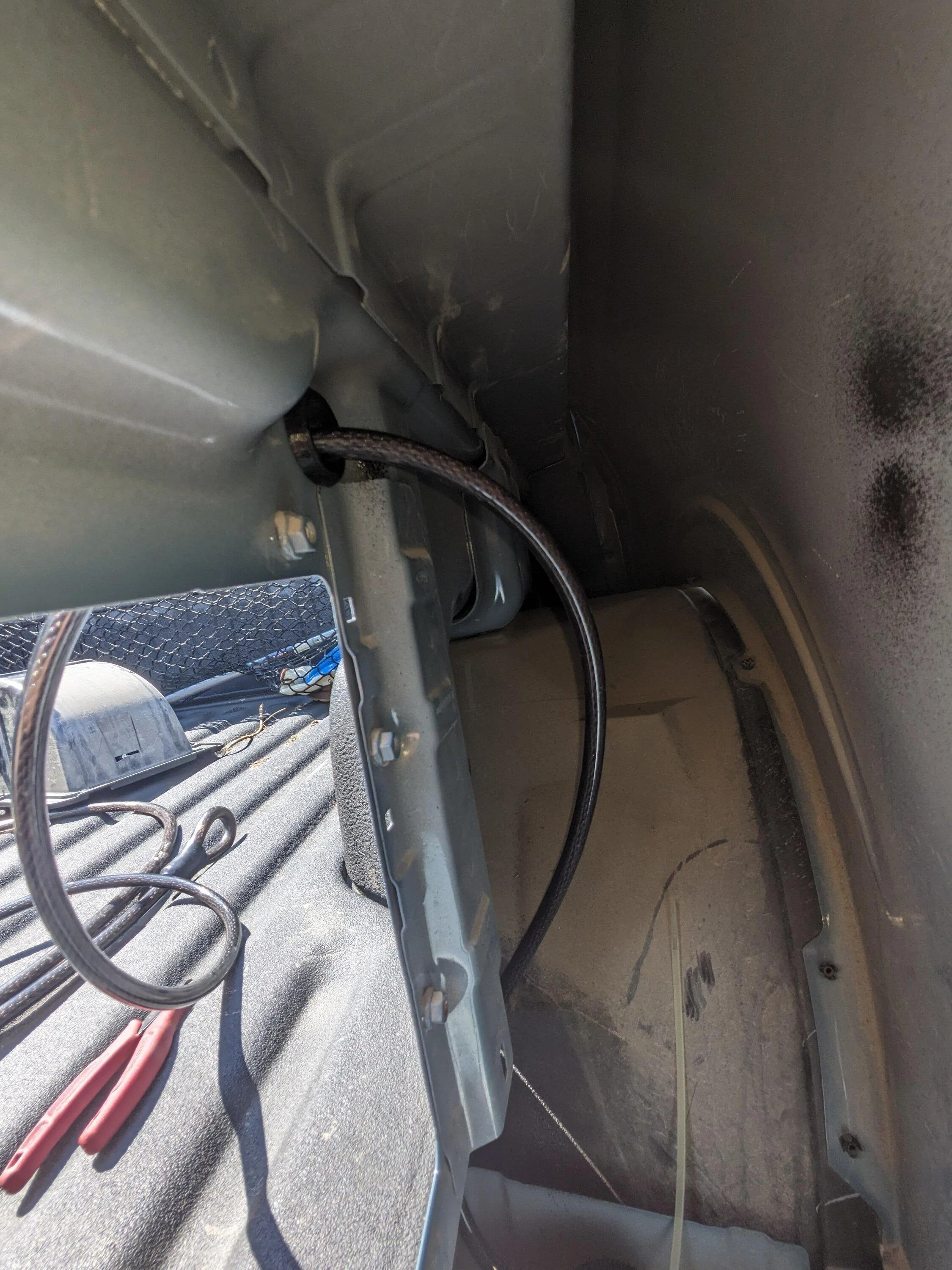

That's what's perfect about this particular lock, since it has a loop on one end which can be looped over the striker for the tailgate (if that wasn't already clear), but the other end has a crimp, that's only slightly bigger in diameter than the cable that locks into the body of the lock, which let's you thread it through the hole and then lock it in place.

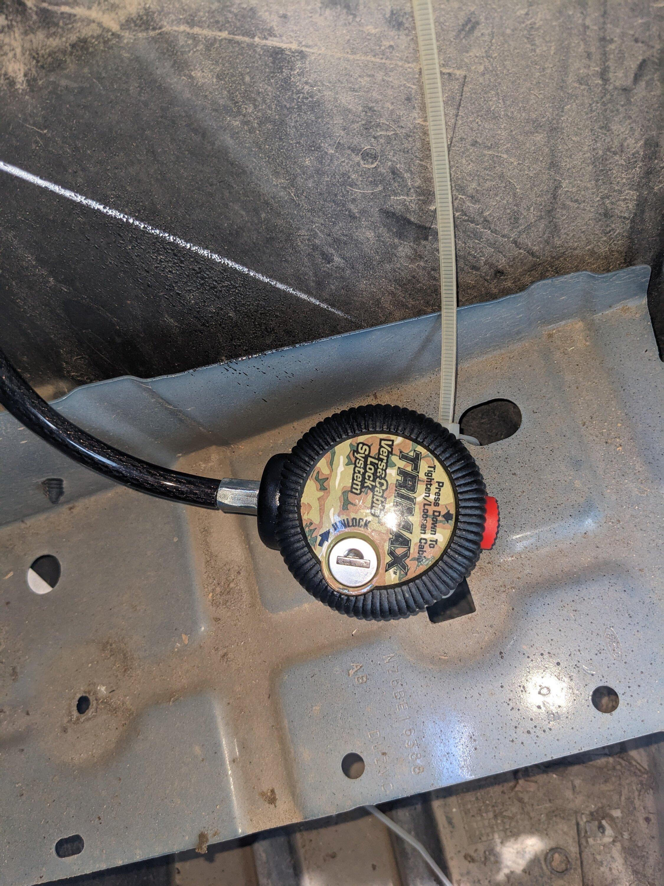

It can but I'm not actually using that function. The lock body has two places it can connect to the cable. One hole you can pass the cable through and then the actual lock that latches onto a ferrule on one end of the cable. I passed the ferrule through the hole in the bedside and then attached the lock so it can't be pulled through. I use the through-hole in the lock body to cable tie it to a bracket inside the bed so it doesn't bang around. I'll try to make a vid later to make this all clearer.

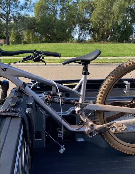

I use something more simple and a bit easier to cut, but I figured that either way they need heavy duty cutters (not the average wire cutters) to cut through it that if they really want it they get it no matter what.
