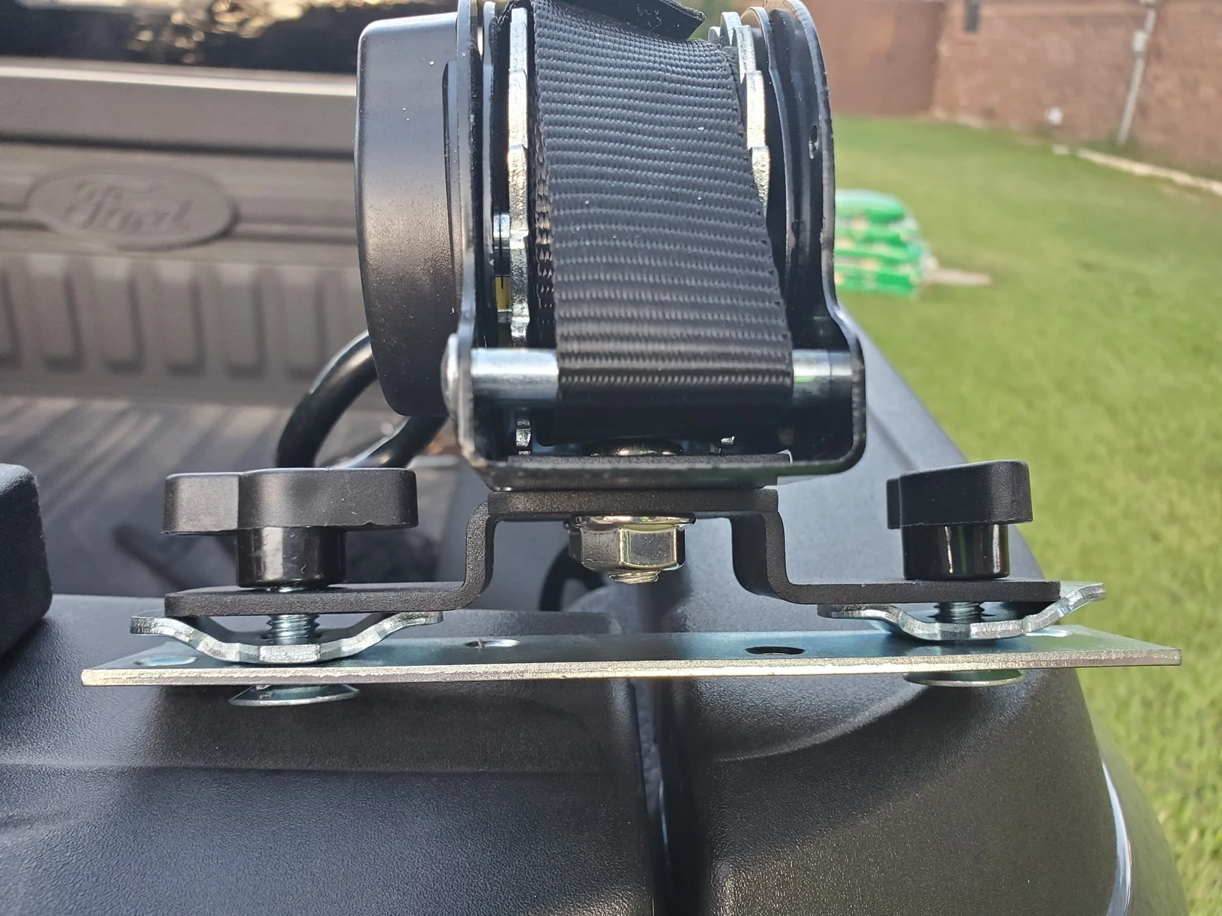

I initially crafted this beauty for my Ford rail system:
Ford Maverick Retractable Ratchet Strap for Bed Rails 20250707_195106
I purchased these: Amazon.com: Maxzina 2PCS Universal Retractable Ratchet Straps Compatible with Pickup Truck Auto Retract Securing Straps L-Track Tie Down System Trail Rail System Accessories (Only Be Used with L Track Rails) : Automotive
Then went to HD and bought two of these to place in the channel of the Ford Rails: Everbilt 6 in. Steel Zinc-Plated Mending Plate 24570 - The Home Depot
All the hardware except the plate came with the ratchets. It includes parts for an aftermarket rail system. If yours is aftermarket then you may be good to go with just the ratchets.

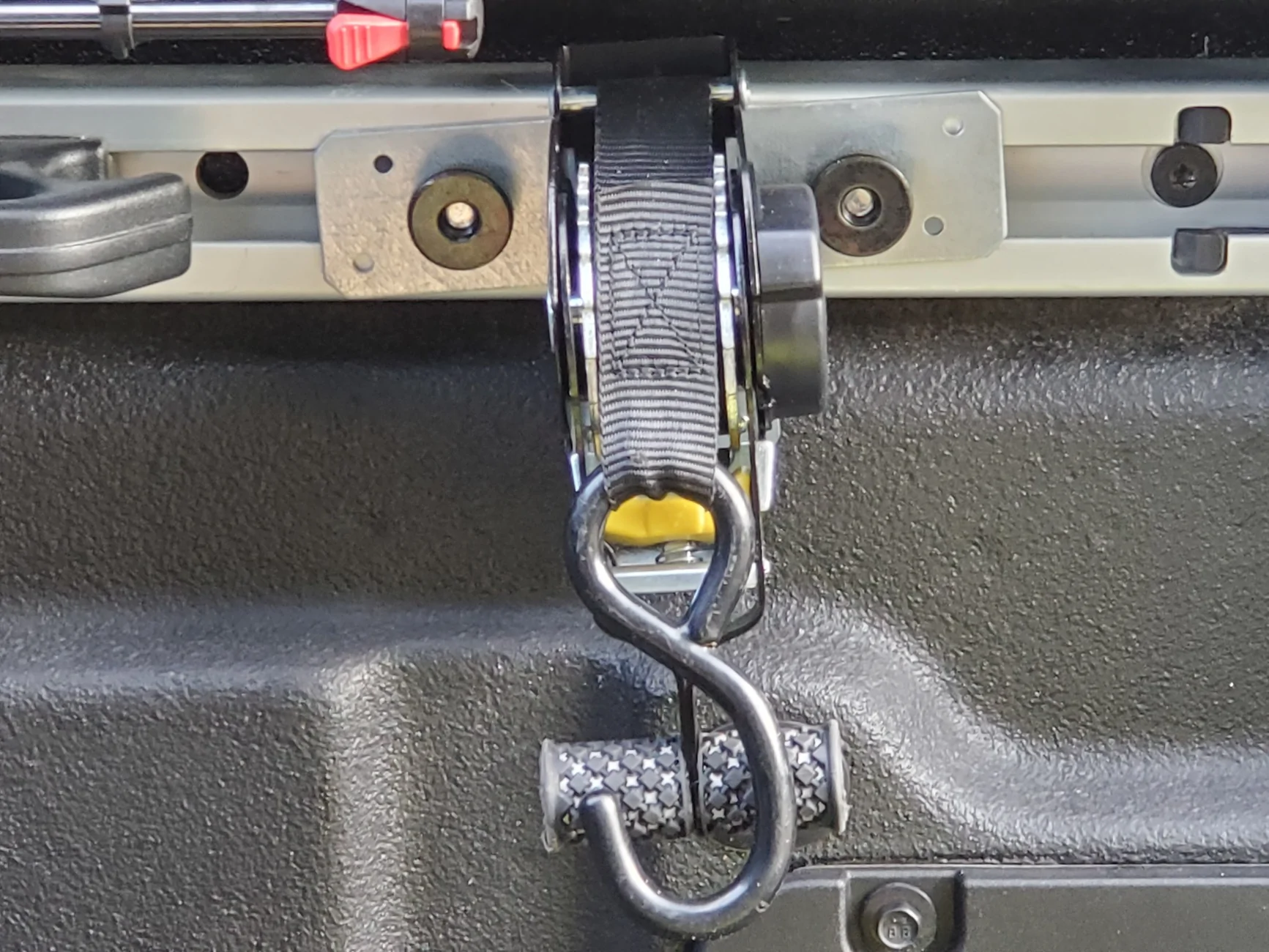

Worked great (for me anyway) but I felt that they road to high when I finally decided on my tonneau cover. The next modification required a little more Yankie engineering and an hour and a half roaming the isles of HD looking for a solution (found one, so not a waisted trip.)
Now if you are comfortable roaming HD and thinking out the box, the same ratchet straps (slight attachment differences) can be had on Temu for 1/3 the price (same EXACT mechanism). You just need to step up you engineering skills to figure the mounting out. automatic ratchet tension belt tensioner steel heavy duty - Temu

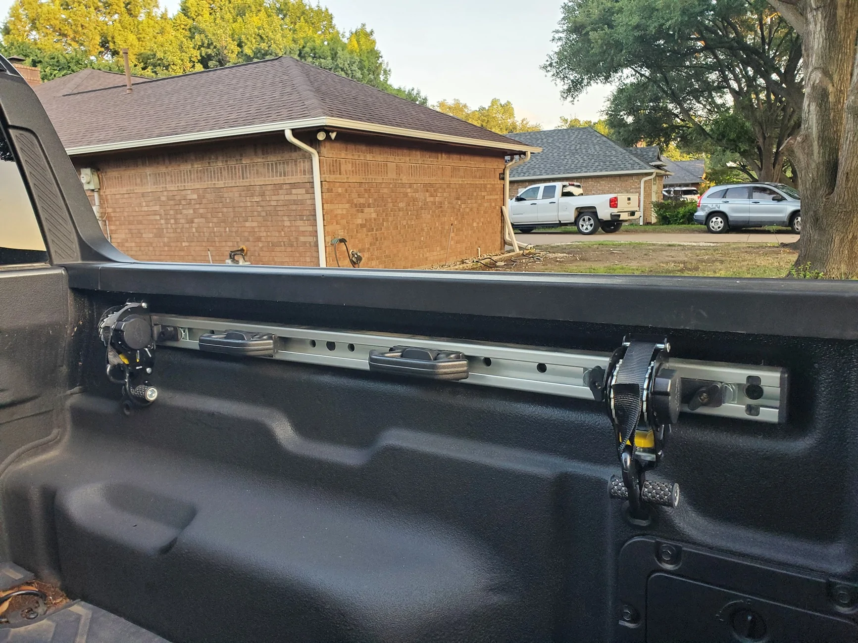

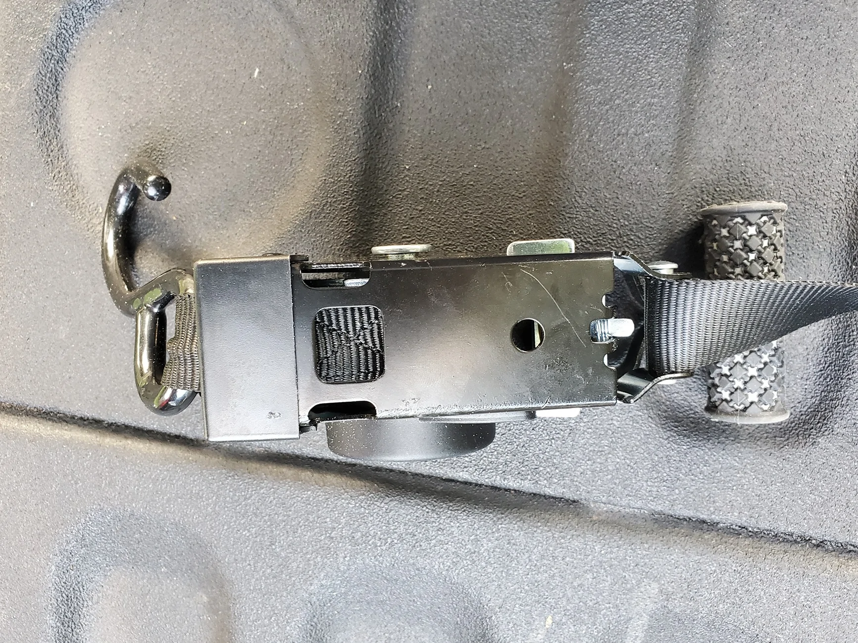

Current Setup:
Ford Maverick Retractable Ratchet Strap for Bed Rails 20250803_194550
Ford Maverick Retractable Ratchet Strap for Bed Rails 20250803_194517
Left is Temu and right is Maxzina
Ford Maverick Retractable Ratchet Strap for Bed Rails 20250803_194617
Back side of Temu ratchet strap

I should have posted this in my initial reply. This a picture of my initial setup. I felt they sat too tall and would interfere with the tonneau rails.
Ford Maverick Retractable Ratchet Strap for Bed Rails 20250707_200752
