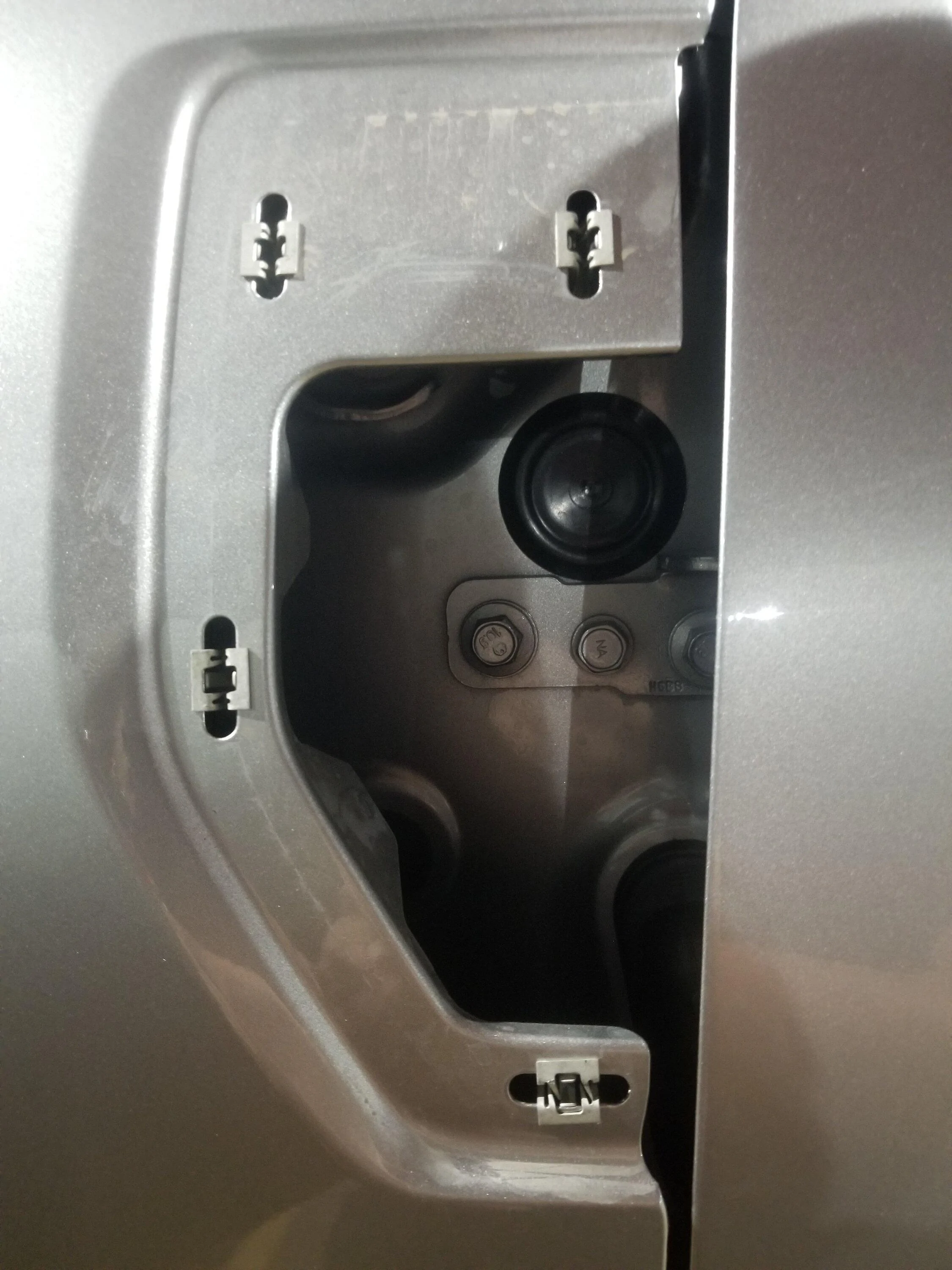

What it looks like behind the vent. I will be painting this area flat black with rattle can.
Thanks for sharing this. Knowing where and what fasteners are behind there is helpful. (y)
