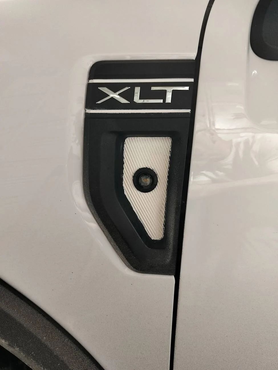

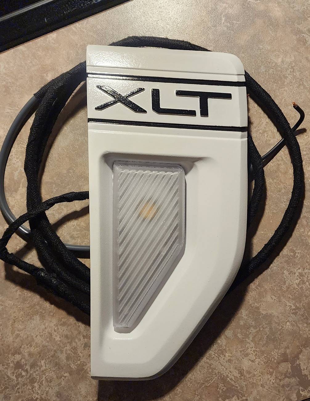

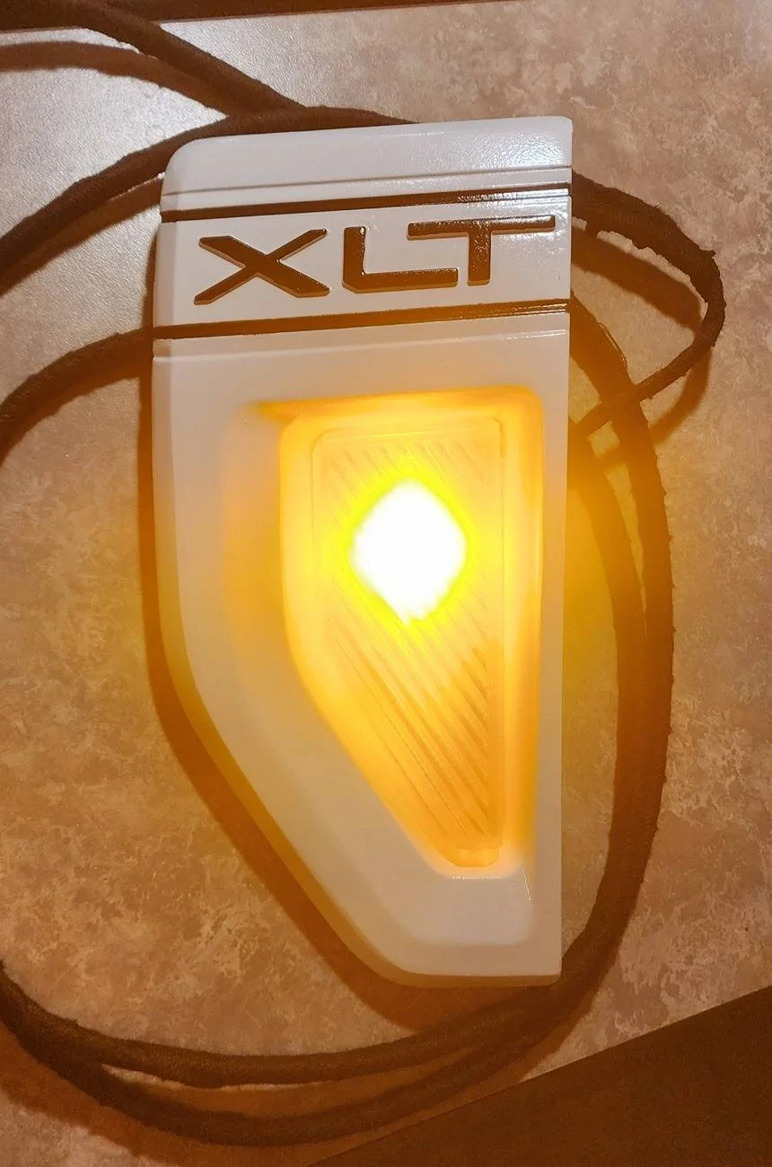

Matt, I got the leds from Superbrightleds.com here in St. Louis.
https://www.superbrightleds.com/bolt-beam-12mm-led-light-55-lumens
The wiring harness adapter from this seller.
https://customautoworksstore.com/product/2022-24-ford-maverick-side-marker-plug/
For the wiring from the harness adapter to the LEDs you can use any 2 conductor 18 gauge or lower wiring with a jacket, I also covered the wiring with cloth tape.

No the ones I have on my fender is used as just a blinker with that harness. I did not want them to be marker lights anyway shape or form.
