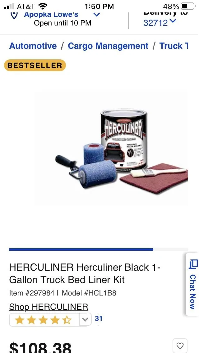

Lowes has a complete kit $108.00 by Hercules

hercules complete kit at lowes $108.00 try to find a pic on google or on MTC you may be able to leave gate on just tape it off well but pics or a local dealer may have one you can look at
Ford Maverick DIY Brush Bedliner. Should the tailgate be removed? 6273A563-D9FD-47BA-BED8-344821BA776B
