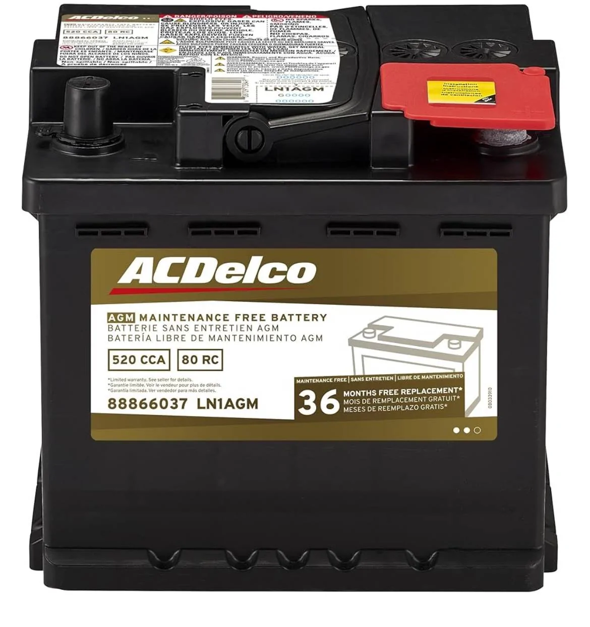

My self installed AGM will start and provide dome/courtesy lights with a 39% SOC after sitting in <10 degree northeast weather for a few days. The AGM is a champ in cold weather with deep discharge. AGM in the Hybrid is a peace of mind necessity.
What battery (make/model) did you buy, please?
Pics?
Some people who've bought an AGM battery are still having their trucks go into battery saver mode. Seems to delay the problems caused by the BMS software not keeping the 12v battery fully charged. Ford supposedly has a BMS fix coming soon.
In the mean time, one way to prevent battery saver mode for those having it, seems to be periodically connecting their truck to a battery maintainer.
