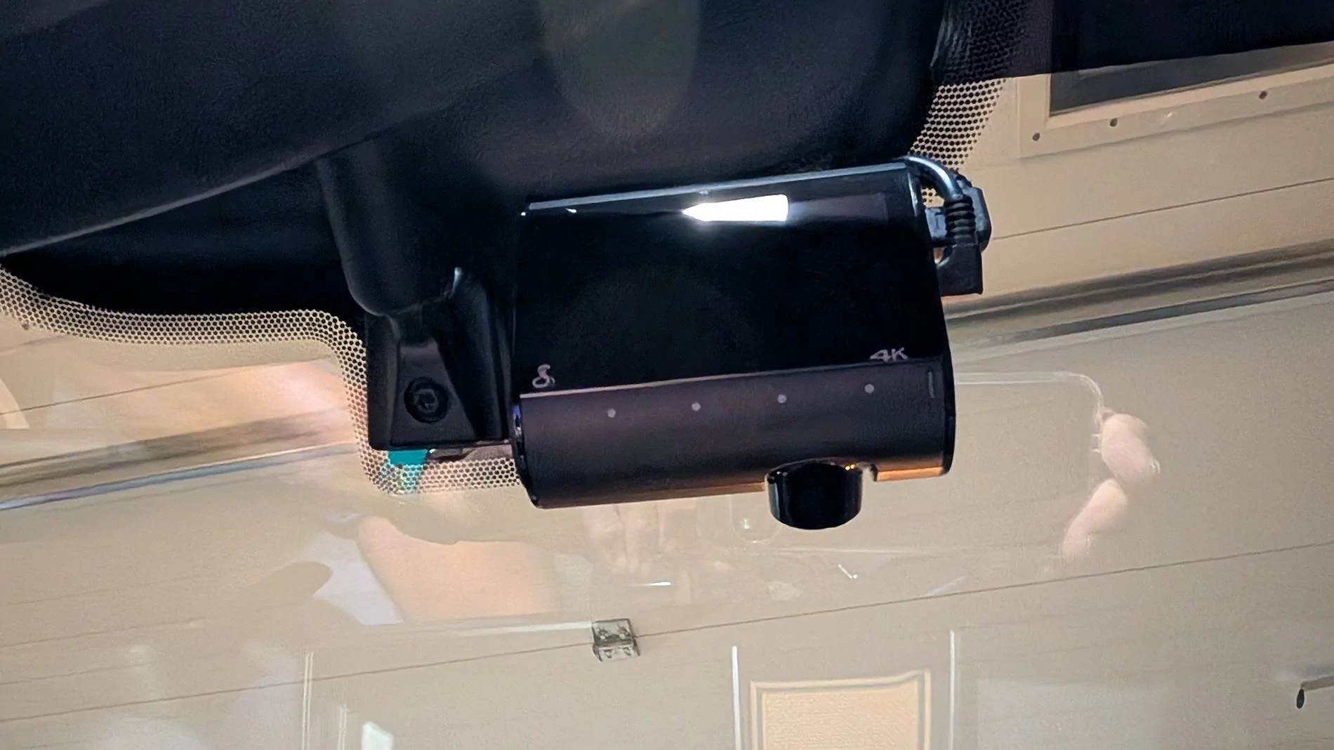

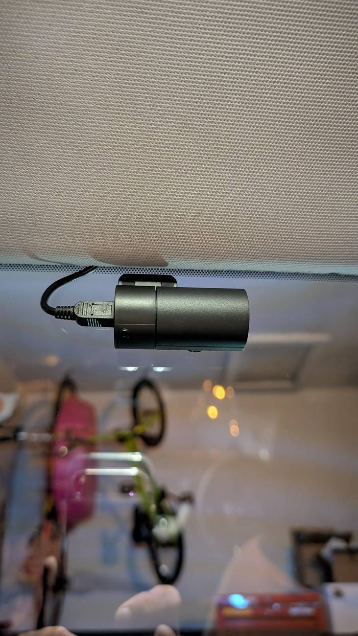

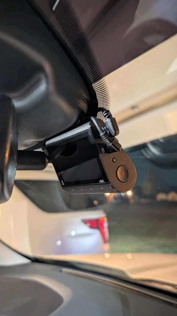

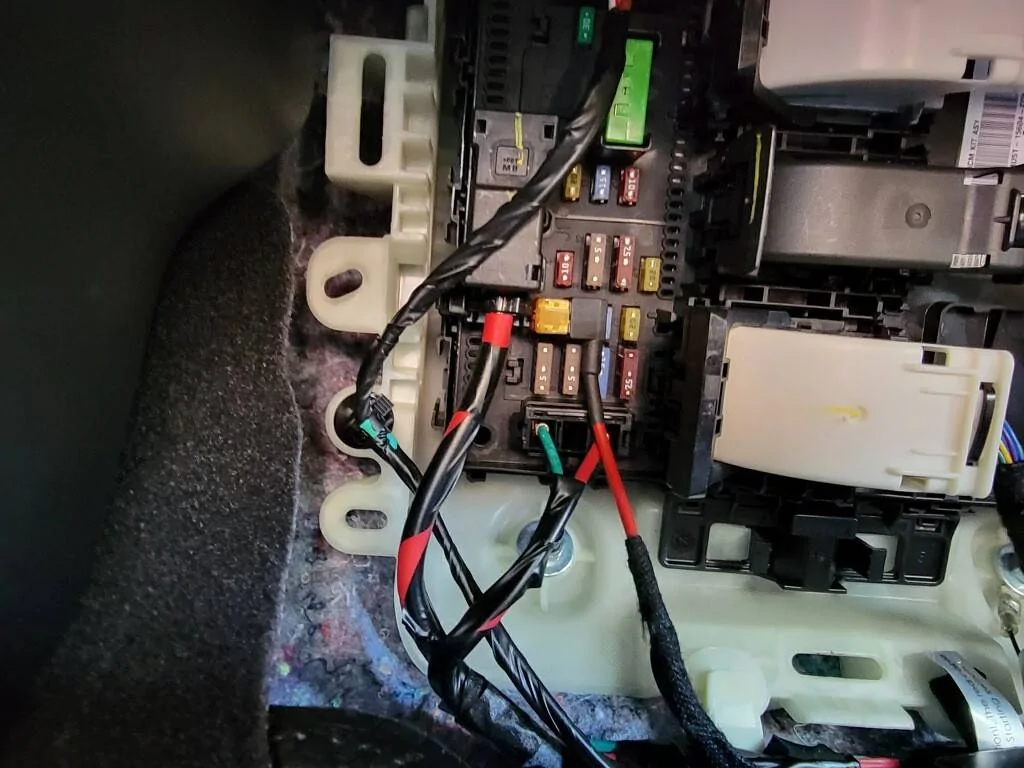

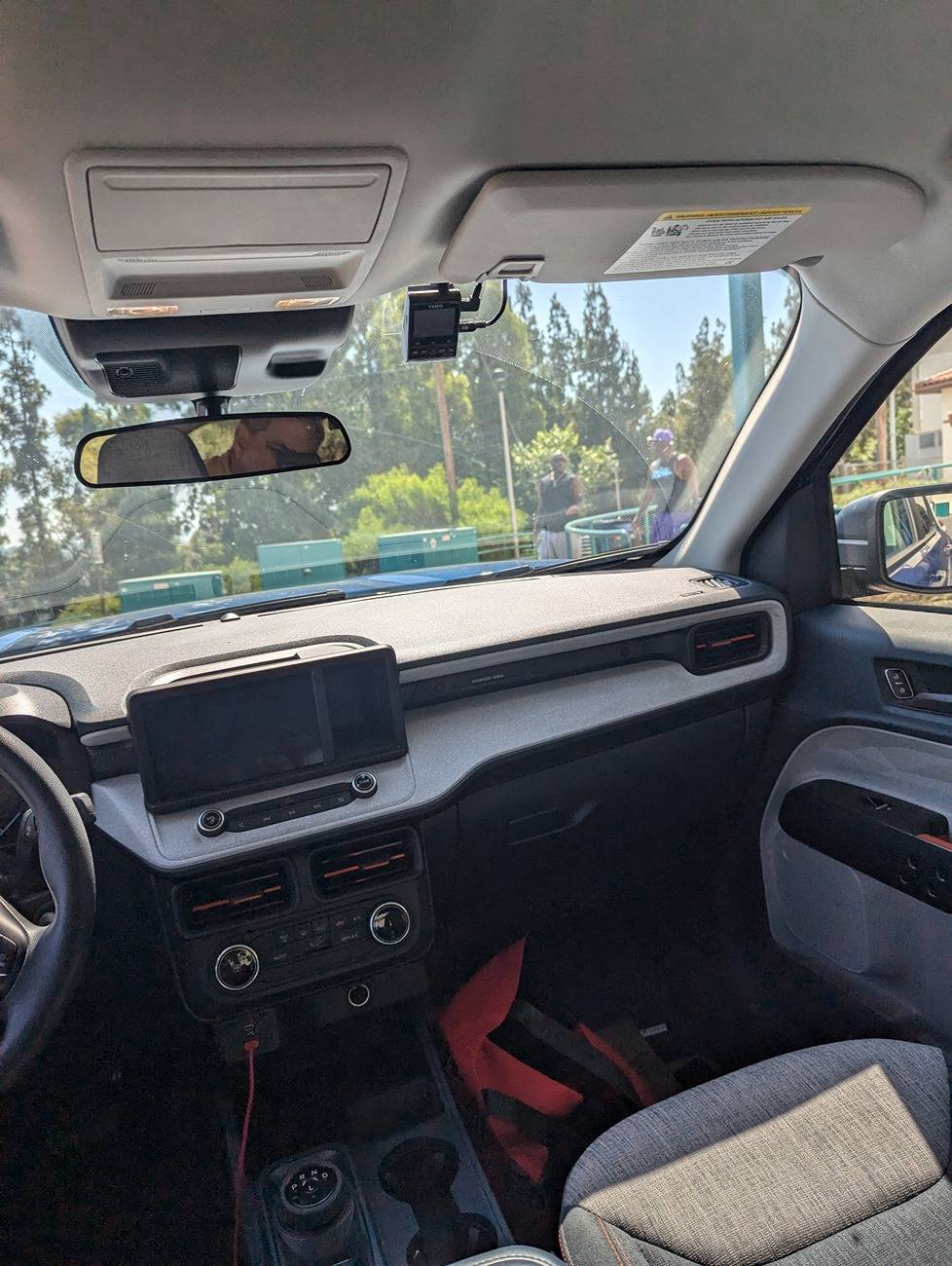

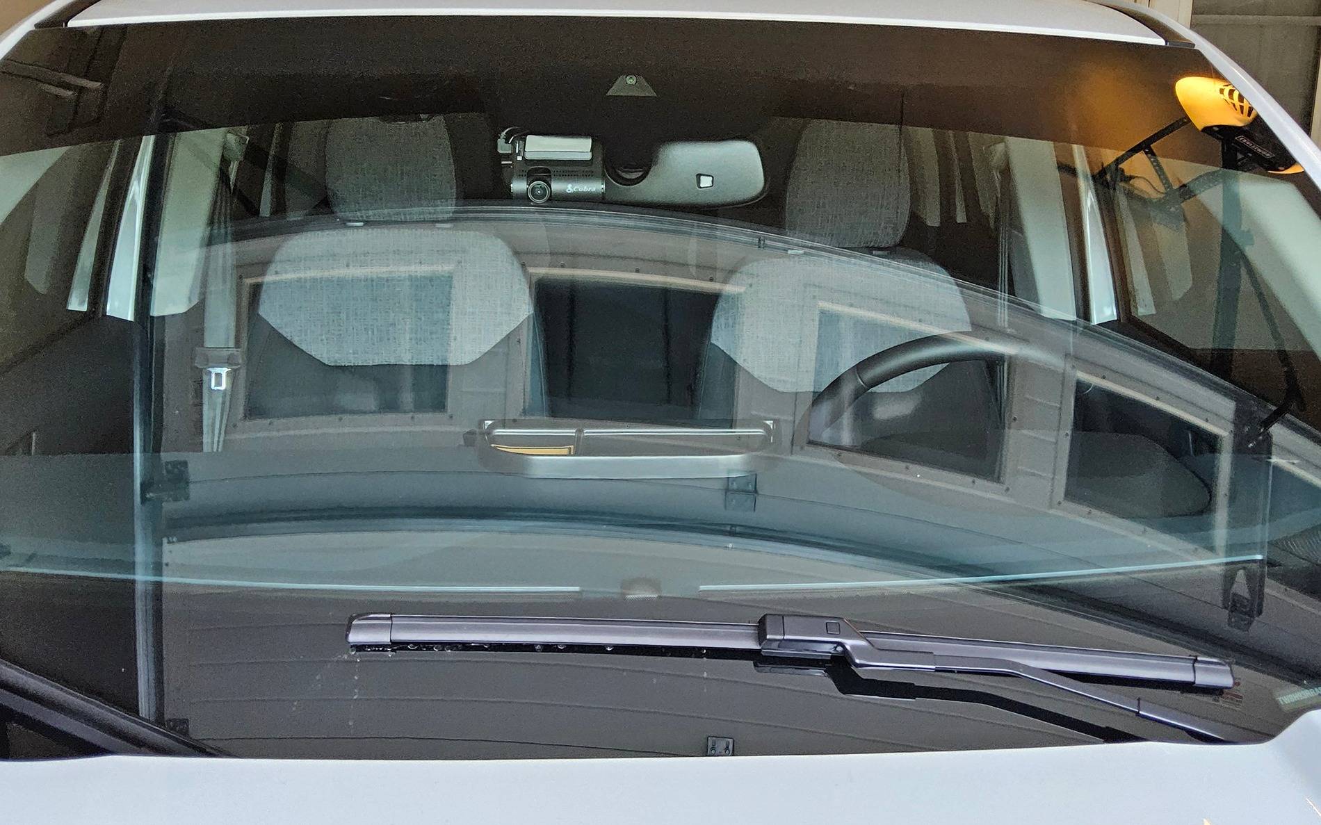

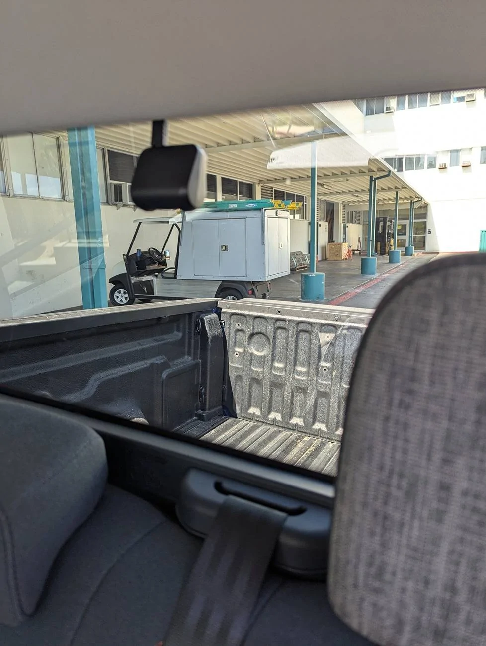

This is the Cobra SC250R front and rear 4K dash cams I installed. I hardwired them to fuse #3 which is used for the Auto Dimmung Mirror that's not used in our trucks & for the Ambient Light Sensor on the center of the dash for the Headlights.
Hard to see in the pics, but I ran the wires under the plastic cover below the overhead console. I made a small channel for the wires to exit nearest the dashcam power port for less visa le wiring showing. I'll post d\some daytimepics soon as I took these at night after I finished up the install.

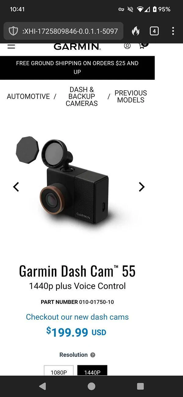

I bought a Garmin 55 dash cam in May 2017.
Over 7 years and no issues, still runs strong.
Was top of the line back then at 1440p resolution.
I have moved it from several vehicles since, buying a new magnetic mount for each vehicle.
Being in scorching hot Texas and having front windshield tint, the suction cup mounts and 3m sticky tape never held up for most devices (just falls off in the heat, or messes up the tint film).
The small, magnetic mount for Garmin has been perfect for these conditions.
If I had to buy again today, I would look for a newer device (being an older model now); but the Garmin has held up to extreme Texas weather for years.
https://www.garmin.com/en-US/p/5672...1Z8X0fp8MRxnFQ4e1cXHI-1725809846-0.0.1.1-5097

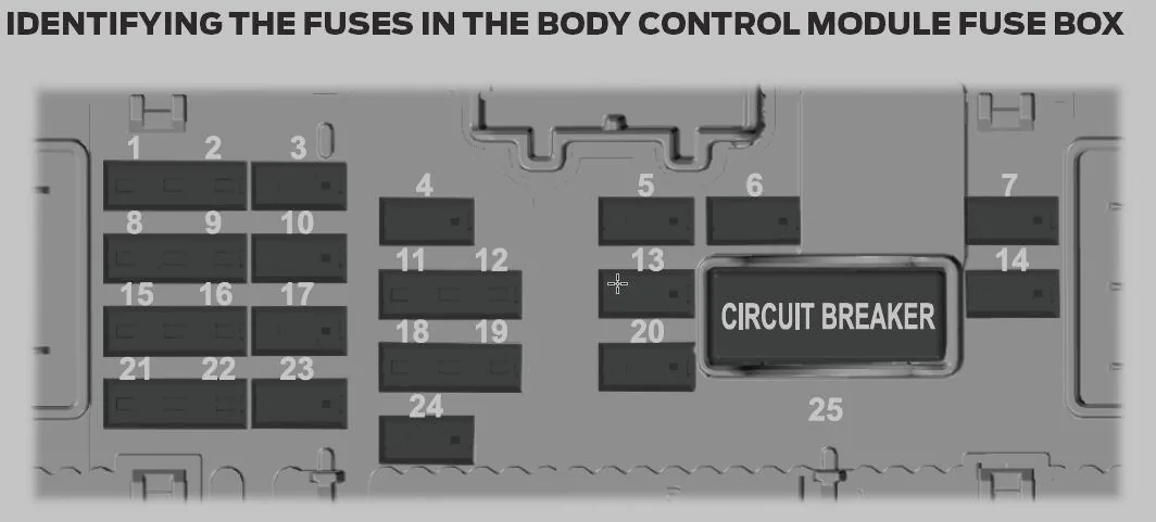

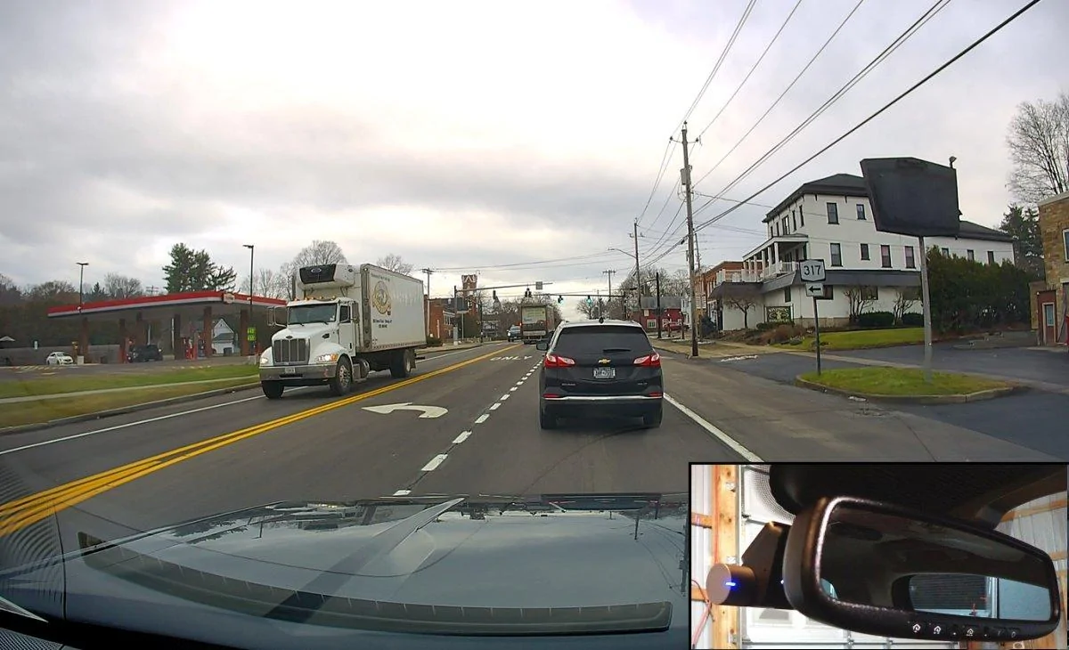

Ok. My dashcam installer (he has a business doing these types of installs among other things) originally tied into fuse 10 of the BCM (extended power module) to have it be on all the time for parking scenarios. But then I was still getting the occasional power low on the 12v battery alerts. So, we switched it to fuse 3 (auto dimming mirror) and eliminated the possibility of the dashcam being the source of sleep mode. This took away functionality for parking impacts or attempted thefts.
When I took it into the dealer for recall which required a BCM software update, they blamed the failed update on the wiring for the dashcam. It wound up bricking the BCM.

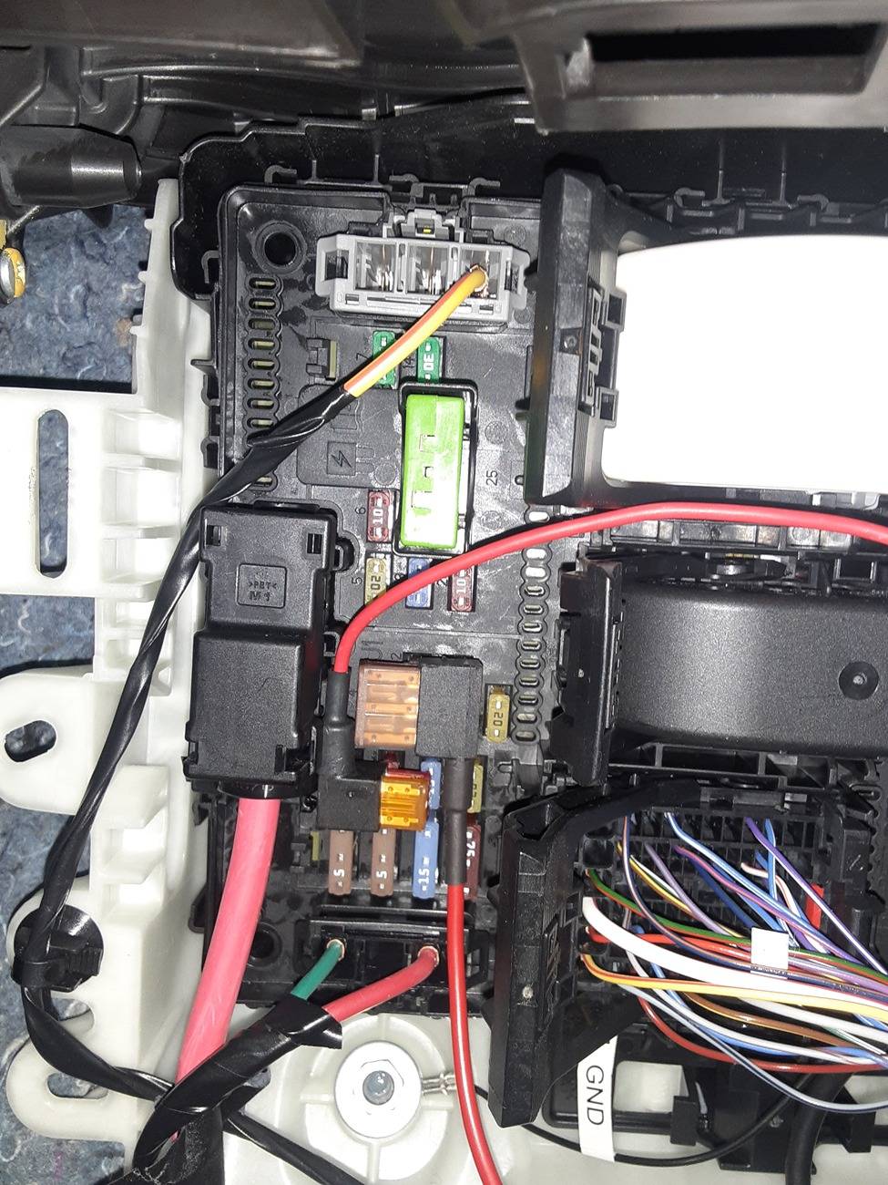

I used fuse 3 for accessory power and 18/19 for battery power. Power in on fuse 3 is on the left (towards the floor) Used Garmin Mini 2 wire adapter kit.
