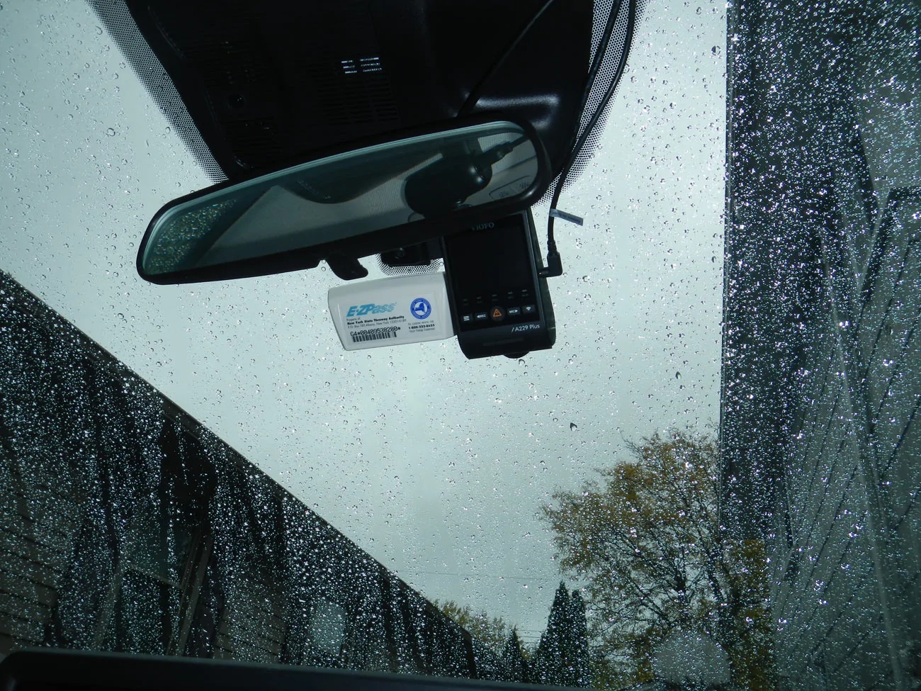

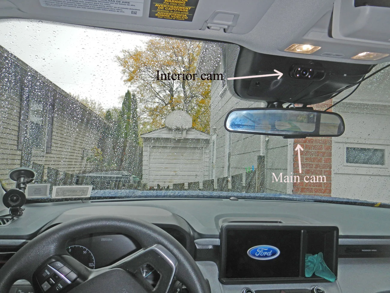

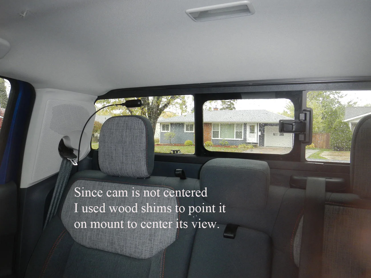

Many cams out their. I have a Viofo A229 Plus 3 channel. BUT if you really want to see best get a 4 K version. Mine is 2K version, A229 Ultra is 4 K .
I have front rear and interior. Interior for a reason most would not care about and NO not uber. . My forward cam is behind mirror you cant even see it while driving. The interior cam is not on windshield
BUT since the hybrid Mav has the whole 12 volt battery issue I have a different setup. Cam is power by a lithium battery in glove box. So when parked cam keeps running in parking lots. But at home I manually turn cam off. Battery is charged while mav is running and battery has Pass Through tech . Which is ability to be charged and used at the same time. MANY batteries cant do this even though they say they can. Trust me just replaced my battery as it was over 5 years old with new battery . Many do not really support Pass Through .
this one does https://www.amazon.com/dp/B08JGDGYJY?ref=ppx_yo2ov_dt_b_fed_asin_title&th=1
But only on one of two out ports.
