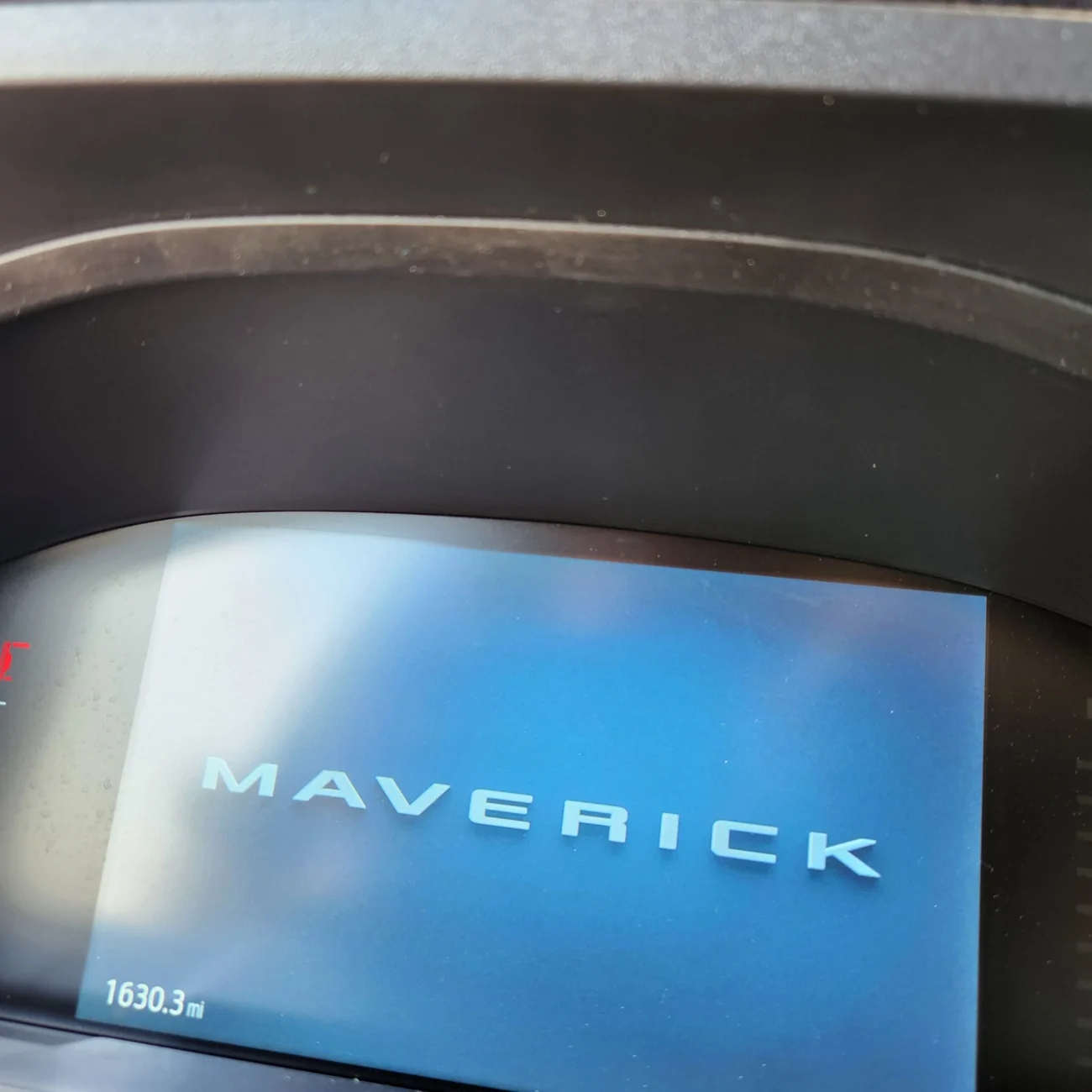

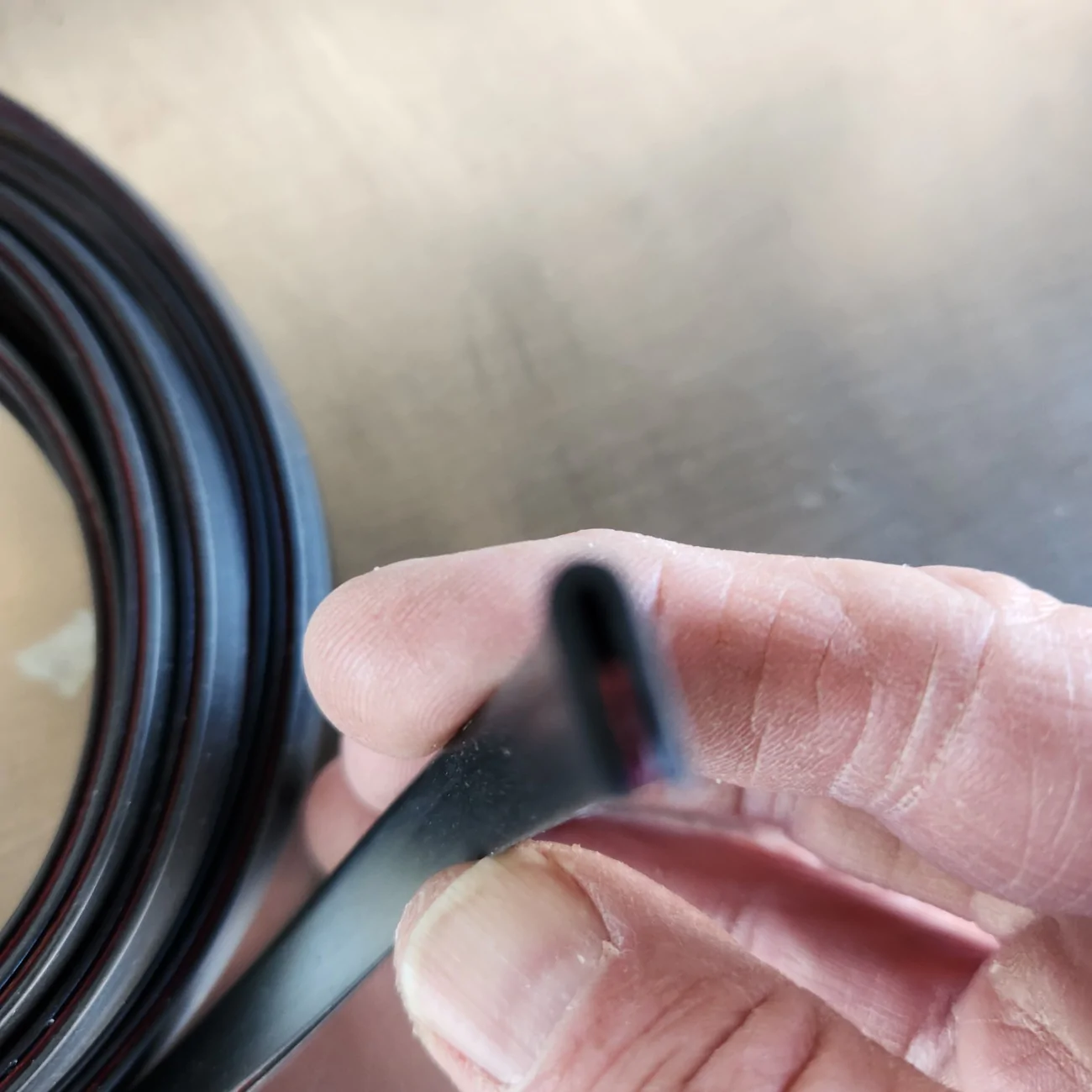

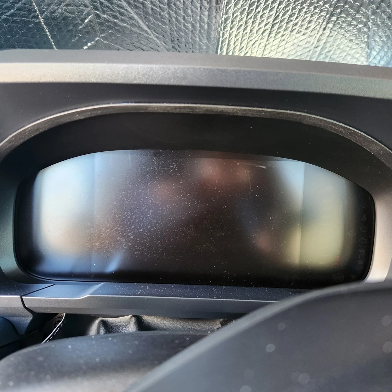

I just picked up a 2025 new Lariat. It has a dash rattle but it was easy to find by touching above the speedometer/production window and it stopped (where two plastics meet but barely touch). I bought some trim rubber and put it across the entire top to correct the rattle and it really looks clise to a factory install in my opinion. But I didn't see the dust til these photos so I better get busy.

Where did you install this?

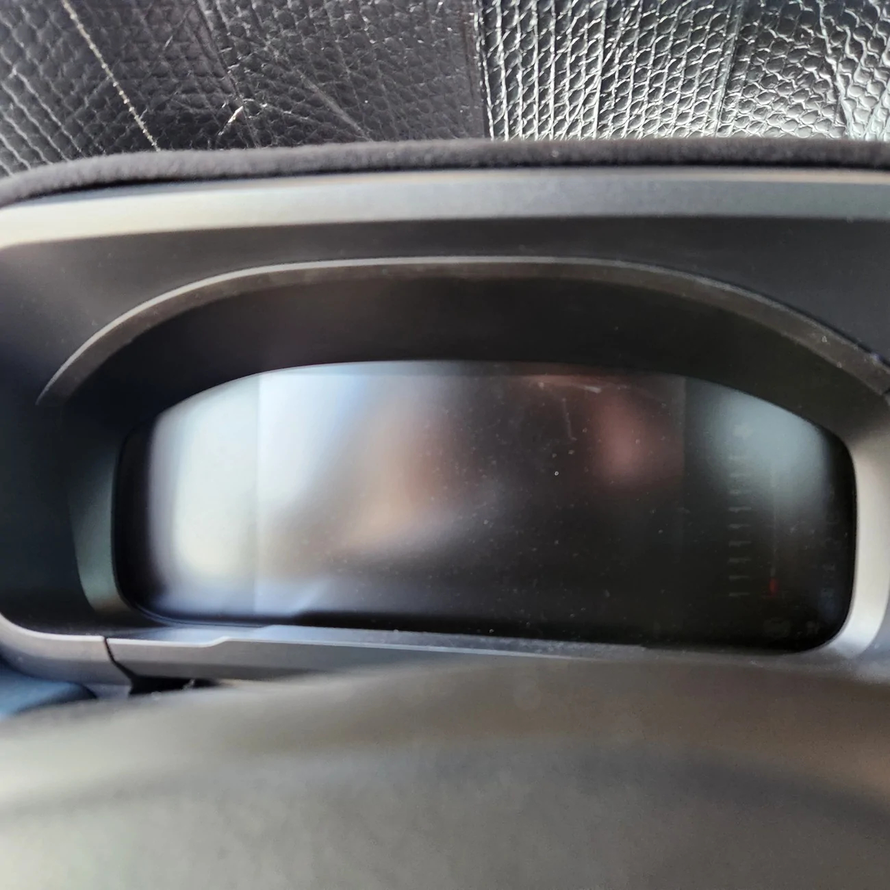

Sorry for the delay. I had a rattle coming from the top of the instrument screen...when I touched it at the top it stopped. It is where two plastics come together. I put this trim on facing towards me...it slides on. Just don't pull the red tape til it is positioned (start the tape so you can have enough to tug on. It worked for me but your mileage may vary. It kind of looks like it belongs there (sort of) . Pics attached
